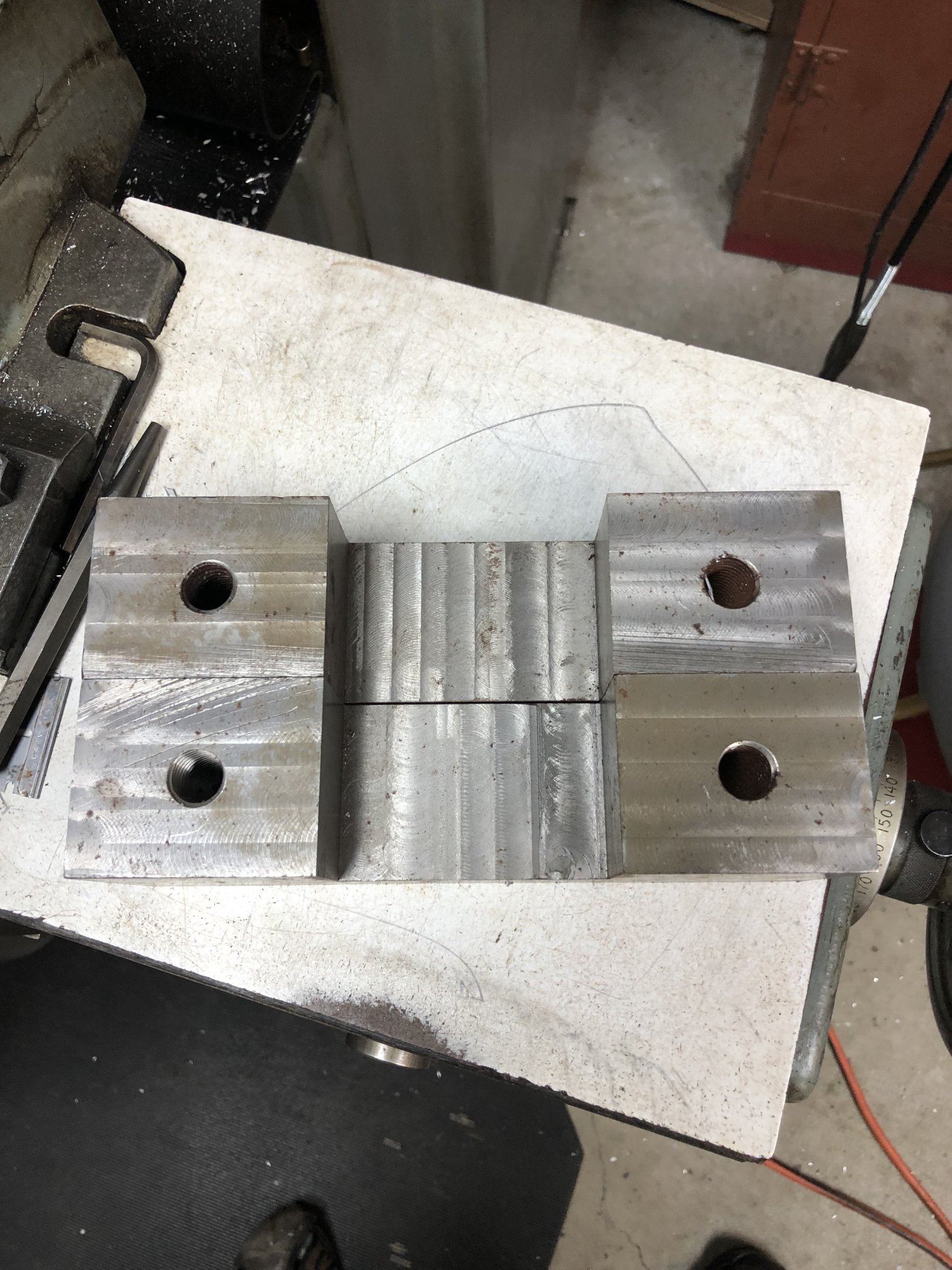

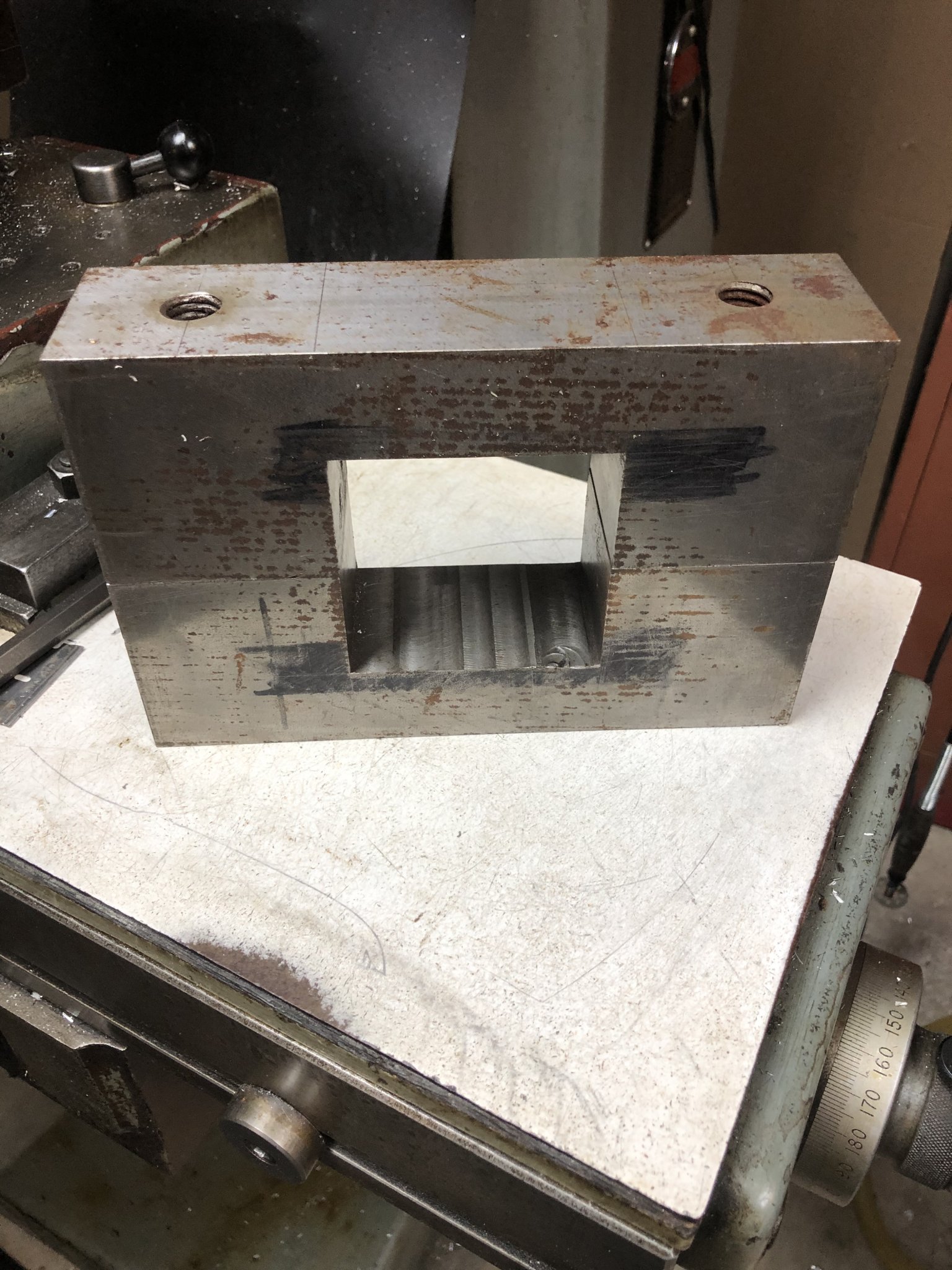

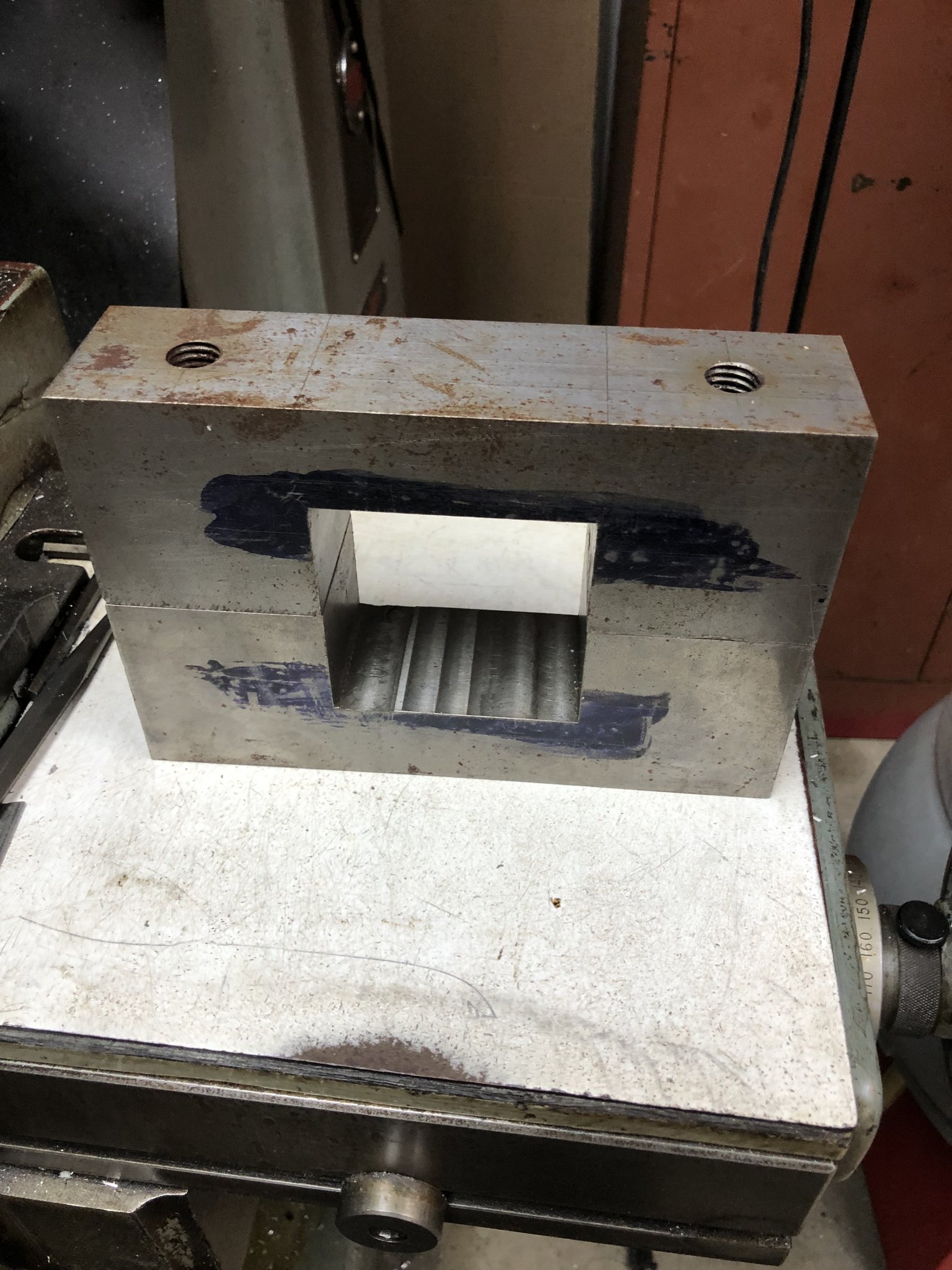

    @redneckbmxer24
    This might work for you?
    3” square inside, holes are threaded, just add wood or aluminum inserts for your diameter.
    Not built as a barrel vise, but I always thought it would work as one🤷‍♂️
    545CFF4C-FCC8-42A2-A2FF-507638C0F157.jpegDFF7A958-DE8B-4591-B693-AF16F5975D80.jpeg262CCF53-A660-4E32-8FE3-4BCD9BEA57A8.jpeg
