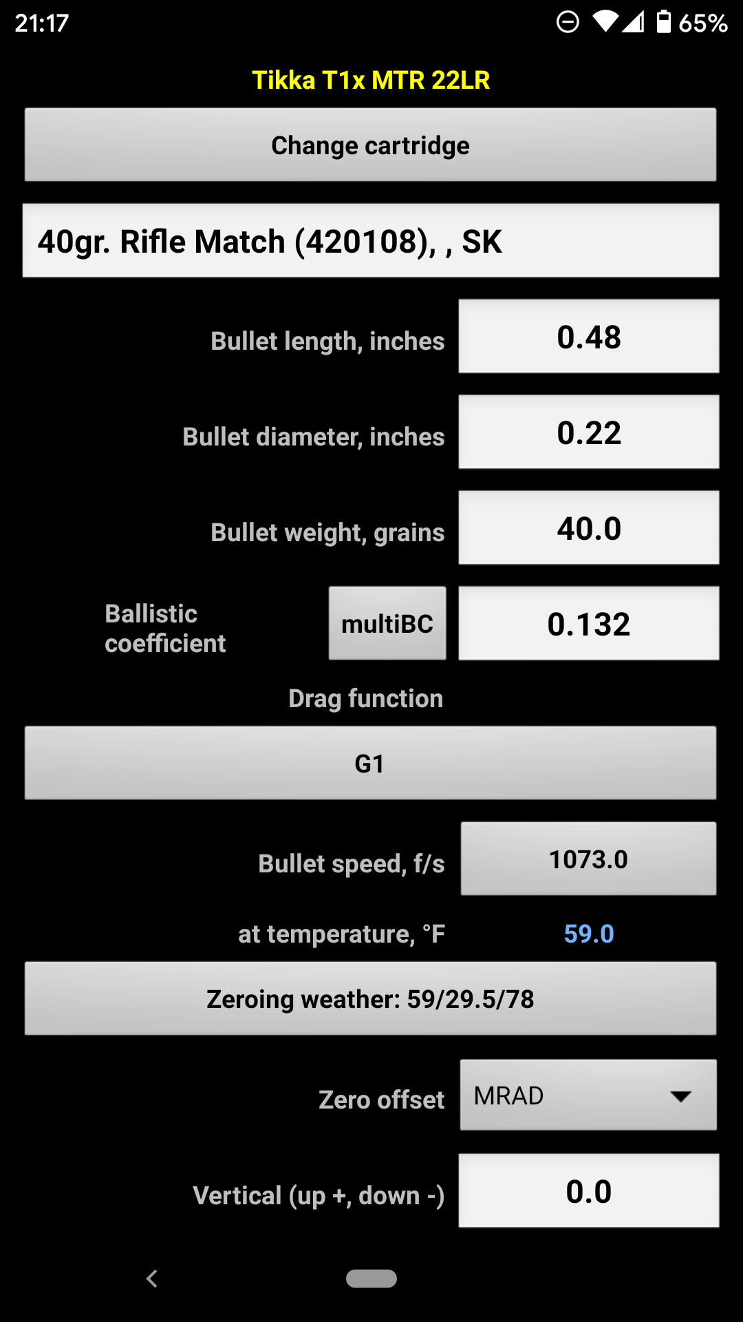

This is what strelok pro has for SK Rifle Match in it's database:

so the big problem was i was using a G-7 BC...using the numbers below...
MV at 1073
G-1 bc .114
BL .480 puts my kestel numbers within .1mil out to 330yds...ill true everything up when i get out again...thanks everyone.

RA4 works better for me - at least out to 200m. Just remember that the BC changes from the G1 BC. With my current block of Eley Match i use an RA4 BC of 0.112. This ties very well with my measured velocities and and DOPE. The G1 BC would be around 0.14.
Remember that BC isn't a constant :-( from batch to batch of the same round type it can vary - say 0.125 to 0.16 (G1).
