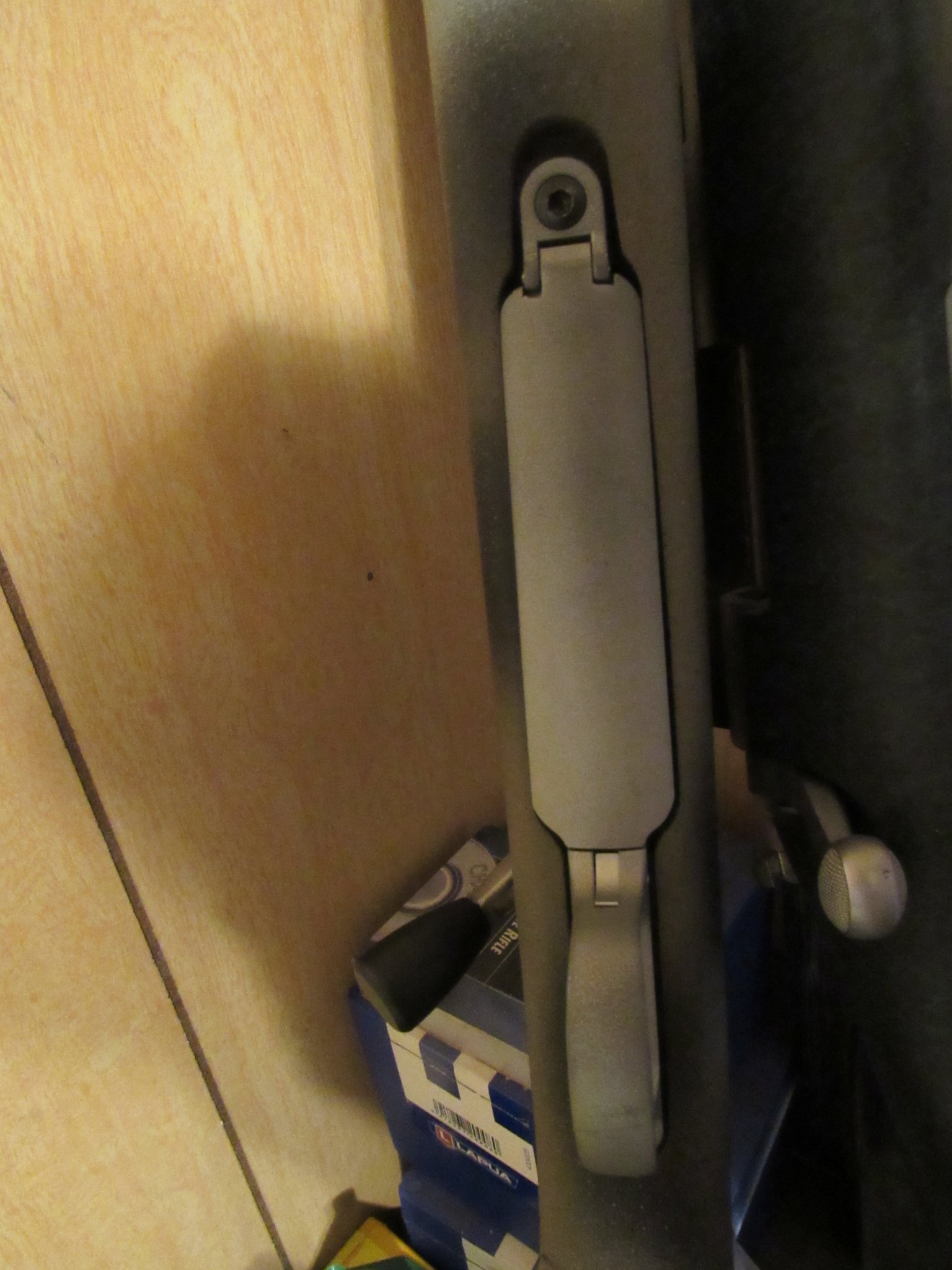

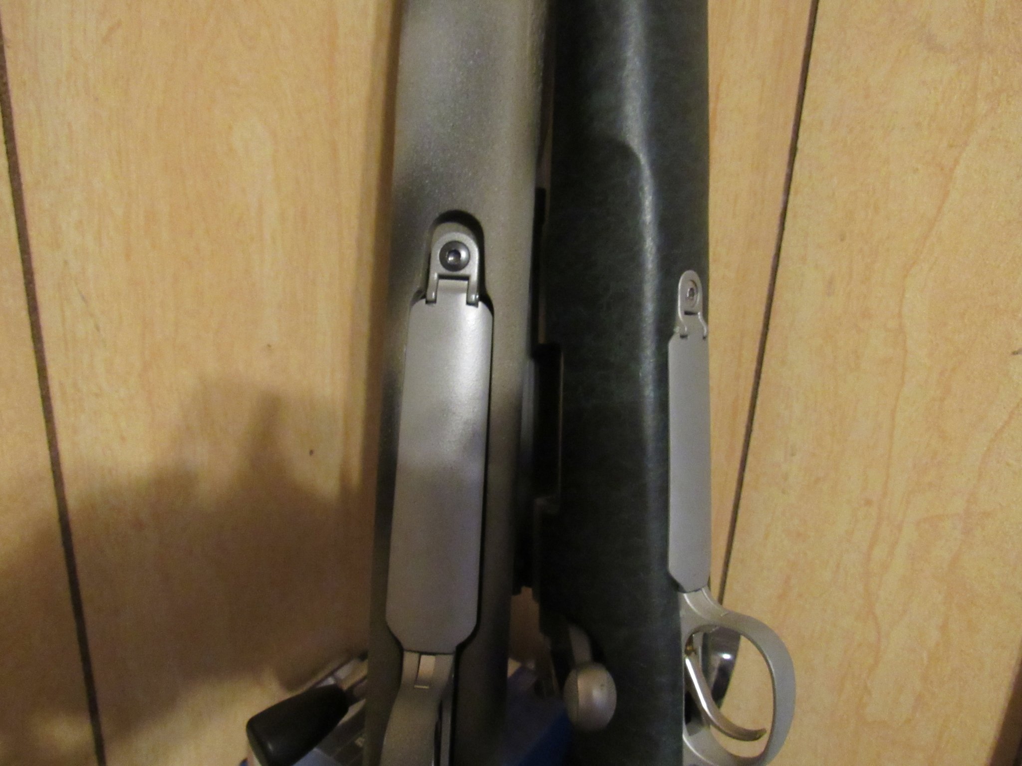

Should be able to find an AICS pattern single stack 5 rnd mag that'll work out real slick. They normally have 3 long action COAL lengths to choose from 3.715 up to 3.850 (if memory serves right.
Do they make one for the Ultramag sized case.... I see they 300 win.... but not the Untramag... or is it just bending and tuning the feed lips like on a Wyatts box???? The 28 used same feed rails as the Ultramag.... Thanks for any help... Dave
Thank you for your help... I called AIC and he gave me the rundown....They like to use the 338 Lapua Steel mags for the 28 Nosler ... said with just a small amount of tweaking they feed great... Again thanks for taking the time to help me... Dave
