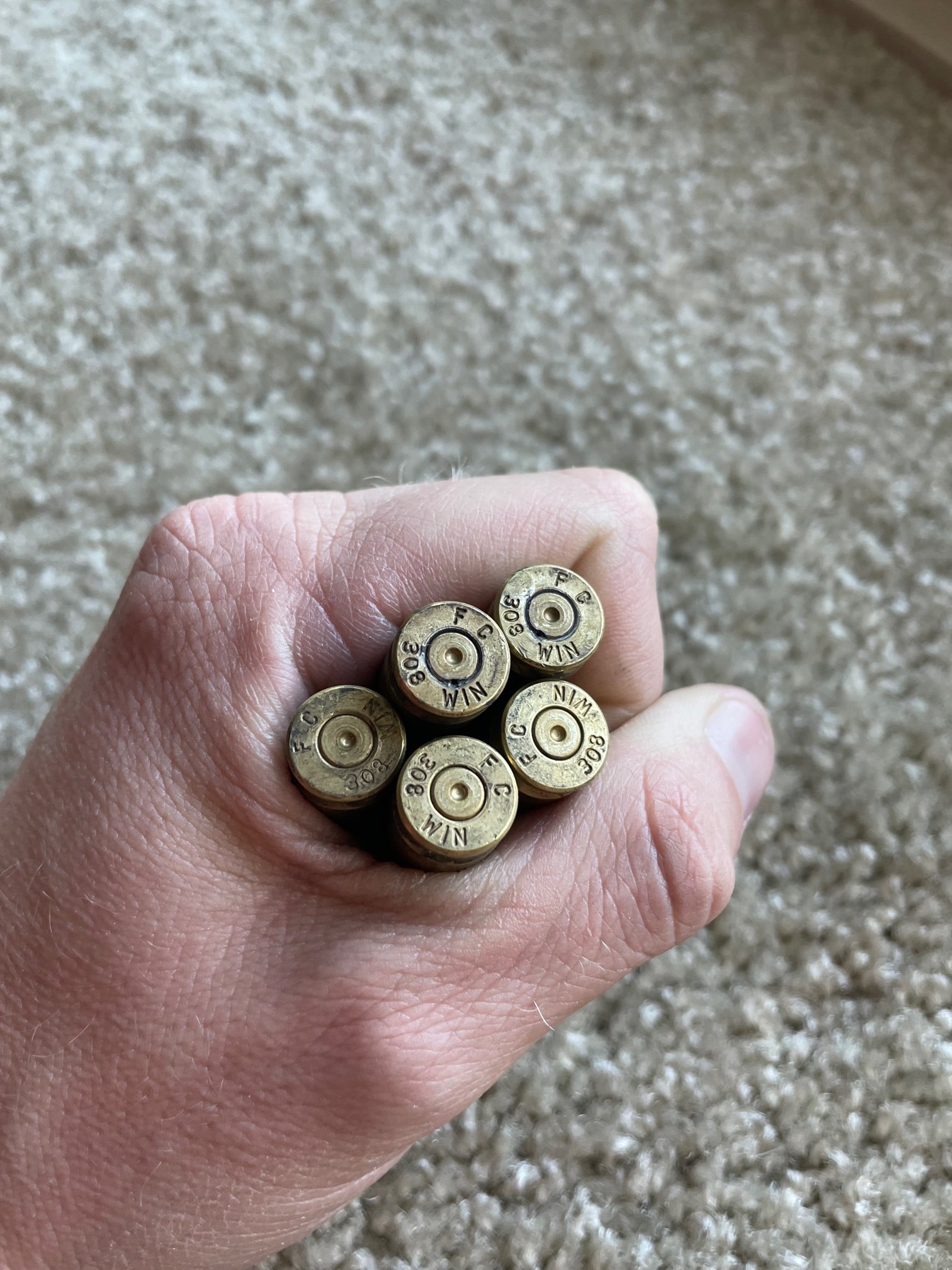

Last night I fired 5 handloaded rounds through my 20" 308 AR. FC brass, 175 smk bullet, 41.5 IMR4064, the 5 rounds average 2570 fps which is in the ballpark of normal for a 20" I believe.
However, I had 2 of the WLR primers piece at the edge..... see the 2 primers at the top of the pic in my hand. I don't believe I'm seeing any other pressure signs on the case head. The bummer is these pierced primers apparently stuck my ejector down, and cut little divots into my bolt face.
What would cause a primer to pierce at the edge like this? Is this bolt still safe to use once I get the ejector functioning again?

did you make sure the case was completely dry before putting the primer in ? it only takes the tiniest bit of moisture in the case to keep a primer from going off or to make the surrounding powder wet enough to prevent the primers tiny spark from igniting the now wet powder if you take them apart check to see if there is powder if the primer went off that powder can be reused if there is any to reuse the primer unless it was defective is probably spent .
I like fc brass the best. I primarily use wlr primers. I've never had this issue. I load my brass up to 10 times annealing every 3 third resize. Do you clean your primer pockets good? How many loadings on the brass?
Your load doesn't seem exceptionally hot to me..... maybe warm but
This is the classic Winchester primer failure. If you remove the primer, you’ll see that it’s cracked along the side of the cup, and gas leaked through the crack.
They crack because they’re too hard; I suspect Winchester skipped an annealing step to save cost, but don’t have proof other than the failures. It seems to be specific to the large primers, both rifle and pistol. It’ll happen with mild loads too, even 35-40Ksi stuff like 30/30, in case you’re tempted to save them.
Back when it was common you could call Winchester and they’d reimburse you for them. It took some phone time to get it done, but I had a whole case swapped out. No idea what they’re doing about it now.
Reactions: McCrazy
Winchester white box primers that were made pre-2001-ish were nickle or chromed didn't have this issue. It only surfaced when they began selling brass colored primers.
Correct on the nickel primers.
It didn’t start when they switched to brass colored primers though; they had 6-7 years of good primers at first. It was right around the first Obama term and subsequent rush on ammo and components when Winchester messed up their primers. (Part of the reason I suspect they took a shortcut, to get more components out for the rush.)

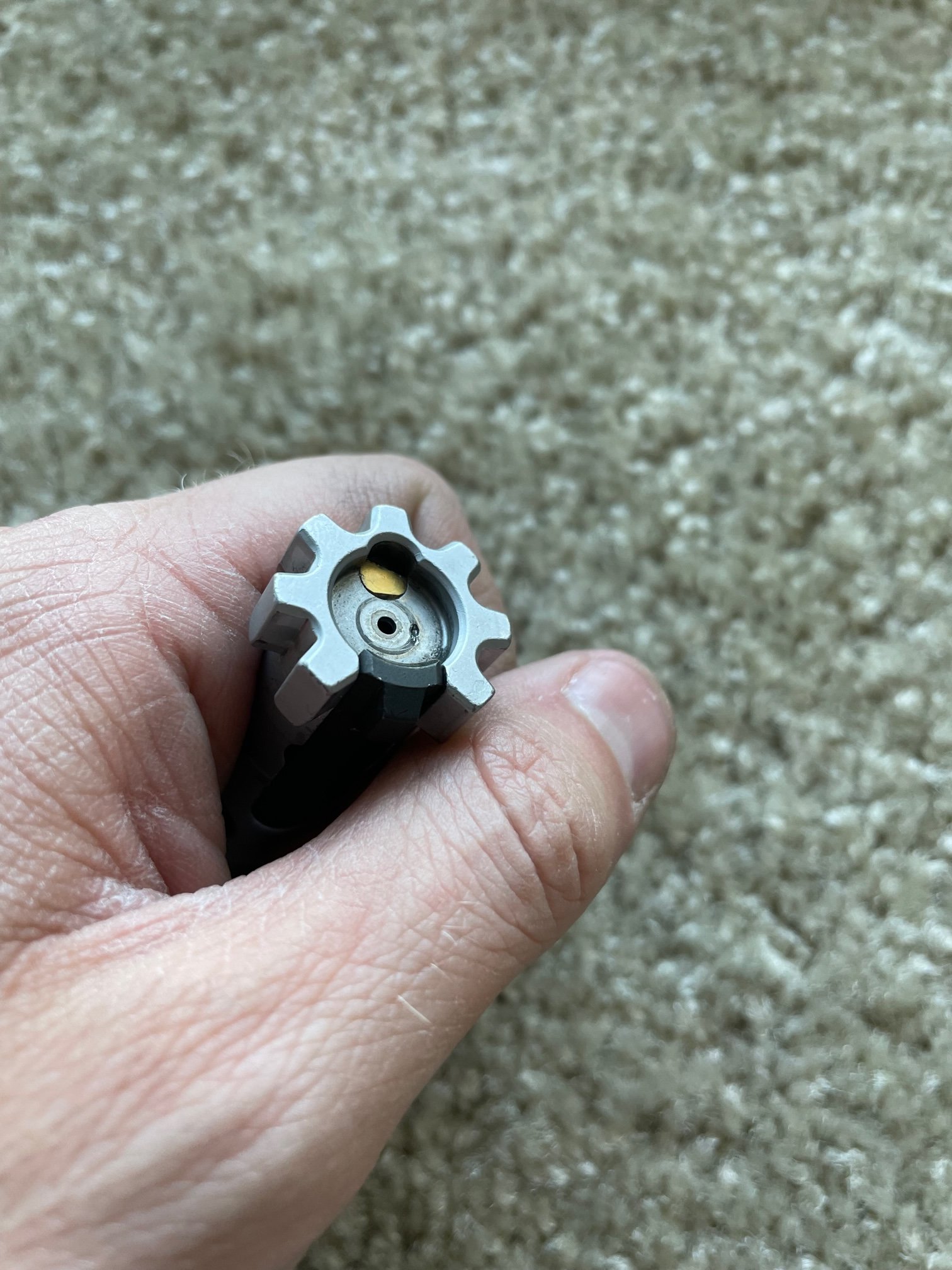

Touche, he's a pic of the bolt. You'll notice the ejector is stuck down..... this is the other problem I'm trying to solve. Removed the roll pin and zero luck getting the ejector to budge. I assume a piece of primer is wedged in there. I've smacked it, tried driving it deeper let it soak in brake fluid, zero luck.

Wow, that really did cut a divot out of the bolt face...more than I was expecting. I'm not expert, listen to the other guys, but I don't see any reason that this bolt is not safe....aside from your stuck ejector (and that really sucks).
I've not pierced a primer with rifles as for the last few decades I competed at skeet (note that I did NOT say I was competitive at skeet! haha...but I sure donated a lot of money to prize pots LOL).
I have pierced many primers with O/U shotguns...well, specifically my K-80 and 20 ga Remington Gun Clubs when those fuckers switched to a cheap ass Spanish primer with a brittle cup that the K-80 pins would pierce...maybe 2-4 out of a box of shells.
Of course quit shooting them in my K-80 as pins were like $300 for a set....and that was some time ago.
But, my sort of meandering point is that they never cut the breech face like that. Now, shotgun target loads are running about 9-10K psi which is far below what we experience in rifles so I would expect more gas cutting. But that is a nice gouge, alright.
Oh, about your ejector...perhaps soak with some Kroil penetrating oil? And there is absolutely no access to the back end of the ejector to nudge it out? I know squat about AR's.

Zero access to the back side of the ejector. I've got the bolt soaking now but otherwise I'm scratching my head. Clearly there is primer material wedged in there but given I can't get any movement out of the ejector I'm not sure how I'm going to get it free.
Lesson learned on the WLR primers.
In an effort to get the ejector pin to push up, after some soaking, I'd tap it downward several times with a punch to just get it moving and that might loosen it up enough to get it to pop up.
Yeah, I thought the same but when he said he couldn't get "any movement" I assumed (yeah, that word) that he tried to push it in to try to break it free.
@m1ajunkie - ah, you can't get any movement on it, correct? That is, even taking a brass punch and a small hammer...it won't move into the bolt as well as not coming out?
This is correct.... Using a punch/ hammer and bolt secured in a vice I am not able to get the ejector to move inward at all. I even got pretty bold with the hammer and started hitting it pretty hard, what ever is in there must be wedged pretty solid.
I've got a spare bolt I'm tempted to drop in to keep shooting while I figure out how to get this first one fixed.

Wow, that is jammed up.
Do you think tapping it and threading in a screw might help by giving you some purchase.
Or, use a drill press and just drill the bastard out….and I say that in utter ignorance of anything that is machinist like knowledge. So, take it w a grain of salt.
Also, are they dissimilar metals (e.g. one I’s steel and one is brass) and maybe popping it into the freezer for a while might get you some room. Or warmed up in the oven?

Ahhhh good call.... I didn't think about the freezer. I don't really want to add heat until I can talk to the manufacturer to see if they have any guidance but I'll pop it in the freezer this afternoon and see what happens.

Your bolt face etching isn't bad, but I wouldn't risk it getting worse. 41.5 of 4064 is on the light side of middle charge (you need 2550 fps to keep a 175 supersonic at 1,000 yards).
That particular lot of primers is suspect.

Not worth messing with in my opinion..... This stuck ejector is really annoying and the etched bolt face is a real bummer on a rifle I'm literally 25 rounds into. Plenty of other good options out there that you won't have to worry about.

Just a bit of follow up, I was able to get a hold of Olin customer service this morning where I explained what my situation. They have requested all remaining primers that I have from this lot be sent back for them to inspect as well as the pieces of fired brass I have.

Did you get the ejector out yet? Lay some flat wood down and smack the bolt face down onto the wood. You are trying to create momentum like the ammo hammers to take cartridges apart. It may work.
Reactions: Aftermath
No luck on the ejector yet.... I reached out to customer service for the manufacturer to see if they might have any guidance but no response today.
I have smacked the bolt face probably 50 times on a piece of wood, I tried using a punch again today to drive the ejector deeper, I put the bolt assembly in the freezer all yesterday afternoon. I'm legit stumped on what to do next. Wish I could get something figured out as I really want to run this rifle this weekend if possible.
I have a spare bolt I'm tempted to drop in just to keep shooting if I can't get this one fixed.
You can put a .45 ACP case in the bolt face, then tighten the bolt and case in your vice. Drive out the ejector pin with a punch. The ejector and pin should come out so you can clean it out if it's a brass shaving.
Reactions: m1ajunkie
