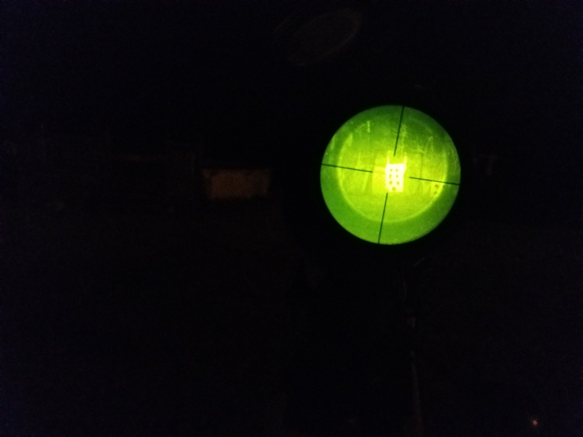

I also use white painted targets. Works fine for me. This is at 100y while experimenting with the Luna.

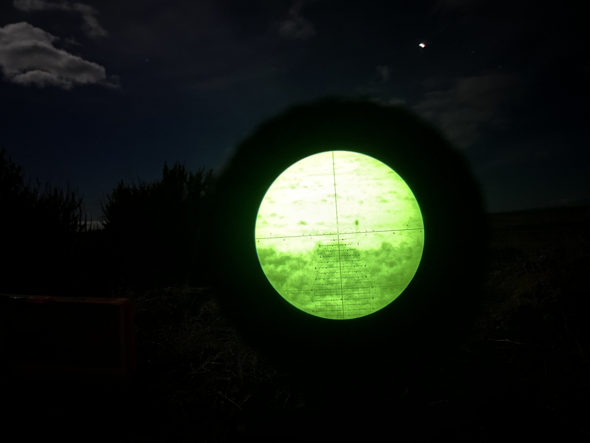

So I went out last night and tried the black paint.... for my environment this is the way to go. Tried to snap a picture but my phone was struggling to focus the image. Anyway that's a 2/3 ipsc at 515 yds just up and right from my cross hair. Did not need the illuminator to shoot the black targets.
