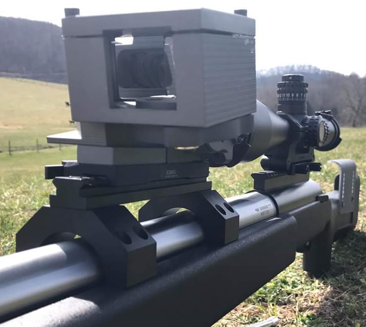

I'm not running a Charlie or a prism anymore, it's extra shit to look through that's not 100% reliable and amplifies the mirage even more at extreme ranges, and it adds to time during transitions if you need it for a further target during a string of fire. Starting in June this season I went to a 94moa offset which is 35" high on my rifle at 100yards. It's pretty much a perfect zero at 1550 yards. It worked good enough for 2 firsts at Spearpoint, 3rd at the Castle, Spearpoint season championship, and the crown at King of 2 Miles.
For reasons stated above. I went with a 80MOA offset this allows me to hold -8.25 Mils at low power to engage a 100 yard targets. You get used to it. The idea is to make the system as simple as possible.

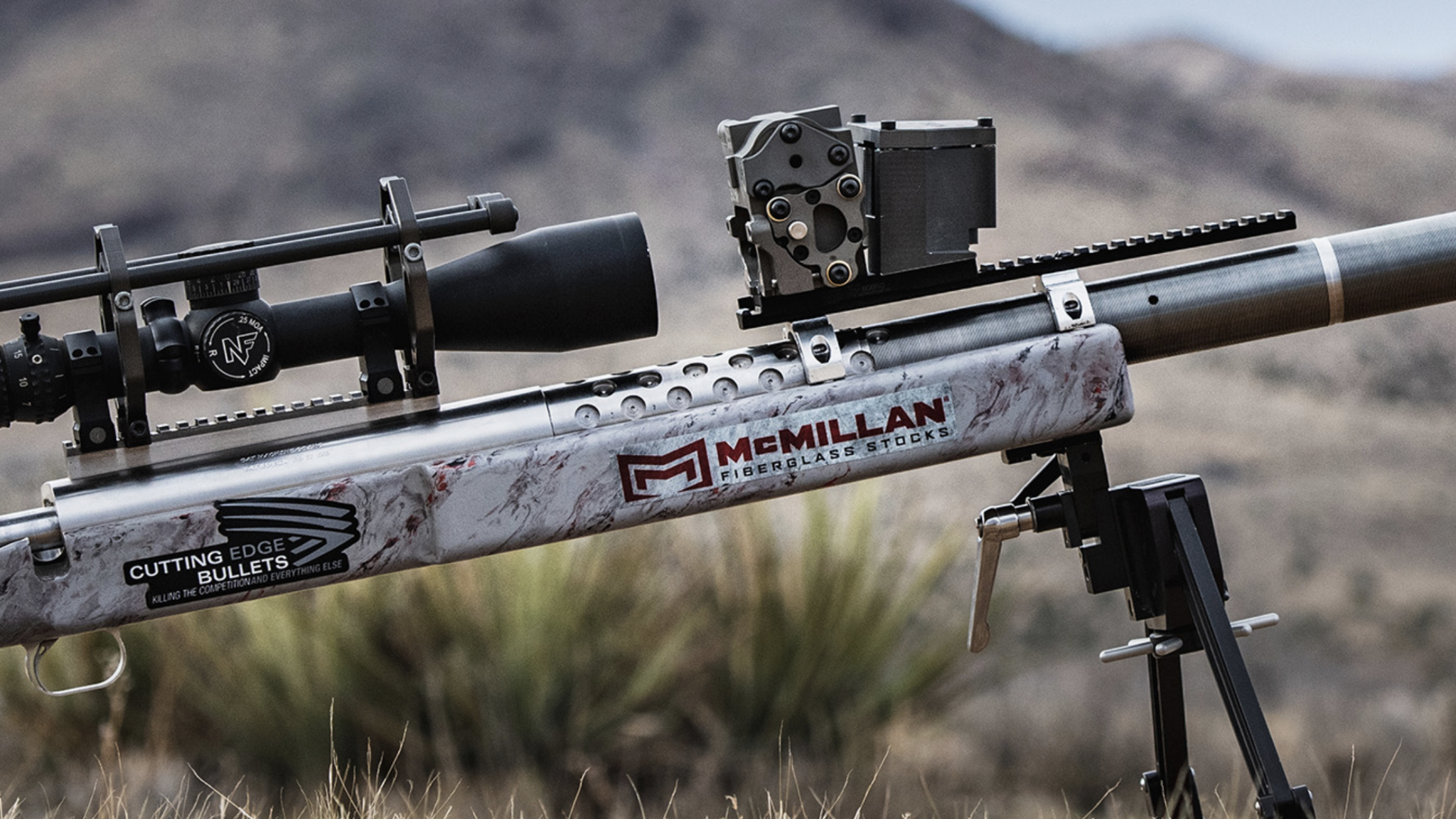

Guy's who are running a Prism or Charlie, I'd rather clip it to a rail but I don't know of a bridge that will go into a normal forend that will fit over an 1.25" tube? easy way is a chassis but I prefer a stock
The ones I've seen have all been custom mounts built by the gunsmith. Robert Vestal is very capable of doing this for you.

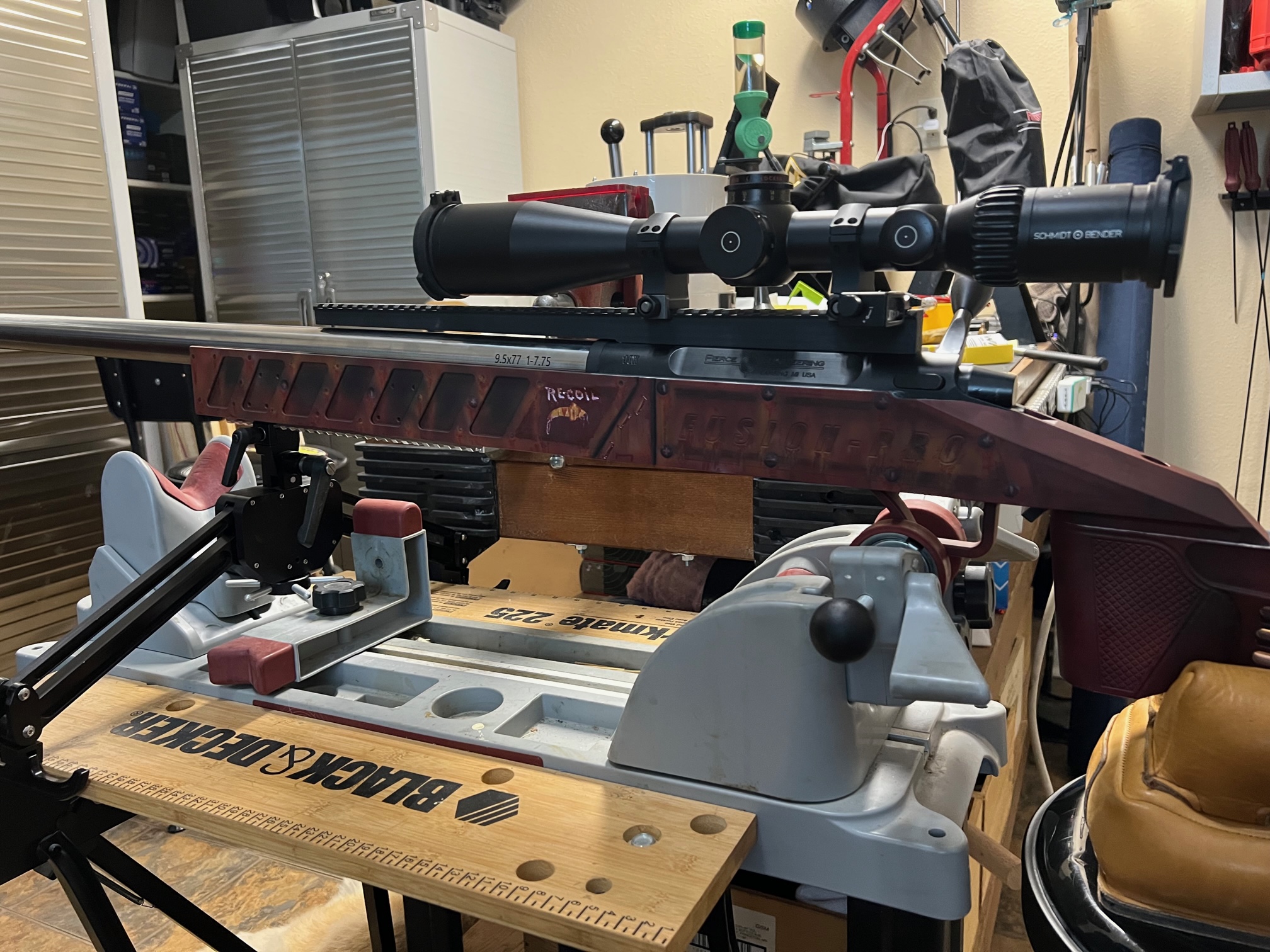

That rail is made by Mirage URL - the setup above ^^ is a 30moa rail + 20moa rings = 50moa , and that nightforce is zeroed at 100 yds , Mirage has also made me an extended 50moa rail for a pierce action on a different rifle - exactly the same outcome can use a prism or charlie as required, Ill try find a picture and post the 50 moa
And here is the 50moa on a different action/s&B scope and chassis - it also zeroed at 100 yards, it looks longer than it is but that's just perspective
