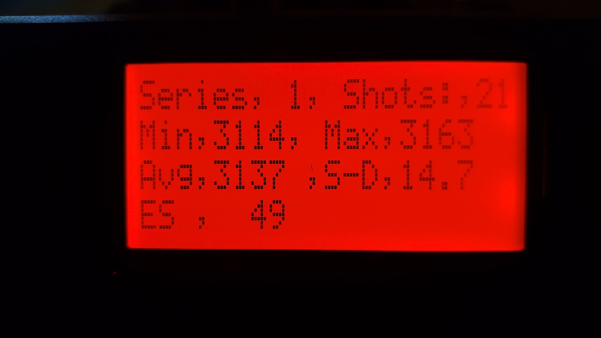

Does this seem pretty bad... slot bigger of a spread then I was expecting, and in my 300 norma magnum im shooting
215gr Berger's
H1000 86.0gr
Lapua case
250 primer
I would like to get that spread a little closer together anyone have any tips to get some better muzzle velocity variation?
Not terrible but there is room for improvement. Annealing and sizing necks with a mandrel did it for me. My ES for 40 rounds today was 19 and SD 3.3 IIRC. I pay more attention to ES. I've had better numbers but not regularly and not by much when I chrono 30+ rounds.
