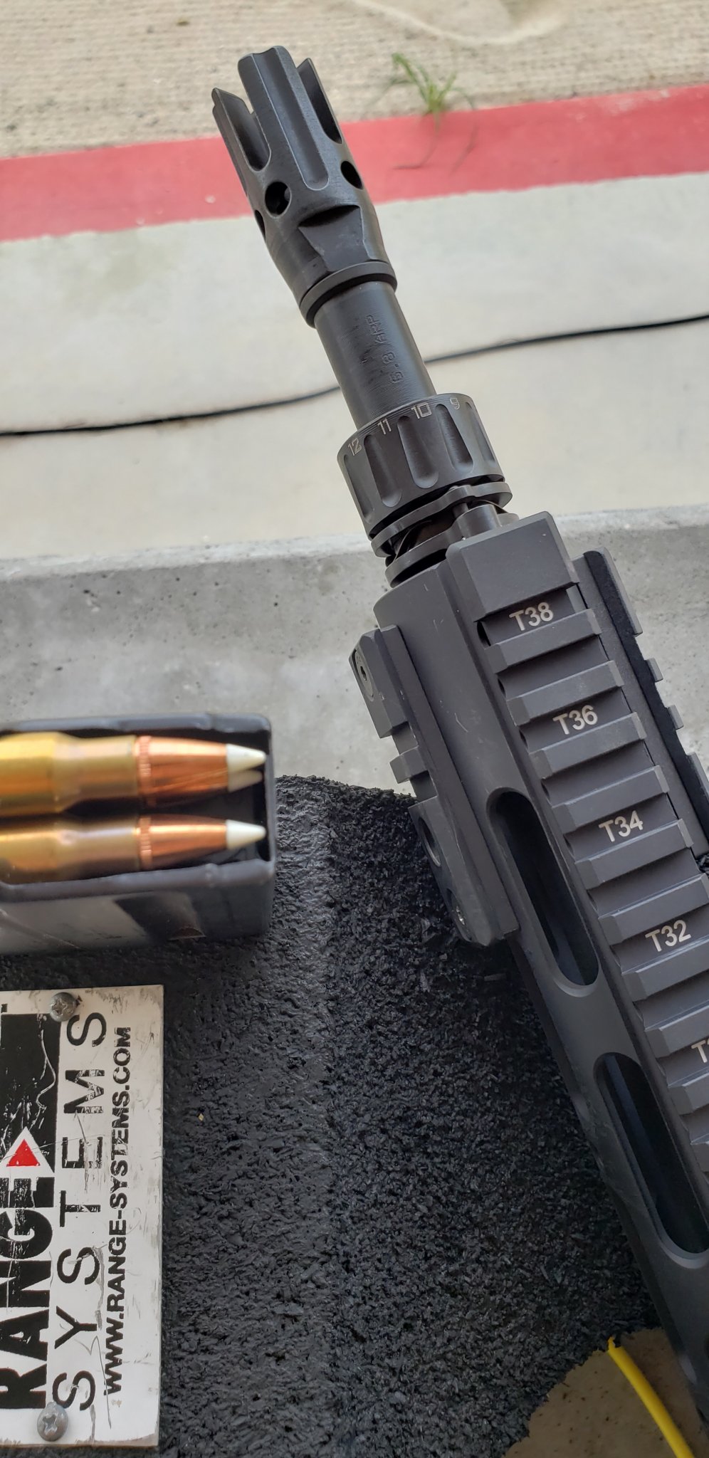

The Riflespeed gas block may help tweak the gas between suppressed and unsuppressed - very easy to use. One on my 12.5" 6.8:

That looks sexy AF with the gas block like that. I’ve only run SLR AGBs, so can’t speak to Rifleworks but now you’ve got me thinking… might look mighty fine nosing out on the MK12 inspired build the damn Hide has me dreaming about making.

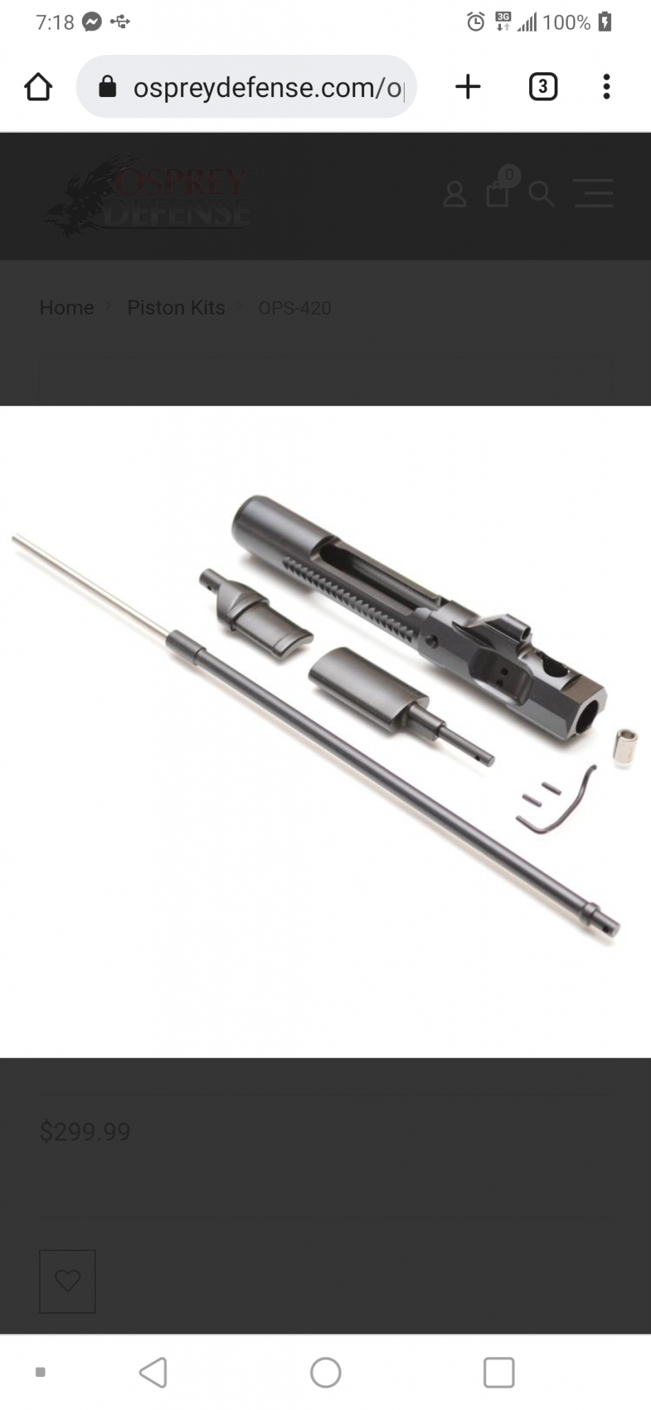

If you're wanting to compare a piston with little commitment, you could run the osprey defense drop in system.

Never heard of them. The website has almost zero info and I'm having a hard time wrapping my head around the gas block end of things. Care to explain?

Tony, these look to be a direct replacement for the gas tube carbine length systems utilizing front Sight Post gas blocks.
Pop the gas tube retaining pin out of the FSP, and install this in its place. It has a built in piston/cylinder chamber that gets covered by the delta-ring mounted handguard.
Likely not much value for any configs that don’t use FSP and standard plastic fantastic handguards, but a neat idea if nothing else!
