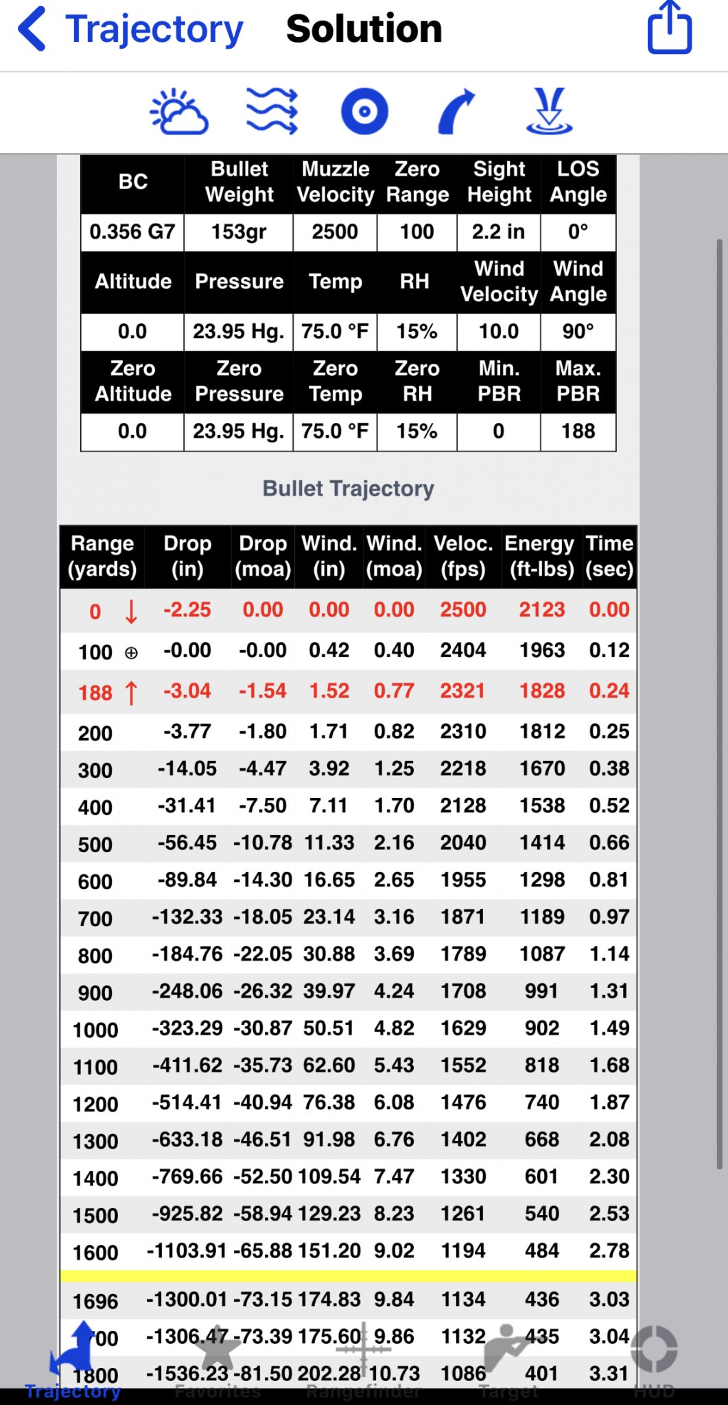

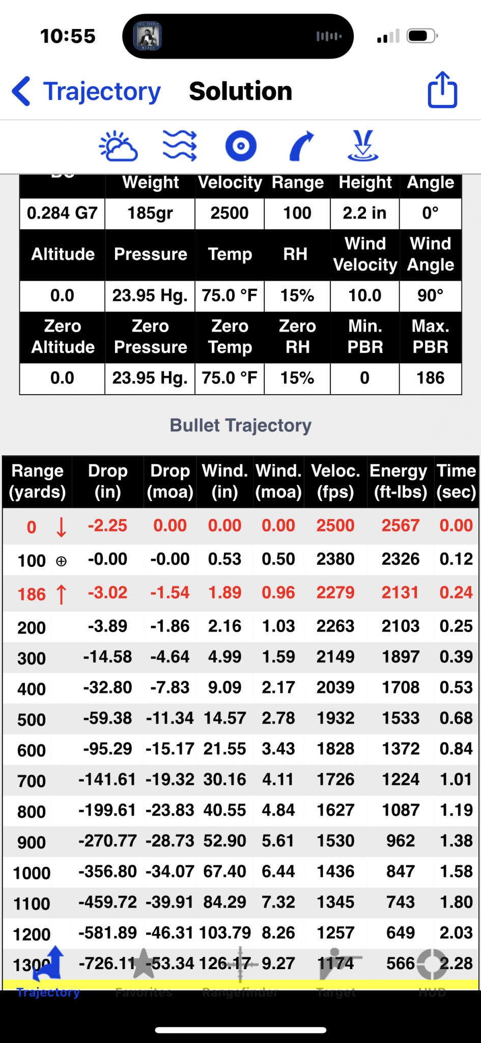

Through what calculator? Assuming I don't have the calculator needed, could you post up the numbers and explain?
Dont take my word for it. Go to JBM. Enter realistic velocities, pick bullets/bc’s you’d likely shoot.
Here’s berger 185 jugs and berger 153’s at the same muzzle velocity. Weather is my local conditions.
