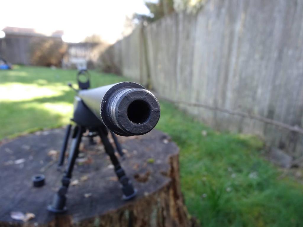

Hi Folks,
I just got a 700 SPS Tactical AAC-SD. However the muzzle of the rifle is pretty rough. It looks like it was not processed and polished. I have not seen a similar one by googling. Do any of your AAC-SD muzzle look like this:

Is that a new rifle?
It looks to me like it's been fired quite a bit with some sort of muzzle device attached.
Mine was faced (machined) flat with a pretty nice surface finish (smooth) and an even phosphate (Parkerized) treatment.

My thoughts exactly. That rifle has been fired before.

[MENTION=97829]delixe[/MENTION], it is a used rifle, and the original owner claims that it has only 10 shots so far. Overall the rifle looks pretty new. I am asking him whether he has used a muzzle brake before.
If it is new unfired then ya you got a problem but if its used... yes, it looks like mine after shooting with a comp on the muzzle for 50-100 rounds. Carbon builds up and the pattern is the mirror image of your rifling.

I got this rifle used. However the original owner claims that he bought it new and has shot only 10 rounds through it - the rifle does look like new and especially from the minimal wear of the bolt and the receiver. I just contacted with him, and he said he never installed any muzzle device on it before.
If it is carbon built from shooting, it should be cleaned up by solvent. I will try some solvent this evening. Initial look and scratch using my nail it looks like metal...

Another 'only had about a dozen rounds through it!' That actually means about a dozen boxes! Scrub, scrub, scrub with some bore cleaner and an old toothbrush. While you're at it, scrub the bolt face and extractor. I'll bet it's dirty too.
I doubt its proper cleaning etiquette but I use something hard to break it loose. Just don’t use anything hard enough to damage the steel... hard plastic and/or wood pop sickle sticks work.
