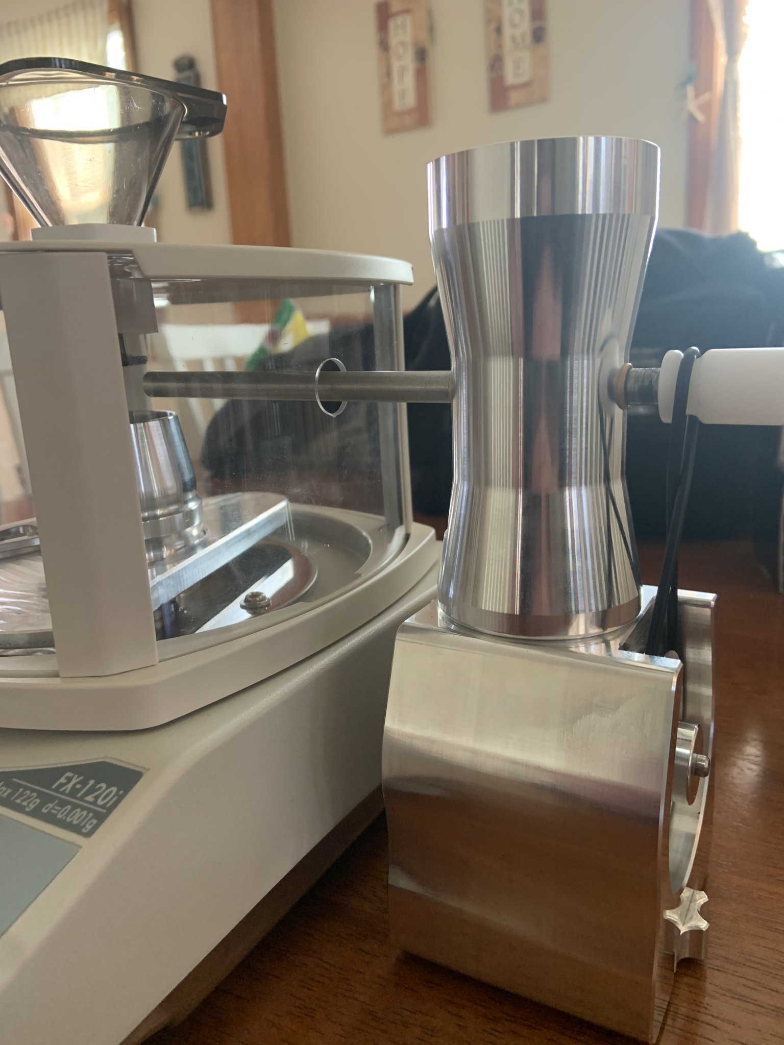

Looking for some info on what kinda of drill bit for drilling a hole for my AutoTrickler. Can’t say that I’ve ever drilled Lexan before, and I don’t wanna break the draft shield if I can help it.

small pilot then a stepper bit to open it up. it’s not as complicated/fragile as you’re worried about. just let the boy do the work and don’t press too hard to flex it.
Reactions: 7mMike
I melted mine then took a Dremel / razor blade to clean it up

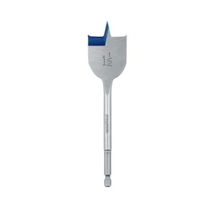

Get a wood boring bit of the appropriate size and run it as slow as you can and it cut good.
A bit like this....
