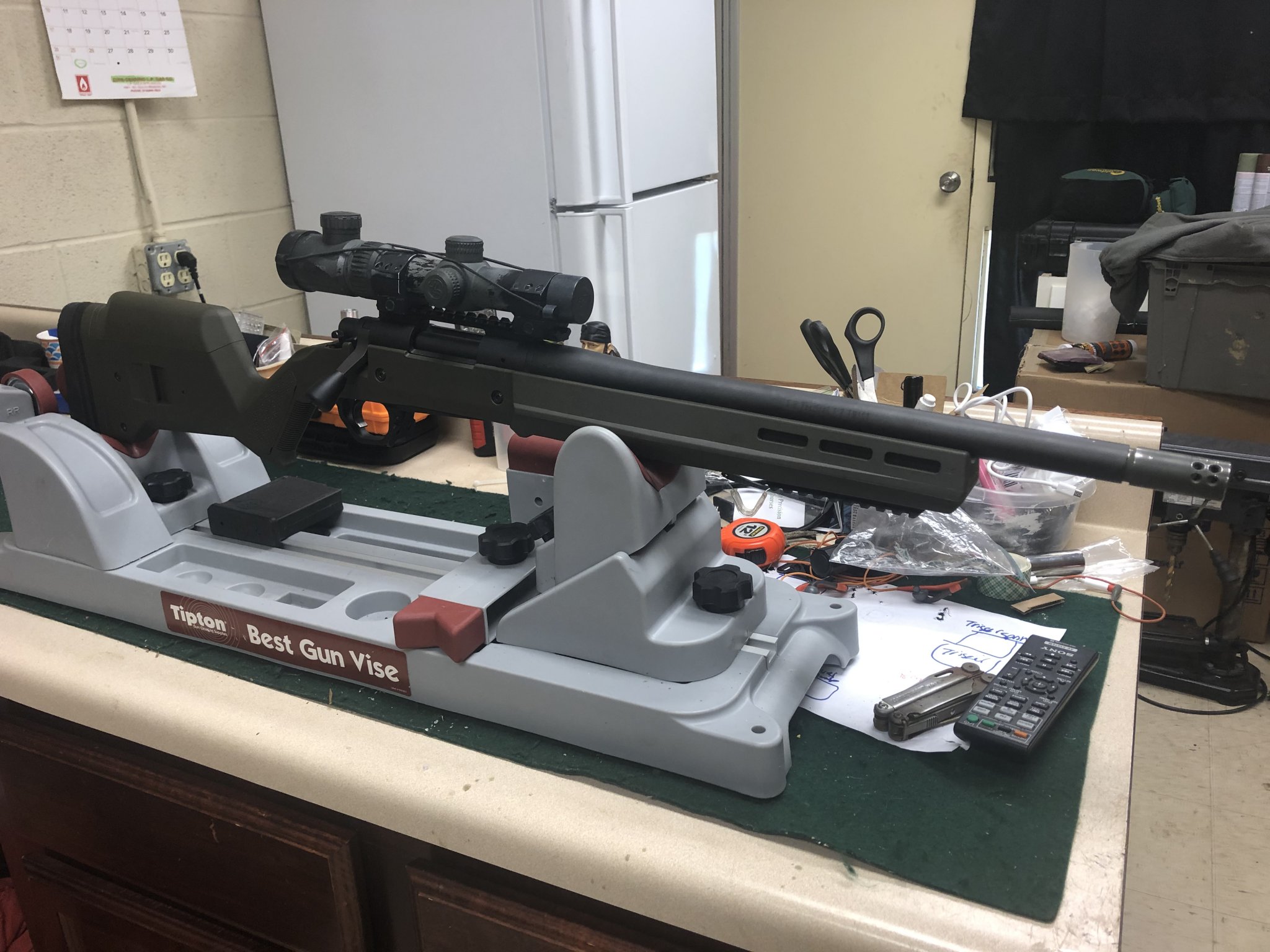

Everybody can cuss at me later cause I’m about to use the “R” word. I have a16 inch barrel Rem700 SPS Tactical in 300BO. For what the round is and what he wants to shoot(heavy/slow subs). Find yourself one of these guns and put some lipstick on it. I am more than happy with the one I have sitting in a Magpul hunter stock.
I also have a 10.5 inch SBR that’s shoots good for what it is.

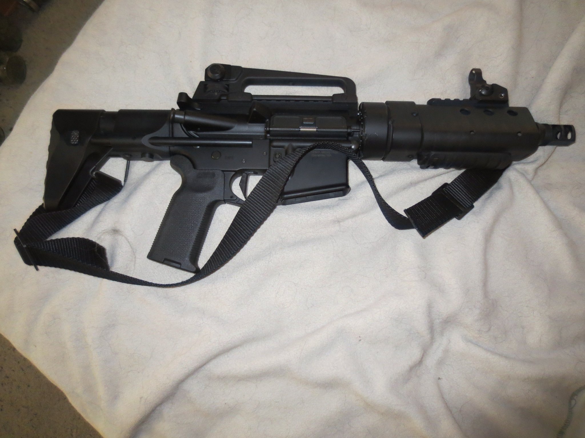

This is as short as I can build one using an 8.2" Noveske bbl. and a Maxim or whoever collapsible stock. It uses the Ultra 5 and is only like 3.5" longer because of it. Ultra 5 will actually hush one of these up about as well as some other mfg.'s flagship cans will and the 9"? None better. Or lighter.

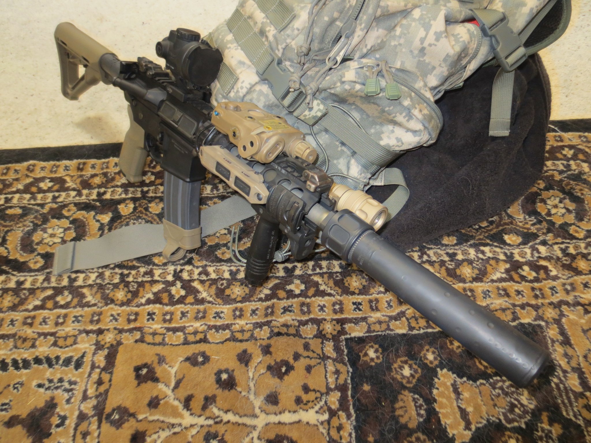

This one has the 30CB9 right now and that mount is being diverted to another project. 8.5"bbl.

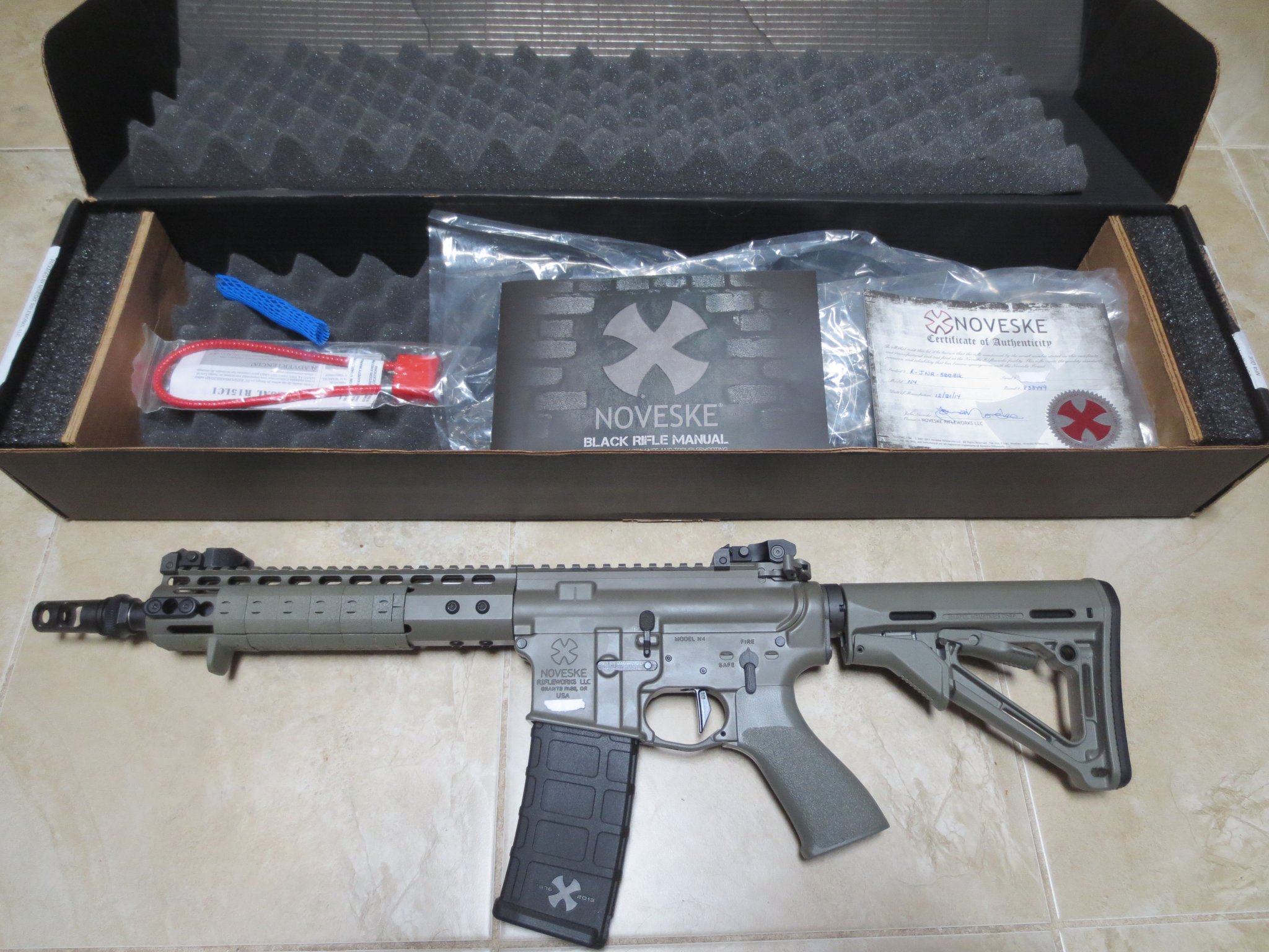

I'd consider that Noveske upper were I you. This rifle is complete, 10.5", and it's probably one of the handiest and lightest AR's I've got. Never used it though, it was a collector piece I got for my ex wife. I'll probably shoot it later next year maybe. Or not. I have others. But that upper for $1350 above comes WITH an MRO? Same as the one on the rifle above? Noveske makes a great barrel too and .300BLK is hard to wear out. I'd jump on that for the MRO alone, hell, he's basically asking half price for both items!
