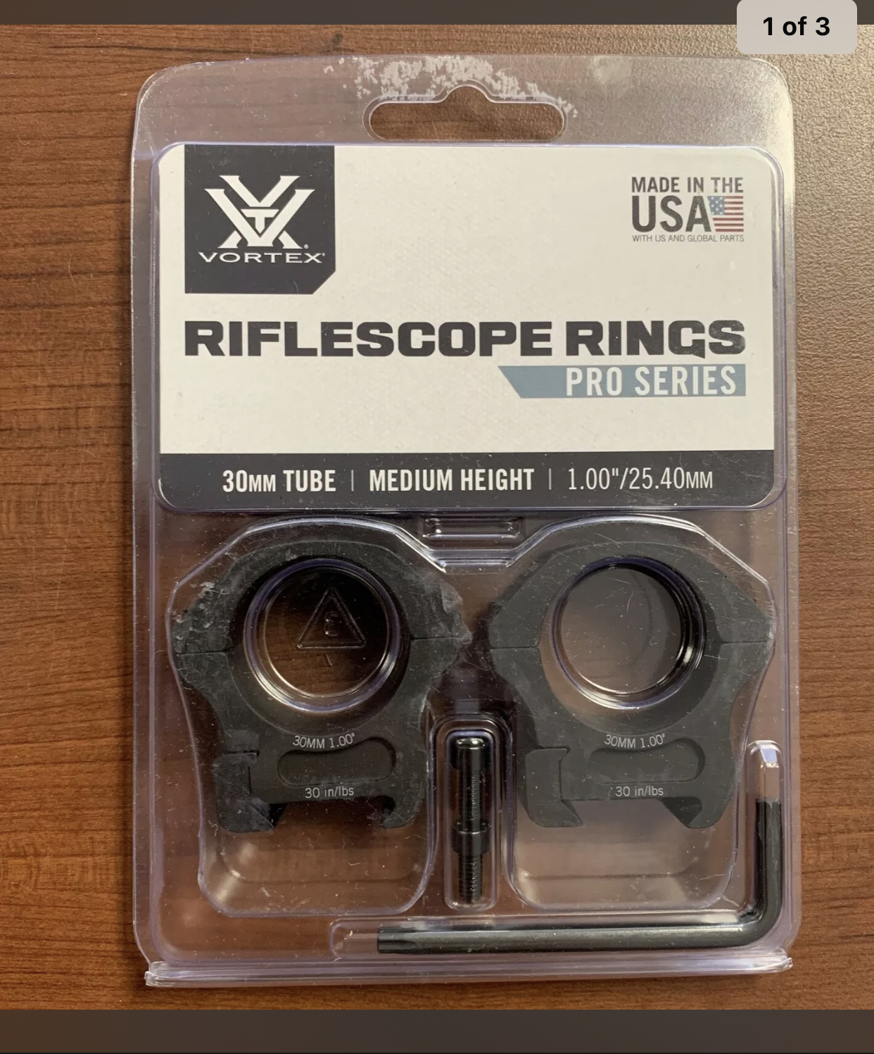

The scope is a Vortex Strike 4x24x50. Model number is SE1627 I think.
They are on clearance for 299.99 at Europtic
This is what I wound up with. There is less than 1/8 inch clearance with barrel. Just enough for flip up caps.
