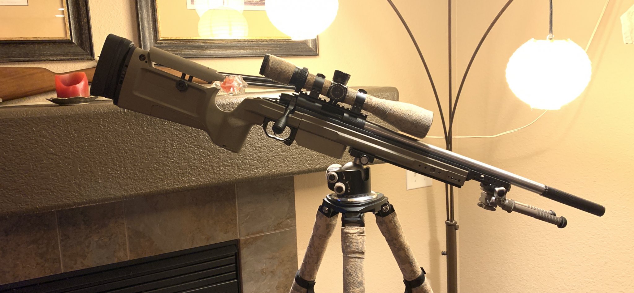

Vortex low rings on my MPA with NV bridge. MTU barrel.
Reactions: Jefe's Dope
Depends on if you want the enclosed nv bridge chassis and need to clear that. if you do then you're looking at 1.35" height to clear it. If you don't, then you can go down to 1" rings.

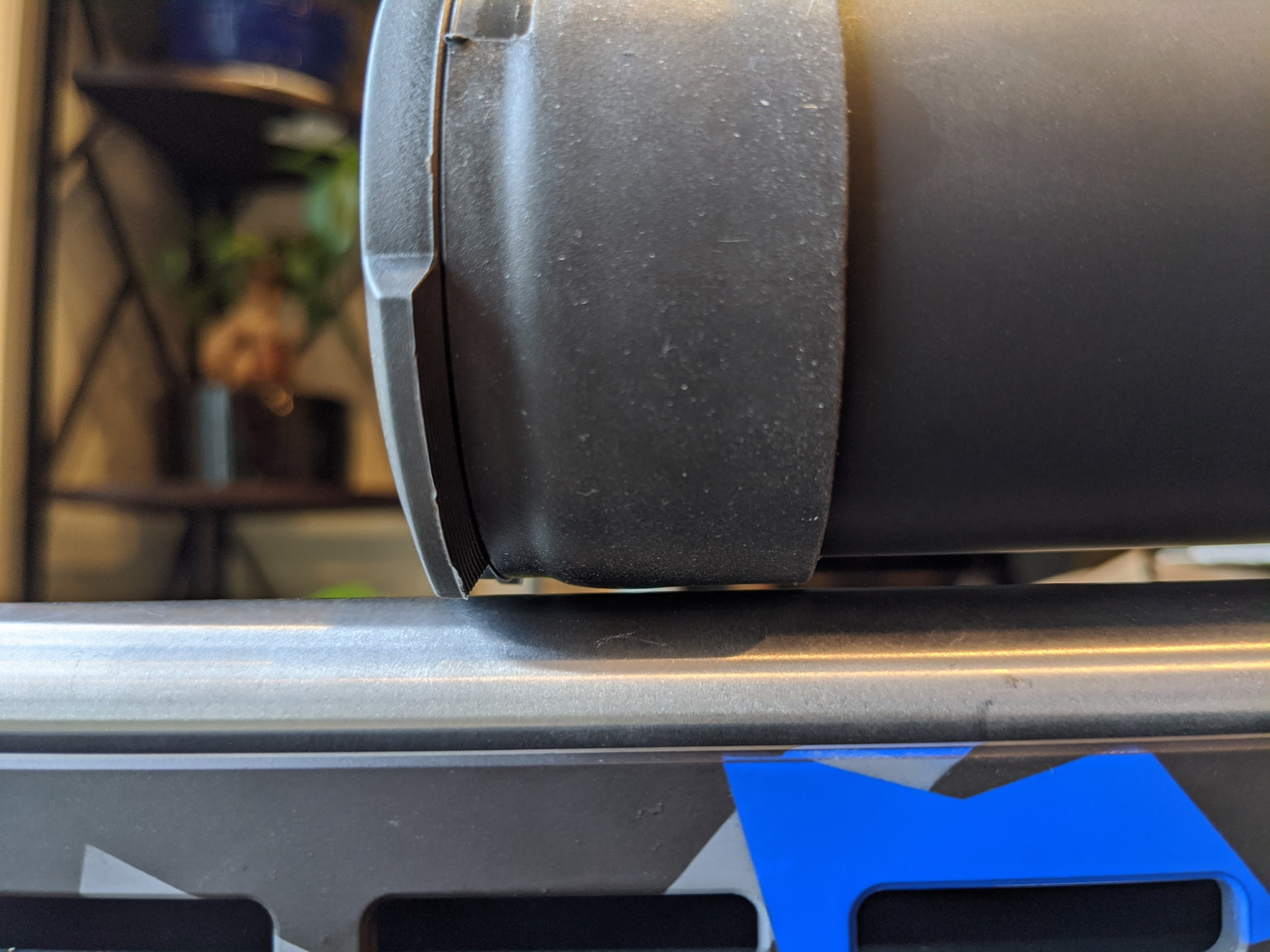

IIRC, these are NF 'low' .885" rings w/ an Athlon BTR/50mm objective. 40 MOA Vudoo rail and Kukri barrel.
Edit: The Vortex 'low' are .9". As seen in the above post.
Yeh I used to do that, but then I switched to 1" so I could have a little bit of the Vortex Defenders cap clearance, or if I want to throw a dfat on it.
