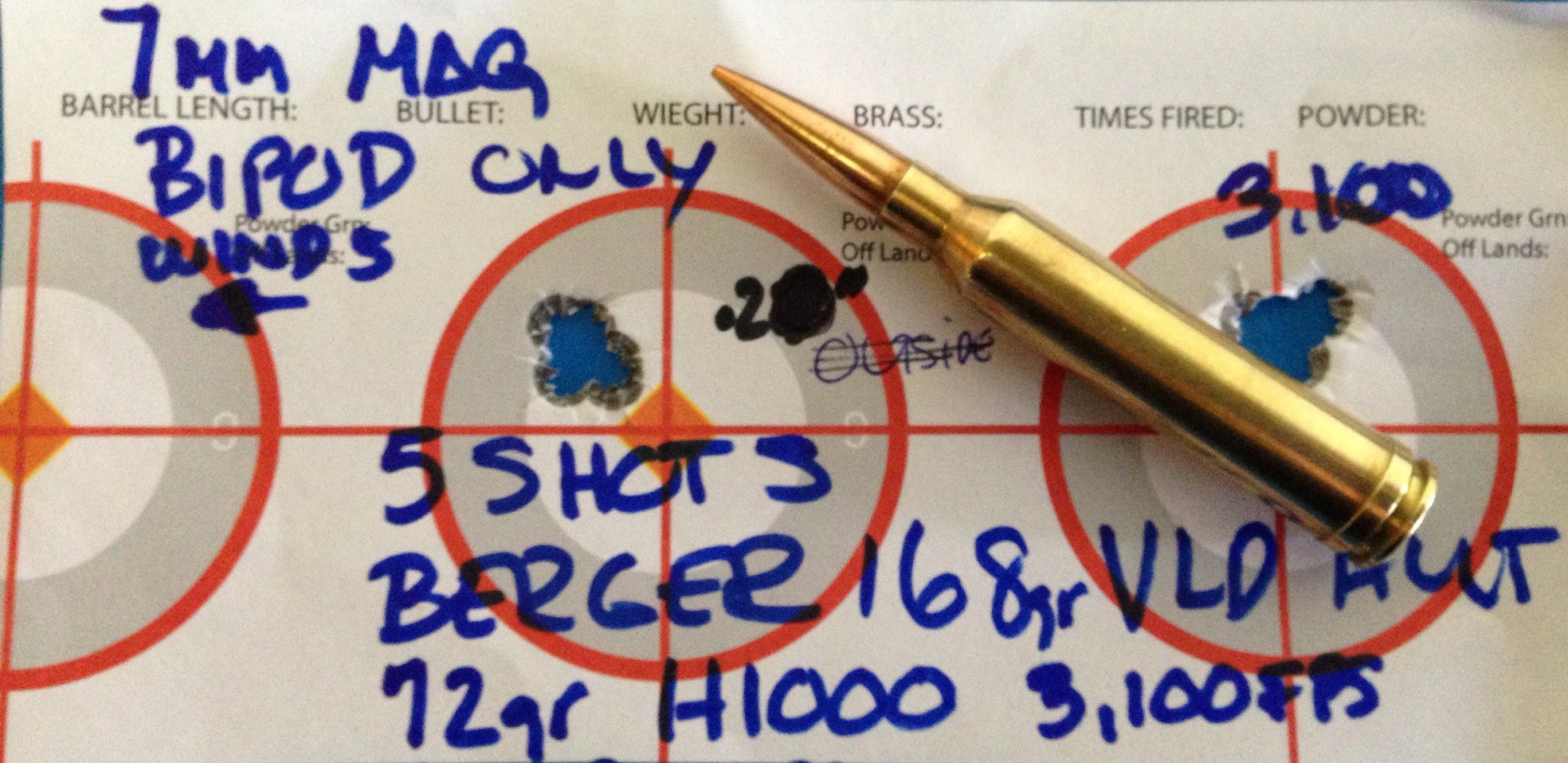

Anyway, my decision of staying with the 7RM or going to the 28 Nosler came down to:
1- 28 is expensive brass and less factory ammo available when traveling.
2- 7RM, the current last couple barrels shot lights out with plenty of speed. 168s going from 3100+ one hole groups to the solids mandated in my state at 3,225fps.. just do not need more gas.
So my plan is now to stay with the 7mm and switch between barrels just to keep barrel life longer for the Proof. Plus I’ll have very little load work and do not need more dies..
Also never had any feed or base issue with the rimmed case so that argument hadn’t really been an issue.
