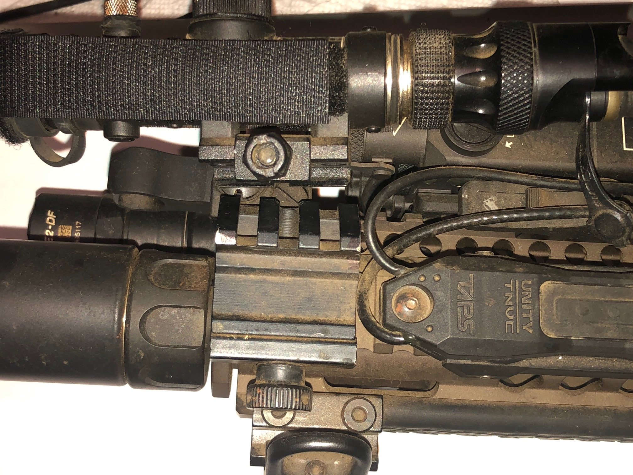

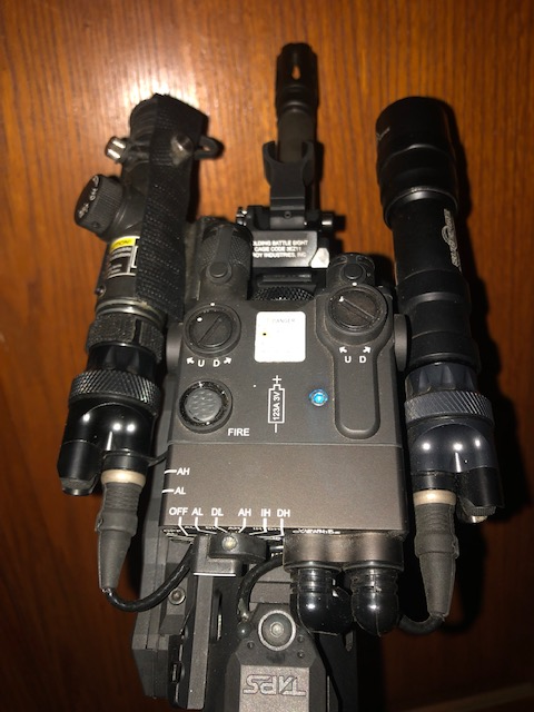

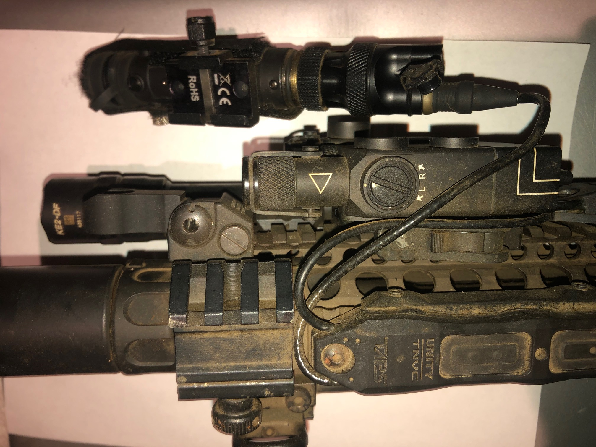

So on a Civi LAM such as the Dbal's I am partial to taking a "tuned" Luna Elir-3 (on left in picture) and slaving it to the Dbal so that you basically have a full power Laser based Diode Illuminator that will get on out there like it should. It is perfectly matched power wise to work perfect with you 0.7 mW IR Point on the Dbal I2.
To slave a Luna ELIR-3 all you need is a Luna/Surefire Adapter, Surefire Socket Tailcap and make the marriage via a Unity Taps Sync. One press of the Unity Taps Sync will activate your IR Point and Full Power Luna IR Illuminator.
You do that and your Dbal I2 Civi unit will walk all over a MAWL distance wise for performance. Much cleaner Illuminator beam than the MAWL also.
That is a Dbal A3 in the picture. I like for my white light to be a separate item unless it is on rig running a Dbal A3 and I slave it into the Vis Point Override Port such that with one press of a button I have instant white light and Green Vis Point.

Do you have the ELIR on an offset mount? Or is it just picatinny on your 9 o clock rail? I've been wanting one and I think talking about it like this is gonna make me pull the trigger lol
I have cheap ass Chinese 45 degree mounts that I put on my DD Ris II rails that will lay the Luna's and Surefire Scouts right up nice and tight beside the Dbal A3's. Makes for a pretty snug and clean setup.

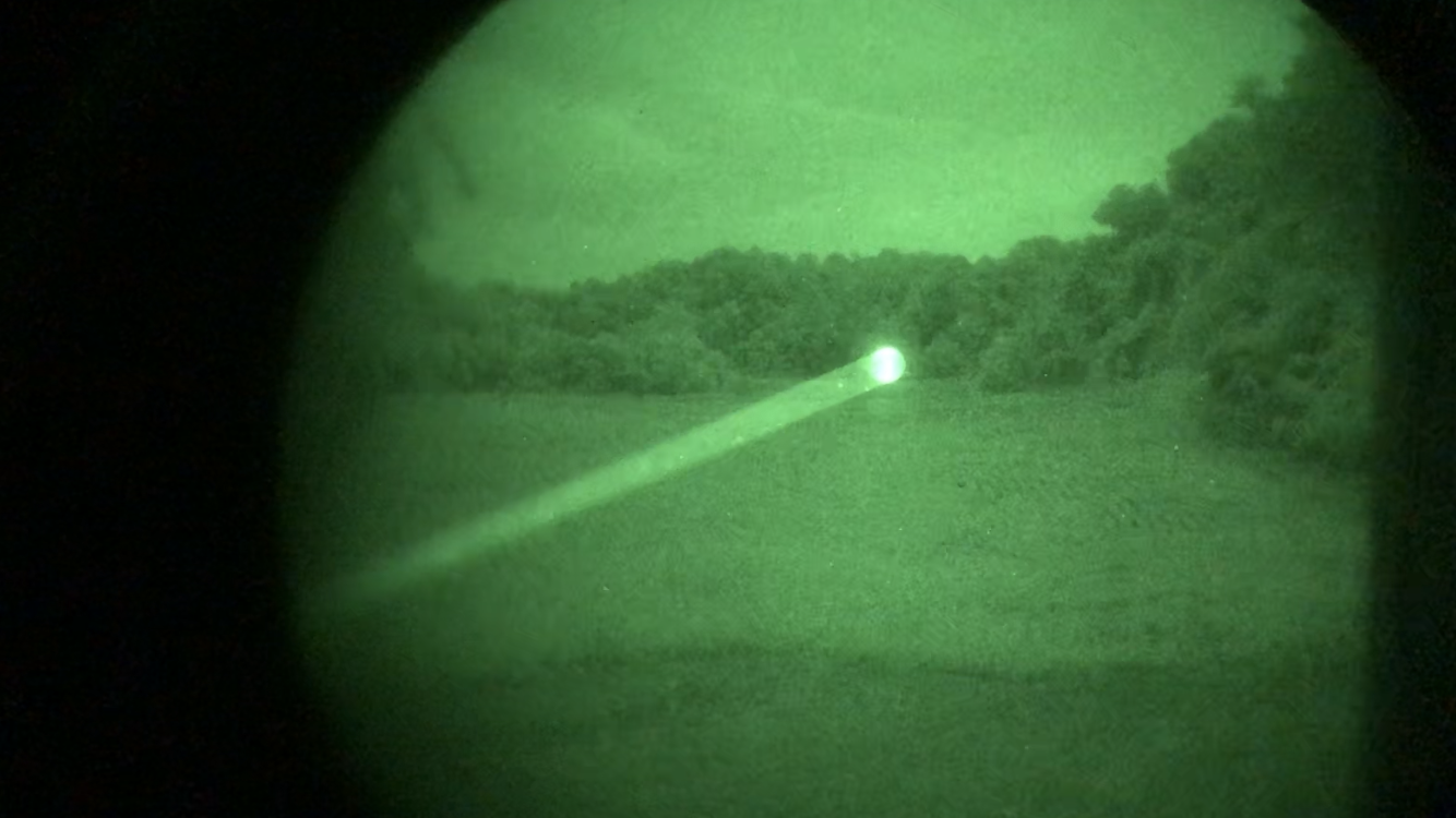

Here is a Luna ELIR-3 doing its thang at 1,000 yards.
Its good for much further than that if need be. Or it is great at 50 yards dialed back. However, it is always nice to have an Illuminator that will let you see what is going on in the next County if you want to.

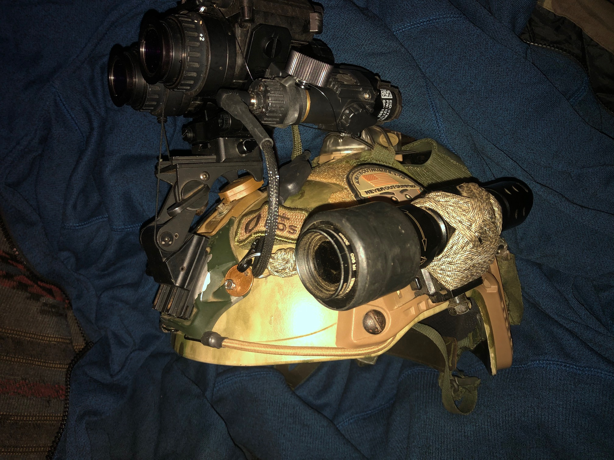

However, those Chinese LED IR Illuminators make one of the best helmet lights for general illumination and if you put a 950 nm Pass Filter in front of them you can kill that huge red glow they throw out and turn it into a true stealth light that cannot be seen via human or animal eyes.
I personally really like this one. Excellent helmet light. Put a 950 nm Pass Filter on it and it is the Cats Meow for stealth IR light with Zero red emitter glow for animals or humans to be able to see.

So you unscrew the slip on adapter off the back of a USGI 3X Magnifier. Screw the filter into the front of the adapter where the threads are. Then take a small piece of bicycle inter-tube and put around the back piece for a shim which will now slip very snugly in the inside bezel of the Evolva. Then take another bigger piece of Bicycle inter-tube and put over the whole front assembly and you are good to go. Works perfect. And if you want to you can unscrew the Zomei 950 pass filter in and out if you want to unleash the full power of the Evolva.
For me, I always leave the 950 Pass Filter installed. I can still get out to 300 yards and illuminate very well that a Gen 3 tube can see. Theoretically you are getting at the end of the wave lengths that a Gen 3 device is supposed to see, but like I said, it does very well for me with Omni 7 Gen 3 tubes.
With this set up there is Zero visible red glow able to be seen from the LED emitter. :)
