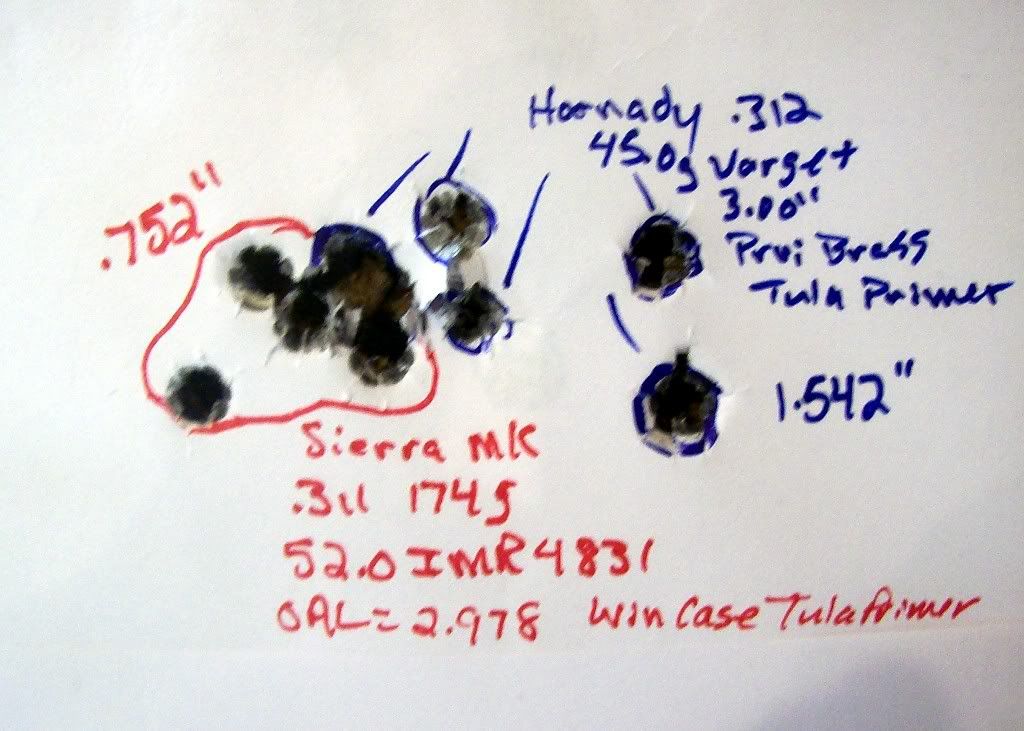

I've had very good luck with the Sierra 180gr. soft points (.311). The 174gr SMK is usually excellent, of course, as well as the Hornady .312 174gr BTHP. The best I've used, however, is the Lapua D166 (usually not called by that name on vendors' websites, but it's the 200 grain FMJBT and is a .310 diameter). They're expensive but are a world beater....literally. Always slug your bore to try to find the best match for an individual rifle.
For powder, try Varget, 4064, IMR or H4895. I'm also starting to see some really good potential with Match Kings over IMR4831:
100 yards. Loads tested from my '34 Tula PE sniper:
