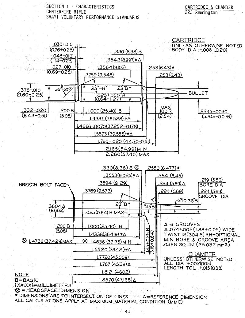

Neck is SAAMI spec. Will shoot factory ammunition. Not a “tight” neck chamber profile.
Reamer Neck refers to the nearly parallel diameter of the chamber as corresponds to the same parallel portion of the casing ahead of the shoulder.
A “no turn” indicates that the reamer is large enough diameter through there that no normal brass would require being turned and thinned to fit in the chamber.
Lapua, Peterson, and a few others are pretty thick necked brass. Some of that is due to having started with a thicker cup in the first place to get stronger final product, and some is probably by intent, knowing that we will turn a lot of it for match brass anyway.
Peterson, a boutique manufacturer, even goes so far as to offer “fat neck” brass just for this purpose.
A chamber for “all brass”, or a “no turn” should probably generate 3-4 mils of annular clearance with the heaviest brass... ie: Lapua.
Reactions: LRI
Remember that a “no turn” doesn’t mean you can’t turn. Just that you don’t have to.
A common myth in the practical/tactical rifle world is the only reason to neck turn is to fit a tight neck chamber.
Also, many “no turn” reamers are .002-.003 clearance. Many consider that pretty tight even though it will still chamber. I usually spec .005 for brass that I absolutely intend not to turn. At .003, I would be tempted to skim turn back to .005-.006 clearance.

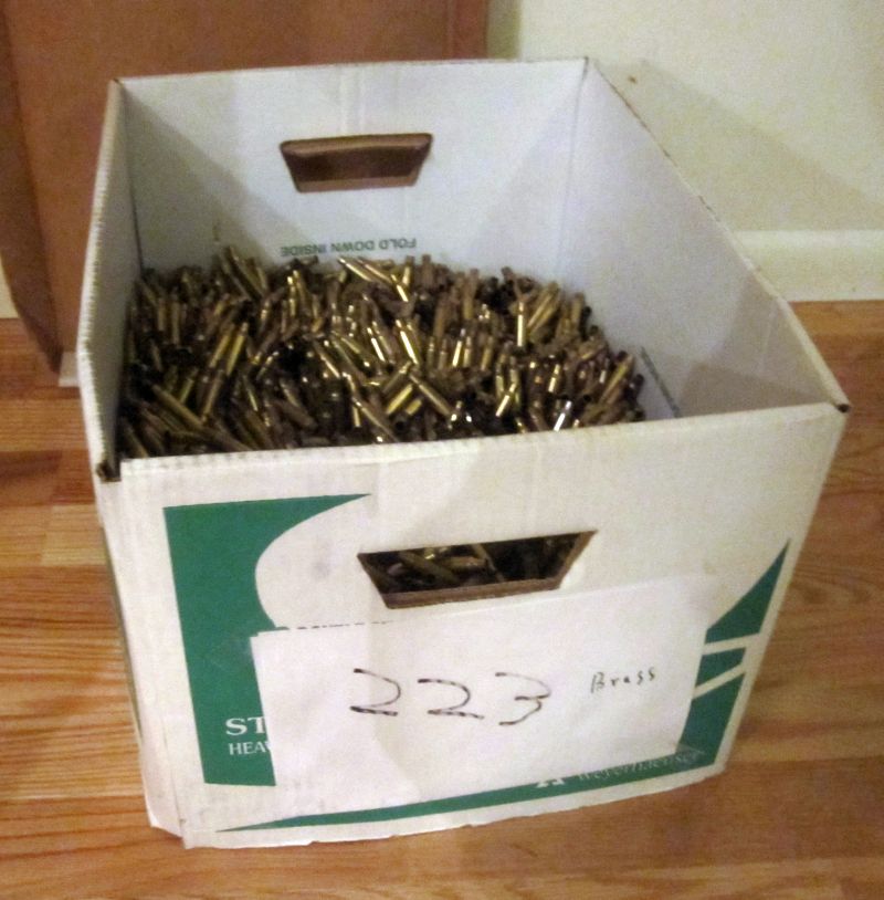

What brass are you using that will chamber at .250 without turning?
mixed for shooting rodents

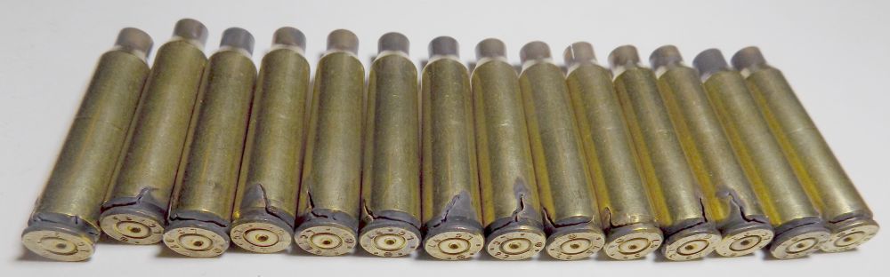

Maybe that is why 223 keeps blowing up in my face...
