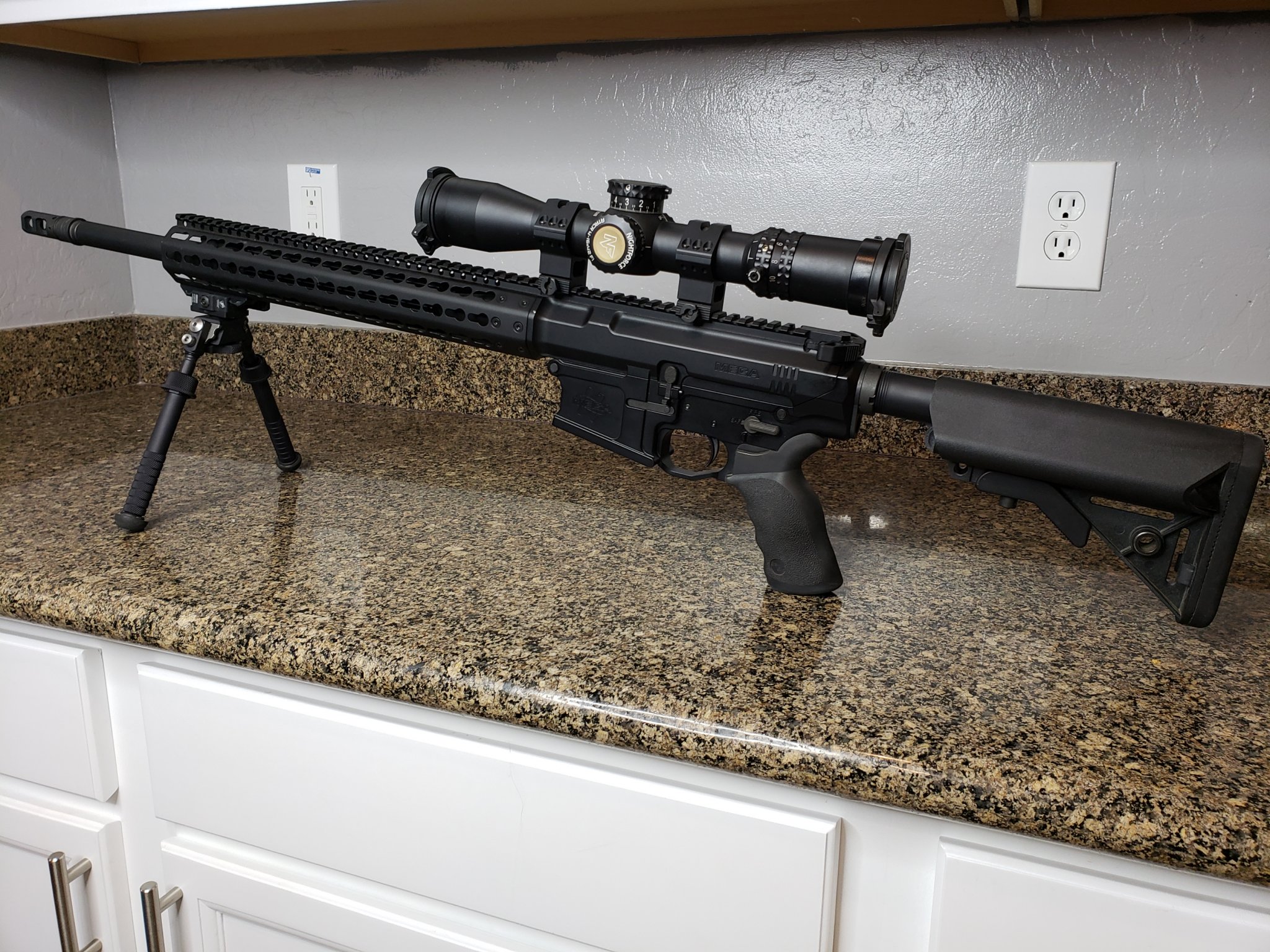

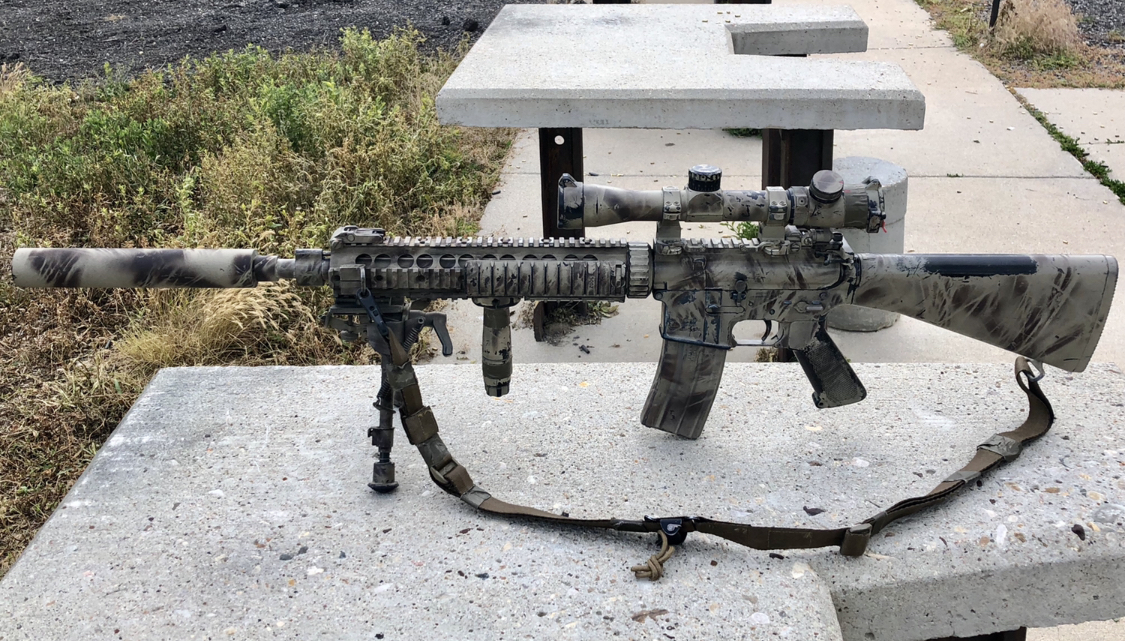

Interested to hear everyone’s thoughts on a reasonable expectation for semi-auto group size. At what point are you happy? I will divide this as well in to two parts, it seems to me that there are two camps in the semi-auto (ar-15/10) world: “Standard Guns” and “Custom Guns”. I understand it is not reasonable to expect the AR15 you built in your basement to meet the same standard as a JP, Seekins, GAP, etc. What do you expect from each?
I ask because I recently built a 224V and am in the process of working up loads for the gun. This weekend I was out at the range and had two loads that consistently shot 5-round 1.07-1.14 MOA groups at 200 yards (with a huge jump due to my current magazine, so there is some work to be done there…) If this was your gun and you could dial it down another quarter MOA and get to .75 MOA would you stop messing with it?
I have never had a “precision” rifle of any sort and want to set my expectations in-line with what is considered good for a semi.
Cheers.

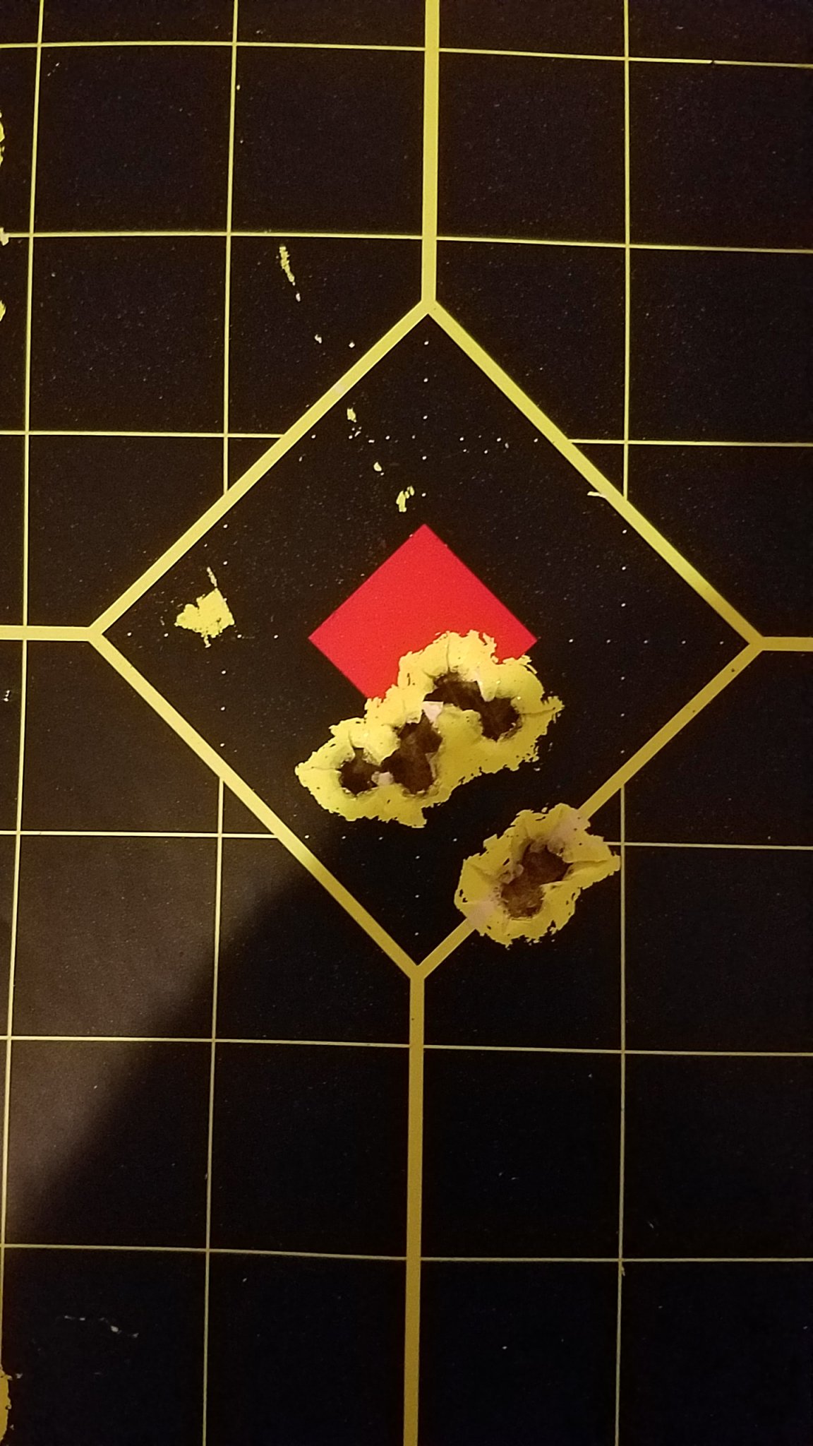

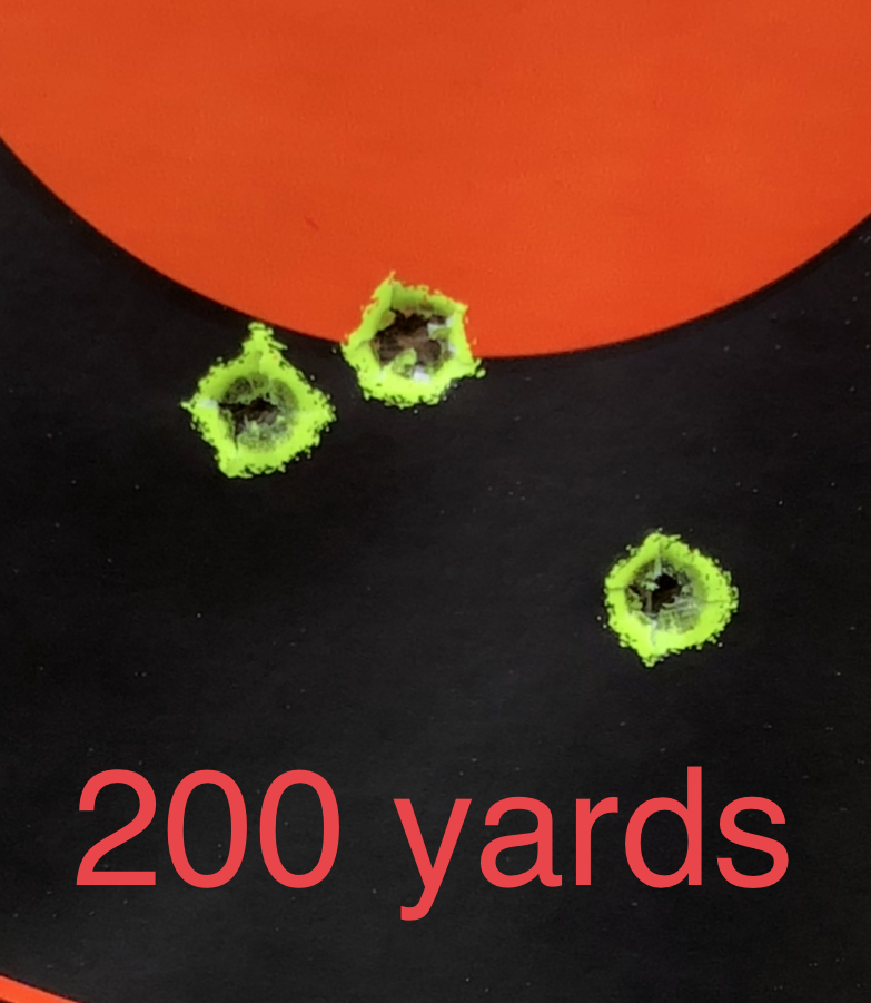

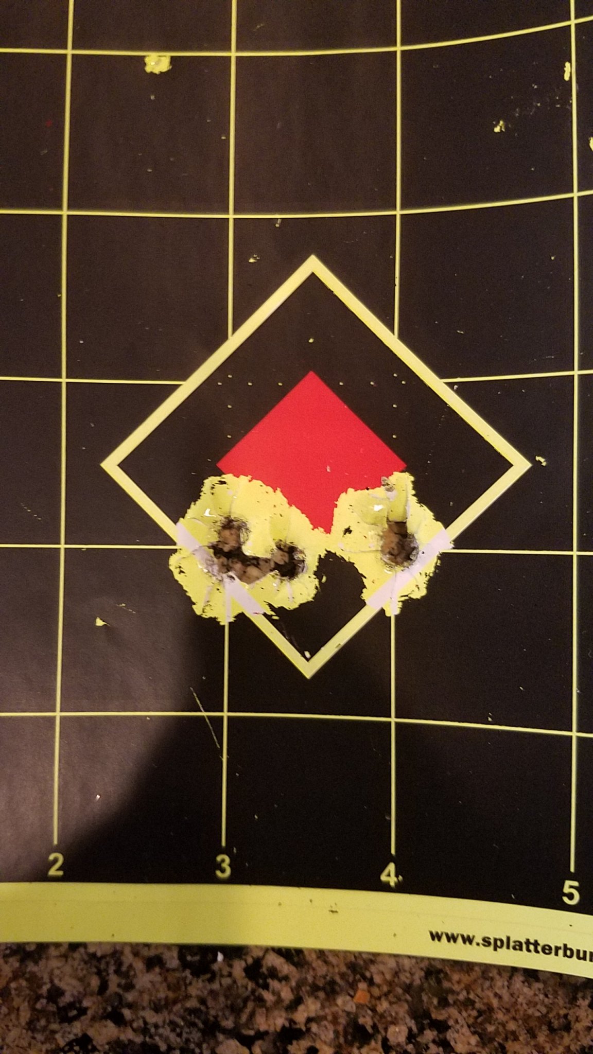

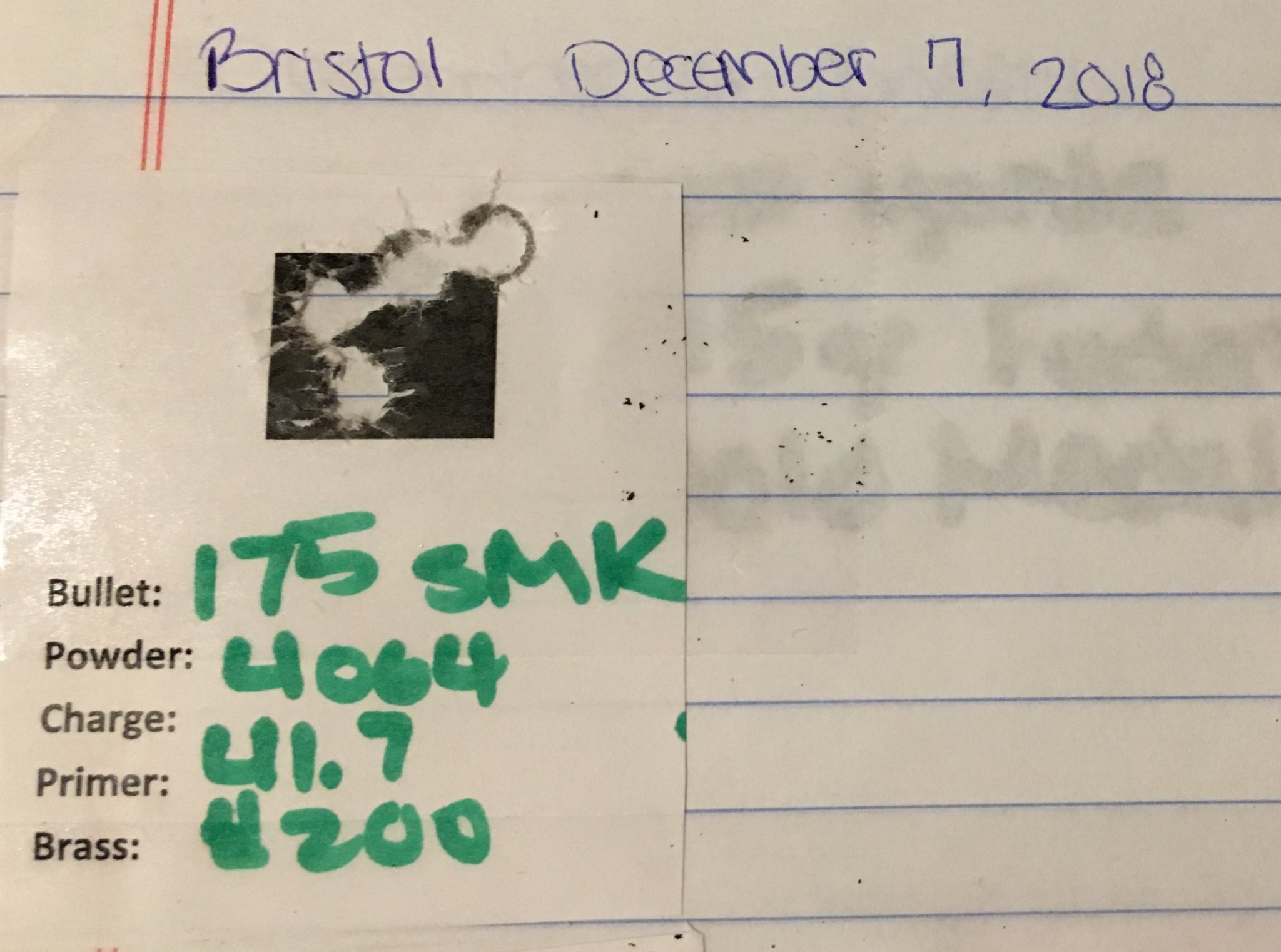

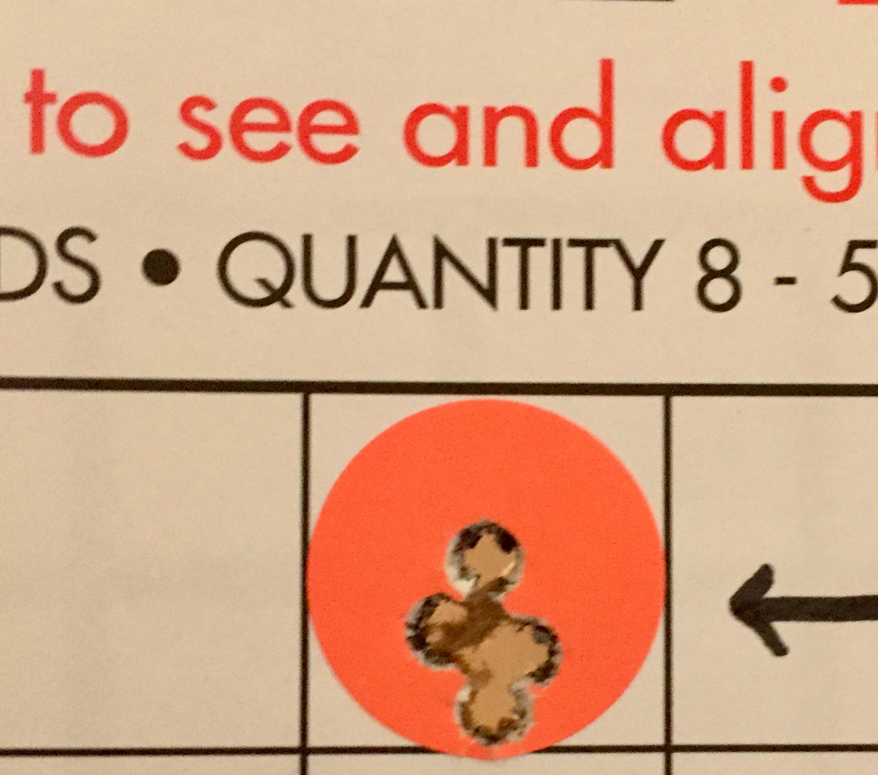

Here’s a 5 shot group at 100 yds from one of my home builds. Barrel is a white oak armament 18” 1:8 twist, Ammo was Magtech CBC 77 gr.
The shooter has a lot to do with it. That's why I think my groups will continue to shrink.

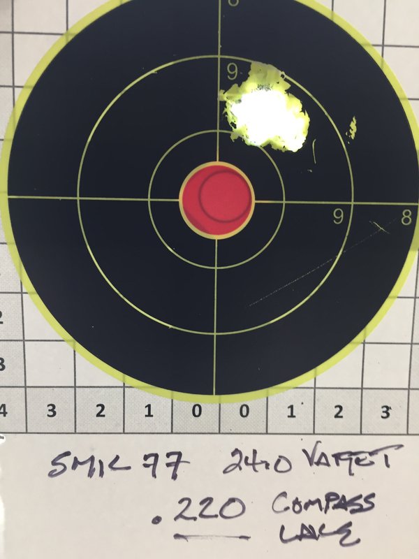

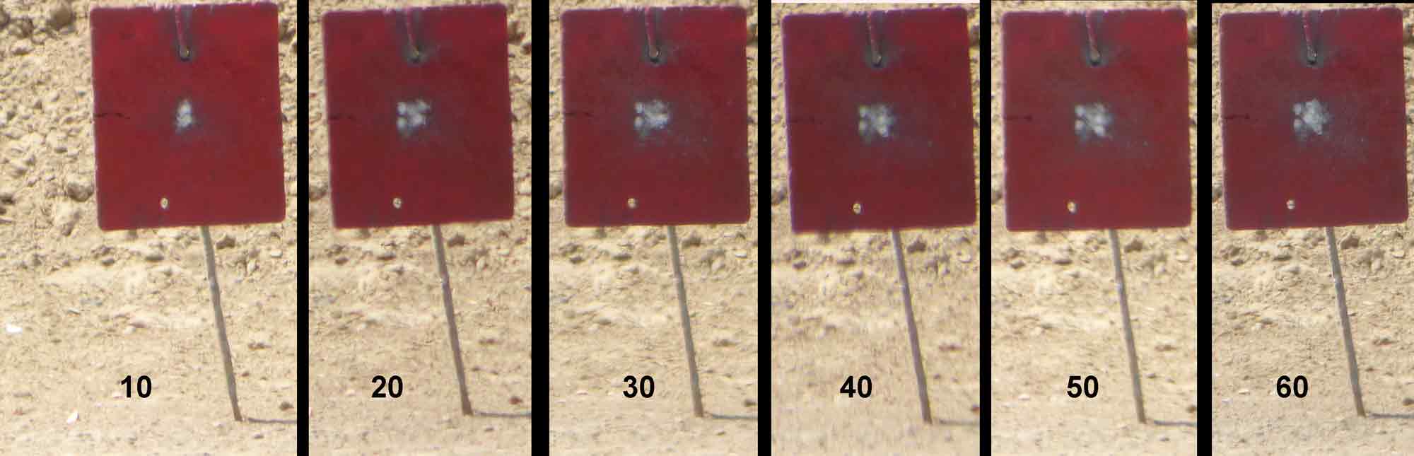

My 3,5,10 shot criteria, and you can add less than 1.5MOA for 60 shots (maybe 2MOA @600 for 60 shots) should be a minimum for anything that is not for house clearing or mag dumps.
Here's a practice 60 shots from 100y
Always end up with a couple fliers.

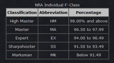

In F-T/R where you find alot of target AR's, very few AR's in F-Open, 60 shots in 1 MOA is in the 'pretty good shootin' category.
All shots in the 1 MOA ten ring.
All shots within 2 MOA gets you into the 90's. Even I can do that, if you exclude a few fliers :)

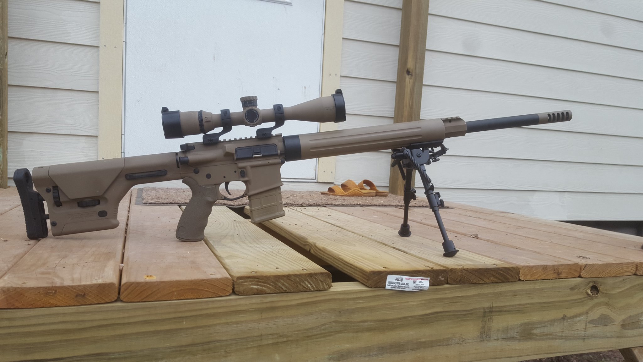

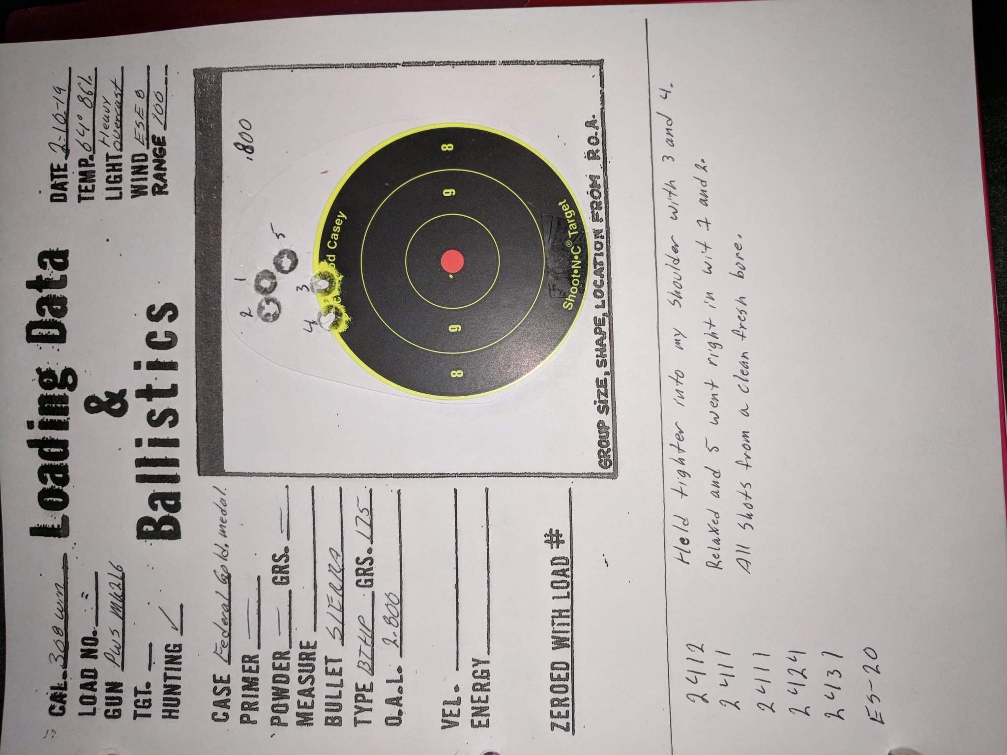

I dont own a bolt gun but Im thinking ill end up with an AI eventually. My first AR build was a 308
I havnt done very many group shots with it but most of the ones I have done have been moa or less. And this is with 175gr remanufactured ammo from freedom munitions. Im not sure the sd or velocity of this ammo bit im sure It would be a 1/2 to 5/8 moa shooter with reloads.
Those are the only groups ive shot with this rifle, im sure my groups would be better now since ive been shooting it more and working more on fundamentals. Those groups were shot a year ago.

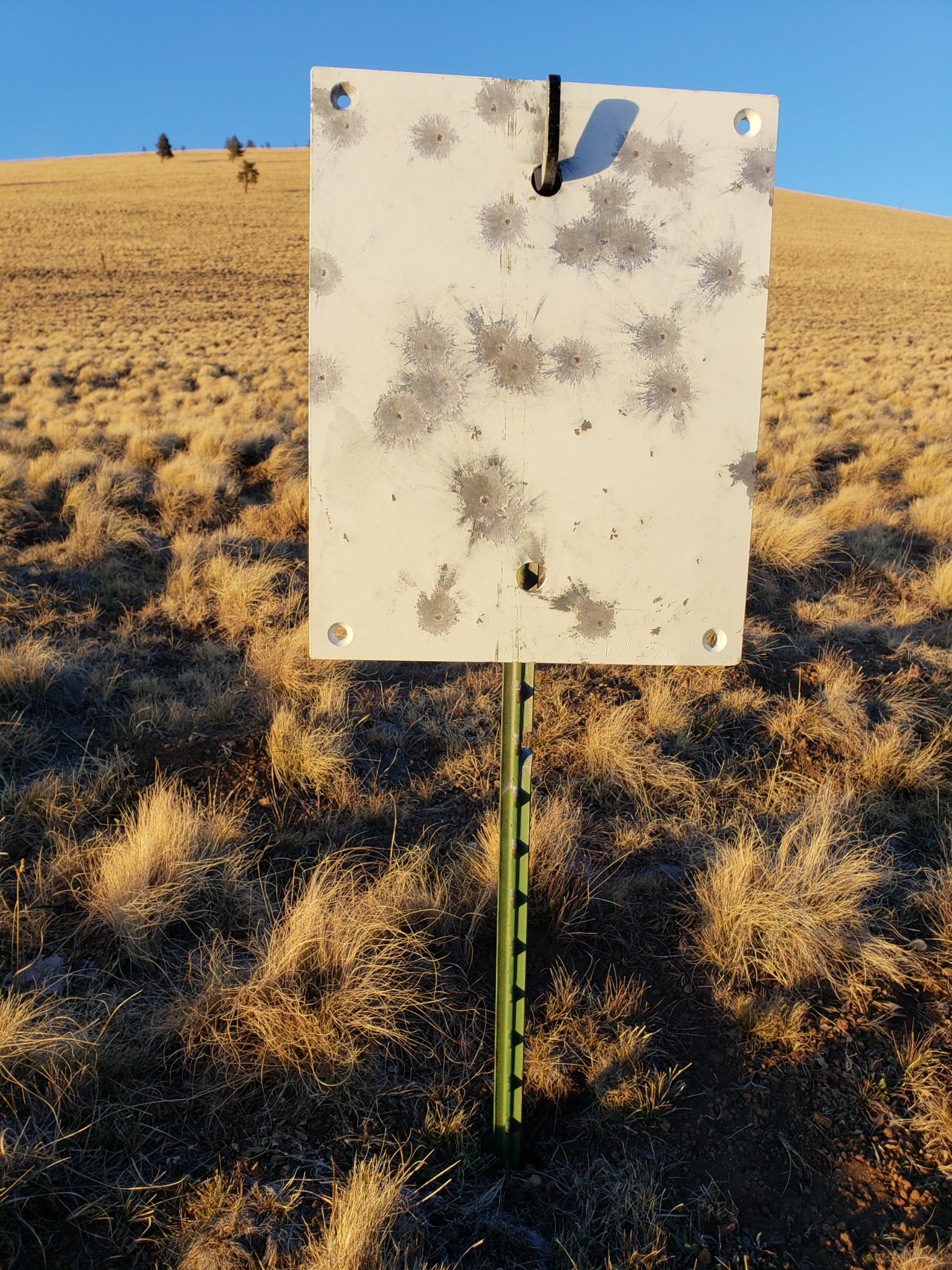

This plate was at 940. My wife amd I were both shooting it. The wind was from 8- oclock, 6-12 mph. This was my first time shooting out at this distance. Before this the furthest ive shot was 300 yards. Had a second round impact the plate is pretty big 15"x19". Even with 2 different shooters the impacts were in a general area. I havnt had a chance to true any software yet, at the time I shot this I didnt quite understand how all that works. Since listening to the podcast amd reading here I think I am getting it.
I just ordered some federal gold medal 175 which might shoot a little better. I think with more trigger time amd the right ammo this gun can hold sub moa.

I dont own a bolt gun but Im thinking ill end up with an AI eventually. My first AR build was a 308View attachment 7002814
I havnt done very many group shots with it but most of the ones I have done have been moa or less. And this is with 175gr remanufactured ammo from freedom munitions. Im not sure the sd or velocity of this ammo bit im sure It would be a 1/2 to 5/8 moa shooter with reloads.View attachment 7002816View attachment 7002817View attachment 7002818
Those are the only groups ive shot with this rifle, im sure my groups would be better now since ive been shooting it more and working more on fundamentals. Those groups were shot a year ago.View attachment 7002819

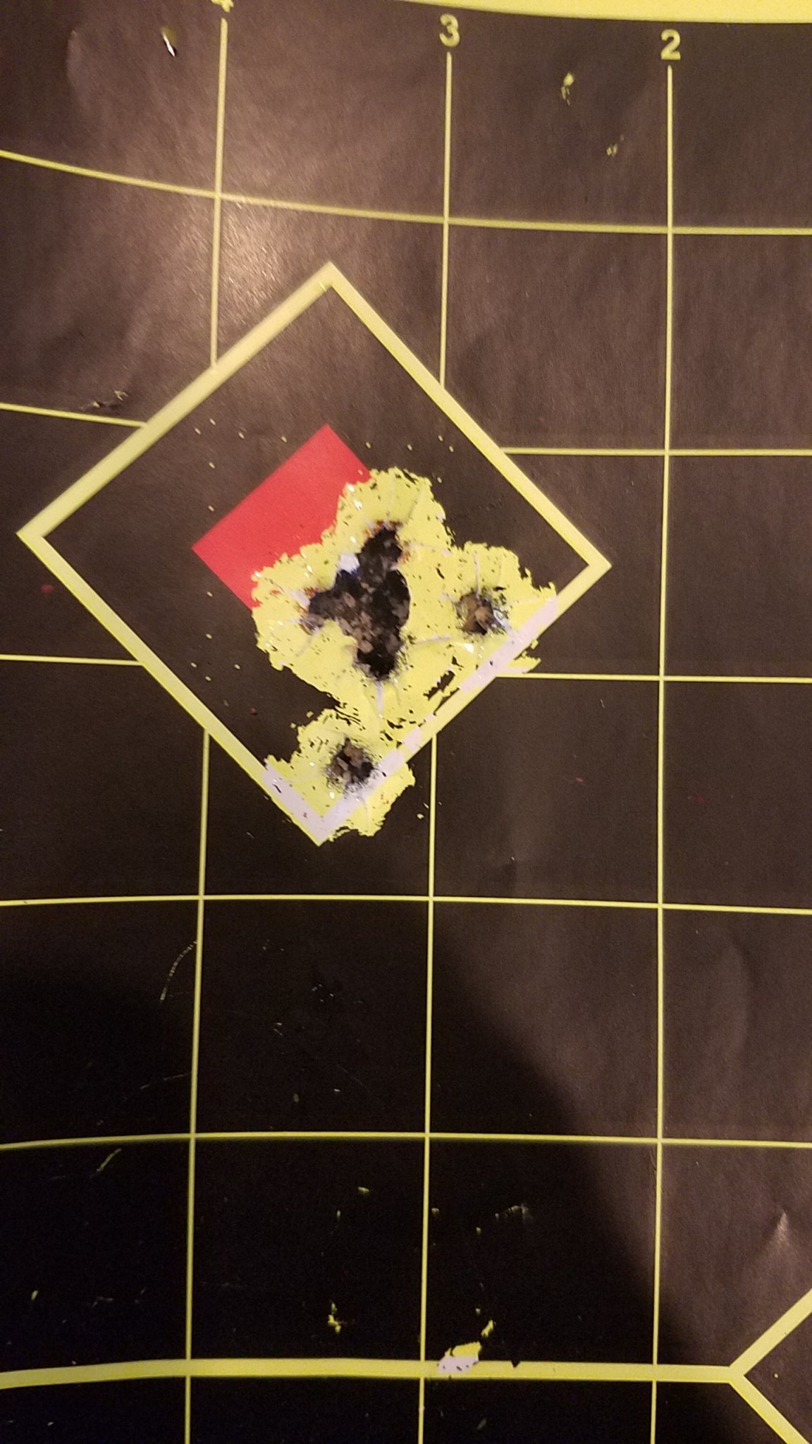

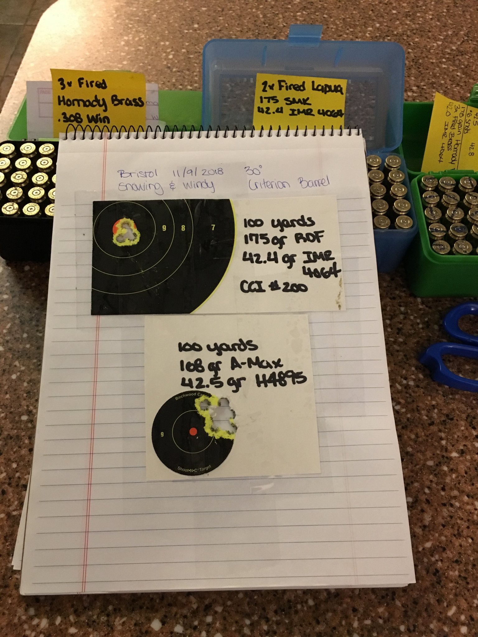

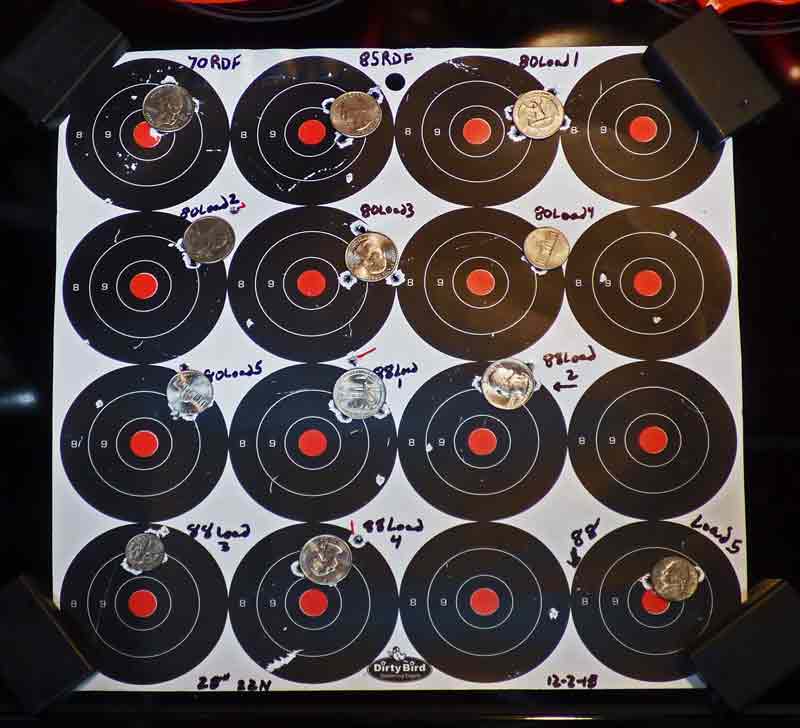

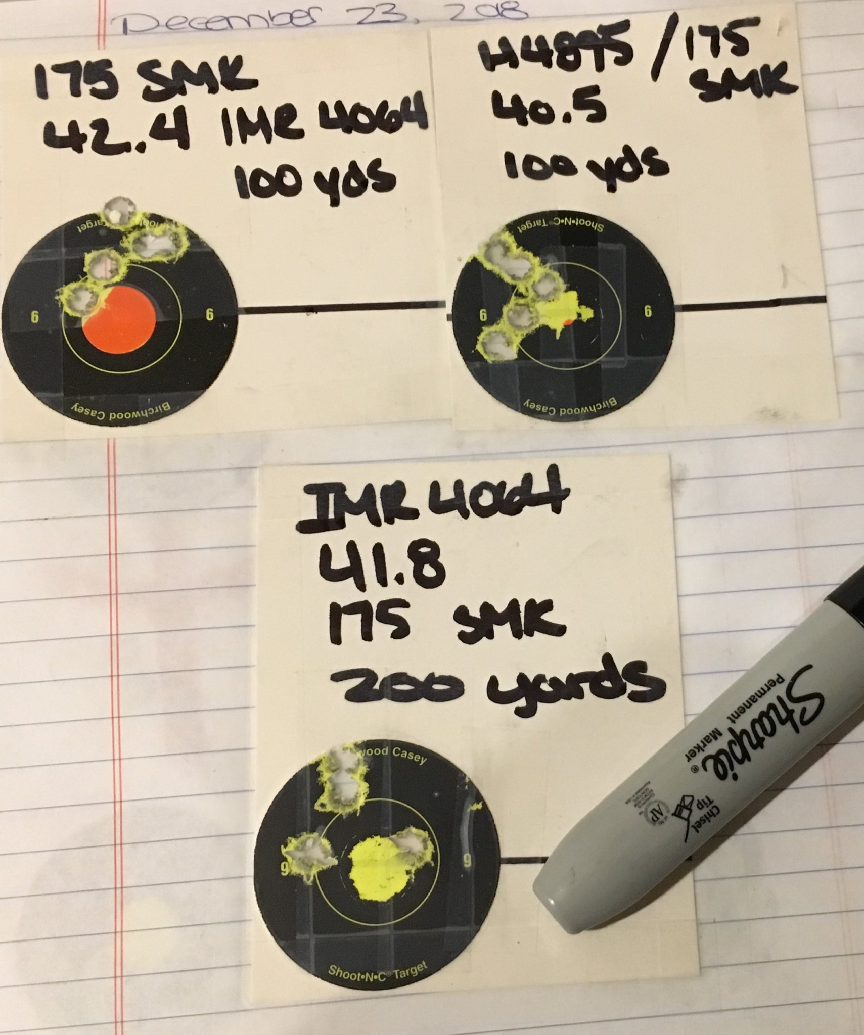

A few groups below from my load work ups... it’s a 24-inch Criterion Bull Barrel in 308 from Fulton Armory
Sometimes I can get a dime sized group, sometimes a nickel, and a bunch of quarter sized groups, at 100yd.
Sometimes not :(
These were different factory loads, and reloads.
Little black arrows are scope adjustments, red marks are groups (all 5 round) that exceeded 1.047" :)
No gas AR-15, 100 yds, bench.
Considering the scope adjustments to center up that's 60 shots in under 1.5 MOA but at only 100 yds.

After some frustration and lots of load development I settled with about 1/2 moa with my MK12 clone. It’s a CLE Douglas

This is true. I find it a lot harder to stay consistent with my my large frame AR than my ar15's.
As you can see in this target out of my PWS mk216 in 308. Applied a little more pressure against the stock on shots 4 and five and totally ruined what I had going. Relaxed on number 5 and it was up where it was supposed to be. Factory 175 gold medal.
These were fired one at a time after a thorough cleaning. Foulers for load development. I like to give every load I test the same chance.
