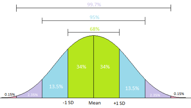

Based on a Gaussian distribution, +/-1 Standard Deviation statistically represents 64% of typical outcomes around the mean. +/- 2 standard deviations is 95% , +/- 3 standard deviations is 99.7%. I think what Secant said is important on sample size.
