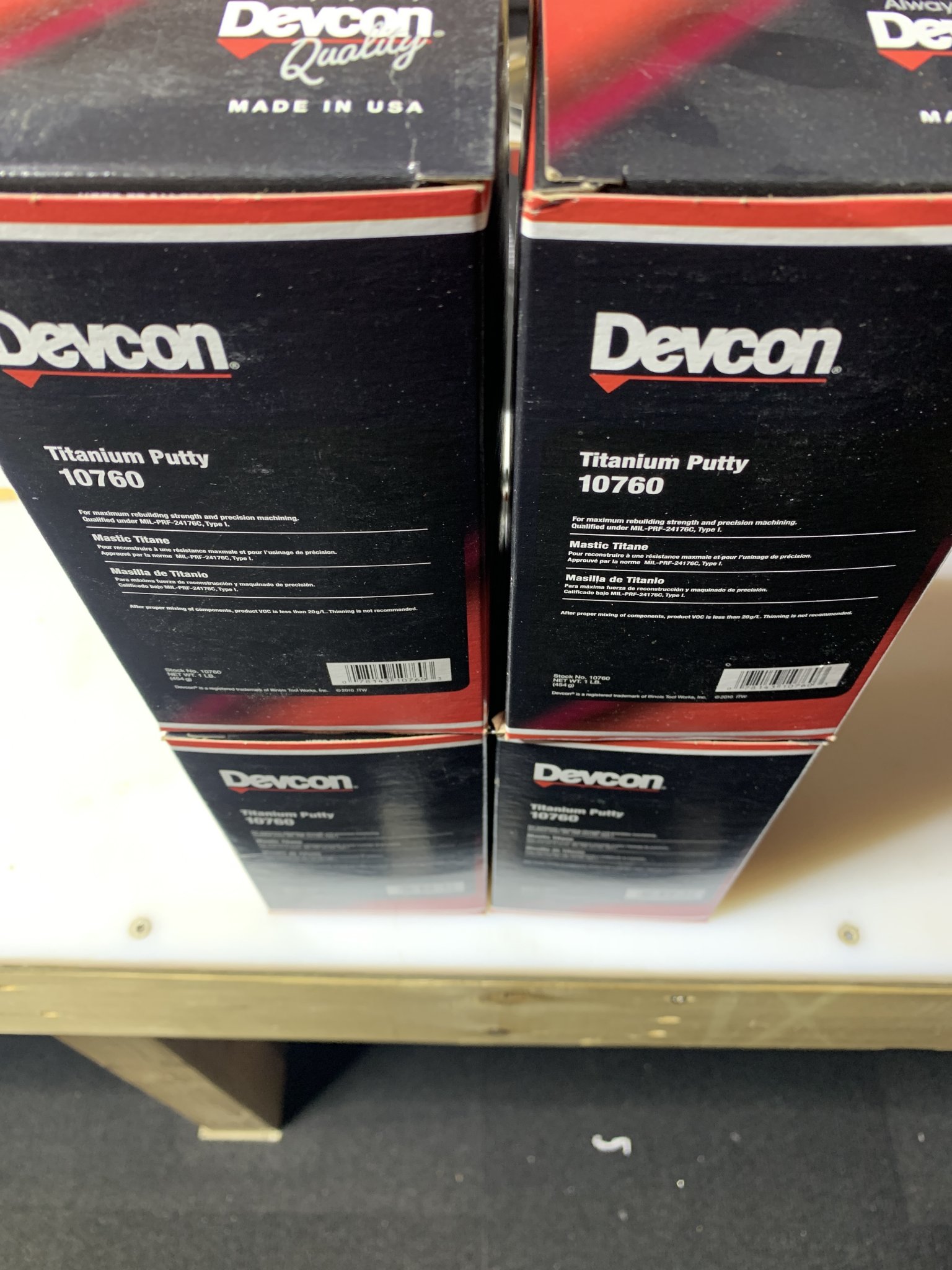

    Someone I came across that is my number one pick but extremely expensive if you have more than just one gun to do is Huntsman Araldite 2014 High-Temp Chemical-Proof Epoxy Gel. Nothing I've used finishes as nice as this stuff, it's extremely strong, very great to work with. While I find devcon to not shrink and give me nearly no deflection the araldite stuff is even better. Last time I ordered it I used Amazon and it's about $40 for a 2oz tube (ouch).
    Titanium Devcon with a Marine Tex coating is really strong, water proof and appealing to look at.
