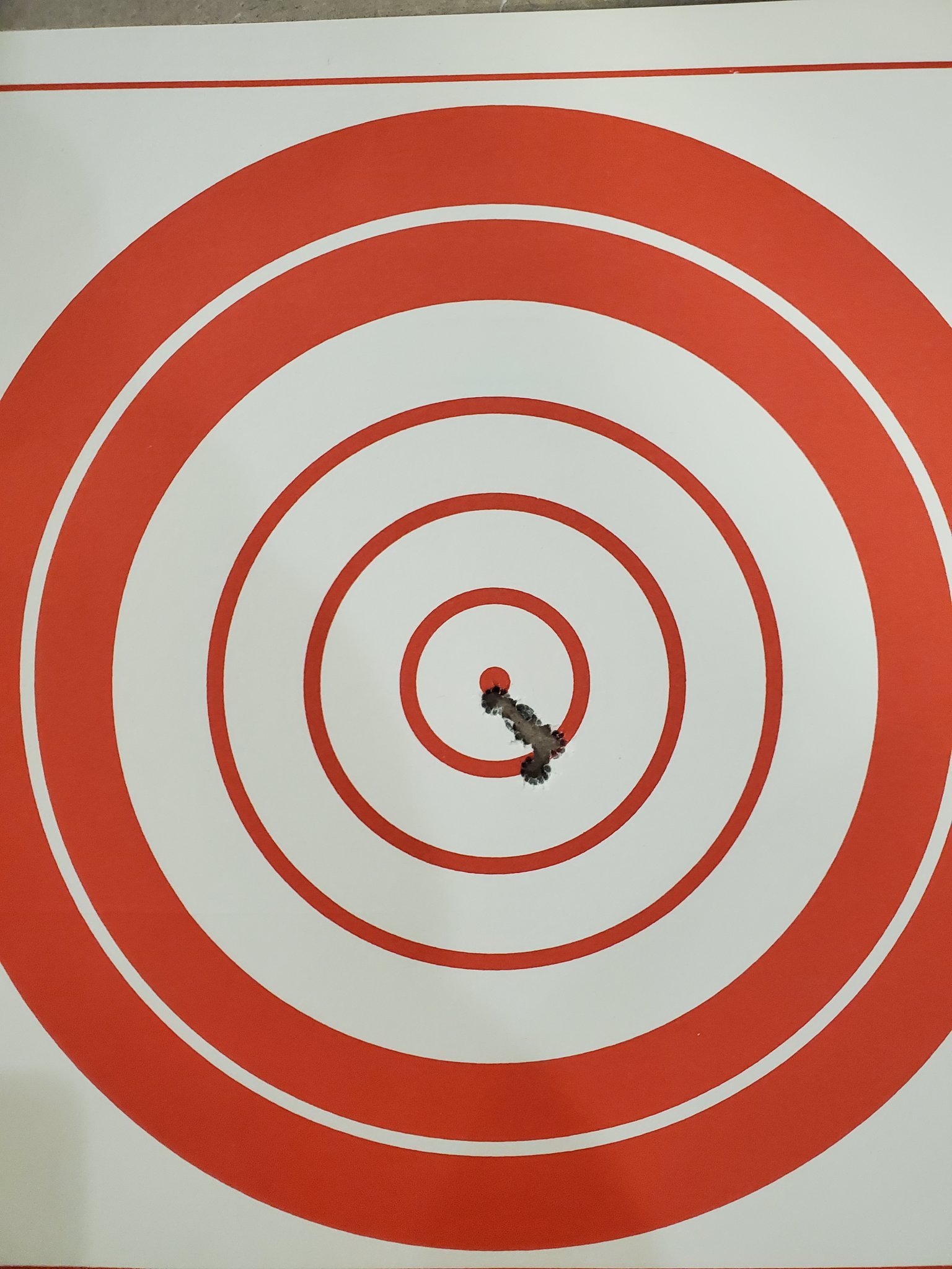

That F*** Varget worked pretty good tonight....
Distance: 250
