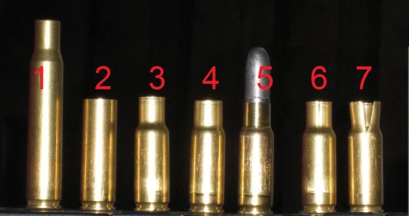

So far so good. I figured that the brass was not springing back so much and the bottom of the uncut neck was a bit wider due to the gradually thickening brass of the brass body. The 7mm BR brass has about a .007" neck wall and my turned brass is about .009 to chamber in the SSK barrel. I annealed (lead dip) after turning.
I have yet to see how it shoots. I will be trying bullseye powder with the jacketed loads and will stick with WC820 for the cast.
1. 30-06
2. Cut down 1.480"
3. Sized with expander removed
4. Expanded
5. Neck turned from .020" to .009" and loaded with 305 grain cast from NEI mold
6. Some brass wrinkles when sized down
7. Some brass splits when expanding
Ranb
