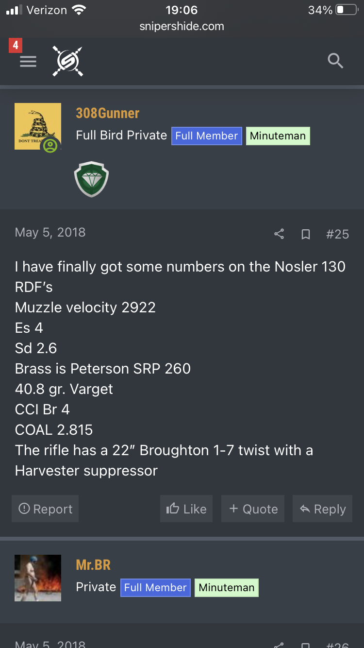

Back when I strictly ran the master race cartridge I started running a extra long throat version the get better really long range performance with 147’s and better utilization of the now common 2.96 capable magazines.
I was easily able to get 147’s at a bit over 2800 without wrecking brass with regular powders, possibly more with R26 but I save that for my 7 saum.
So I guess it was kinda a +p reamer.
Now that my 260 isn’t doing ELR duties I just shoot 130’s at a fairly mild 2900ish and it shoots like a pussycat.

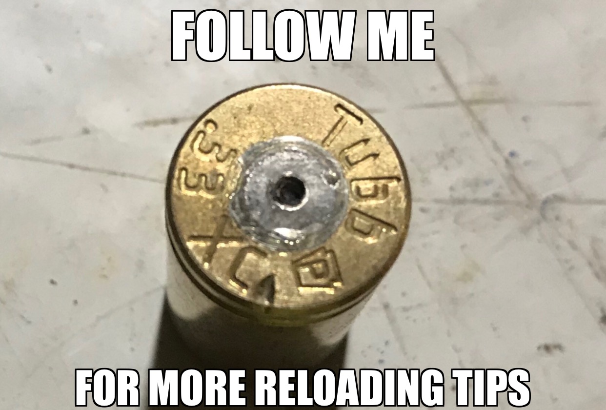

Once your primers start to look like that I recommend starting to move up by .5 grains instead of the usual 1- because you are getting close to the ceiling!
Right? On Snipers Hide, if you aint at 80k psi, you aint trying hard enough.
I usually don’t step on my loads too hard because I like brass life but I’ve had my 338 edge gassed up to 3100 with 285 solids and primers still didn’t blow or fall out.
2-3 loads of that will kill a case but the ballistics are quite impressive.
Im surprised that primer in the meme you posted turned perfectly to jelly without enlarging the pocket and blowing the whole mess out. Thats a very fine line. Lol
That was a SH member and that brass was smoked on the first shot.
I’m also Impressed, I have a few pieces of that brass and it’s 4 thou over maximum large rifle primer specs according to my pin gauges.
Reactions: Supersubes
