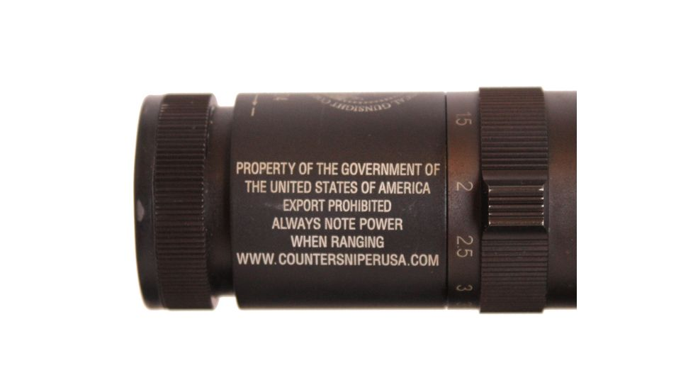

Run a "CounterSniper"
They were a mil contract over run scope. Export may be limited but the only way to get one is through import...
I think they had both a MIL and an MOA reticle in there.
They can survive being shot by someone you are standing on top of....
Im joking......kind of.
