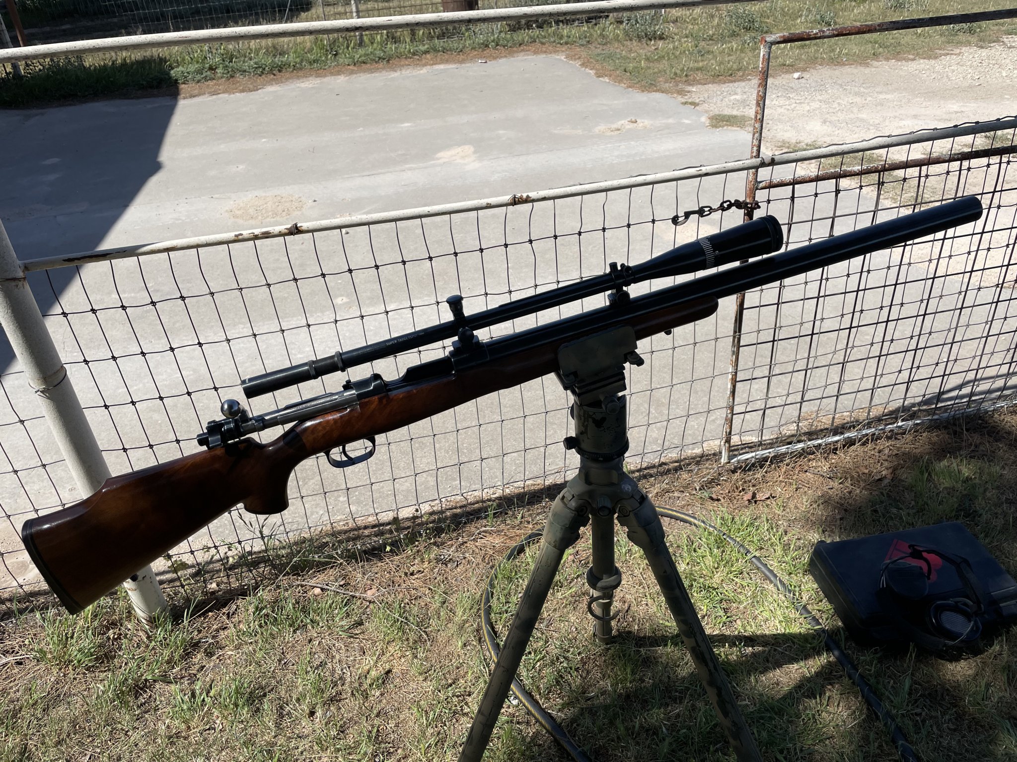

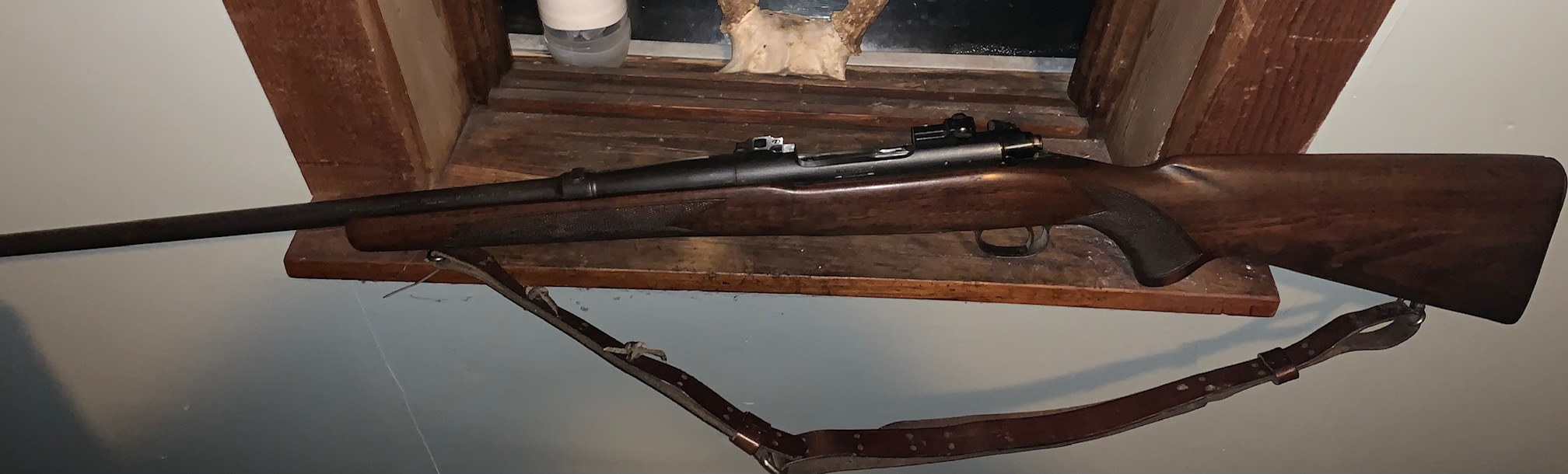

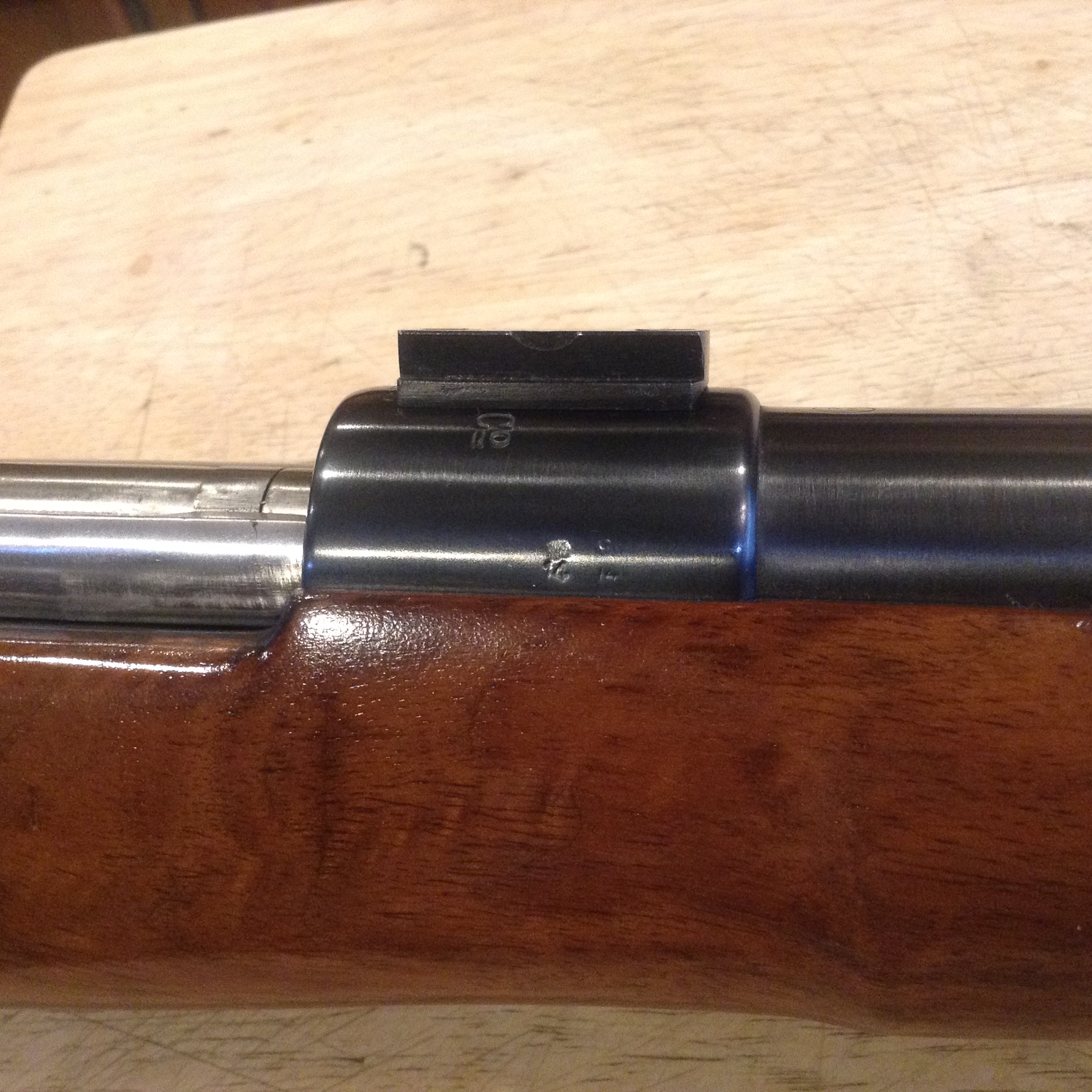

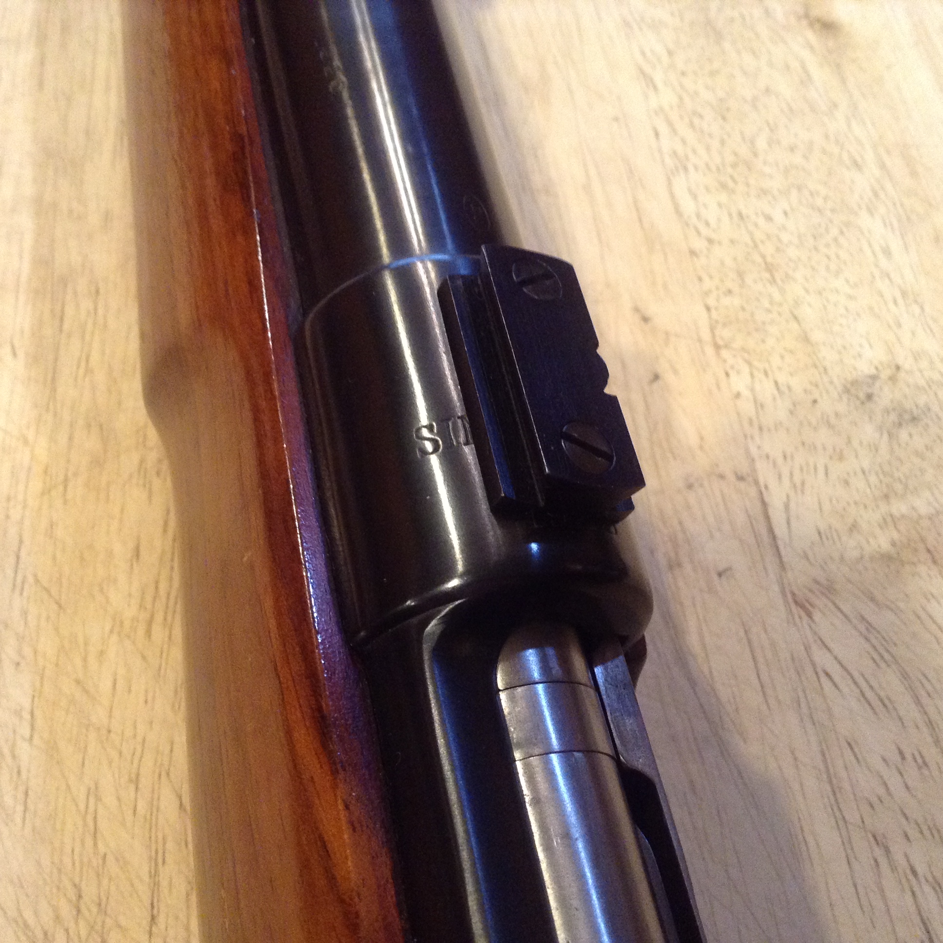

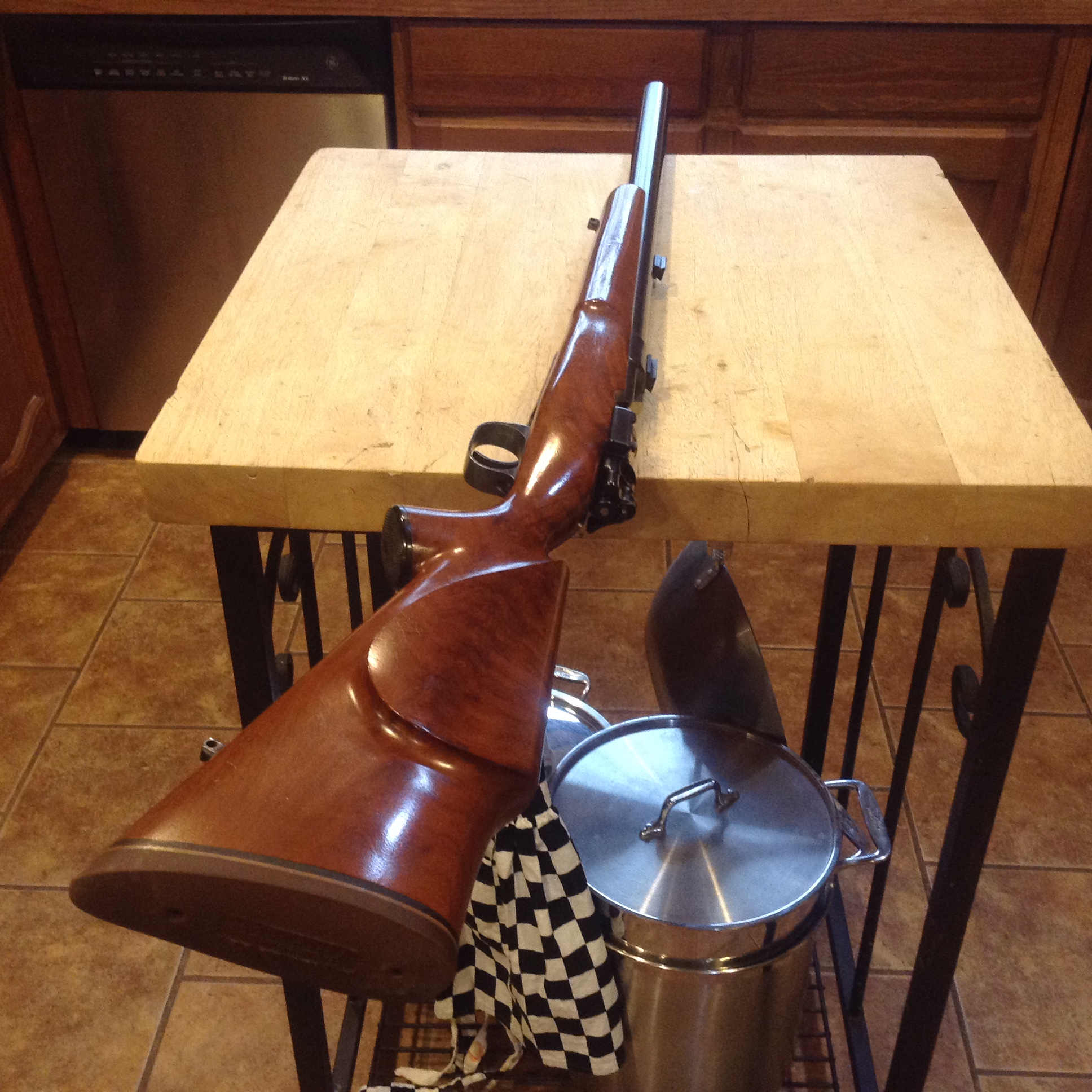

Alright guys, I know some of you might really like this. Eh hem, @sirhrmechanic
I got this rifle a couple years back. It was attached to a scope found on a consignment rack in Concord, NC. A USMC SNIPER 8X Unertl was on this rifle... all for the hefty price of $1500! So, now I have this rifle and would like to know something about it.
It's some kind of Mauser action and I'm wondering if it's a commercial action as the markings don't look military to me. I've tried to capture what can be seen as it sits. Will take the rear scope block off for a better view.
It's very nicely done. Fully bedded all the way to the fore end tip. Barrel is 1.25" the whole way out. Really nice polished blue and a pretty nice piece of wood. I'm guessing it was someone's varmint or BR gun....
Pics on the way.

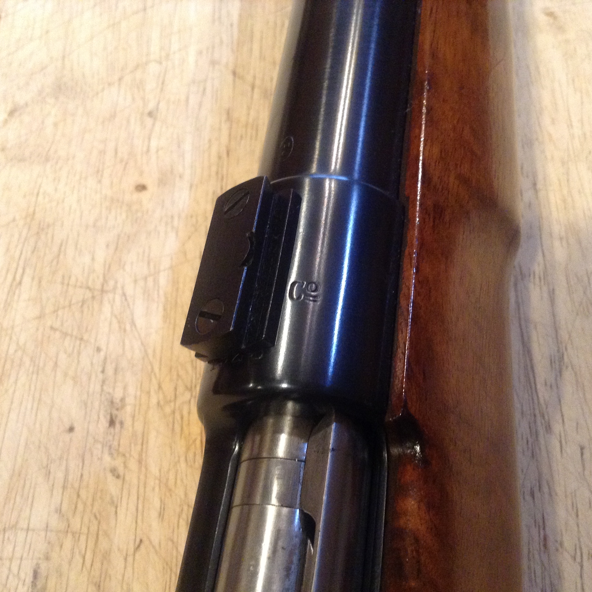

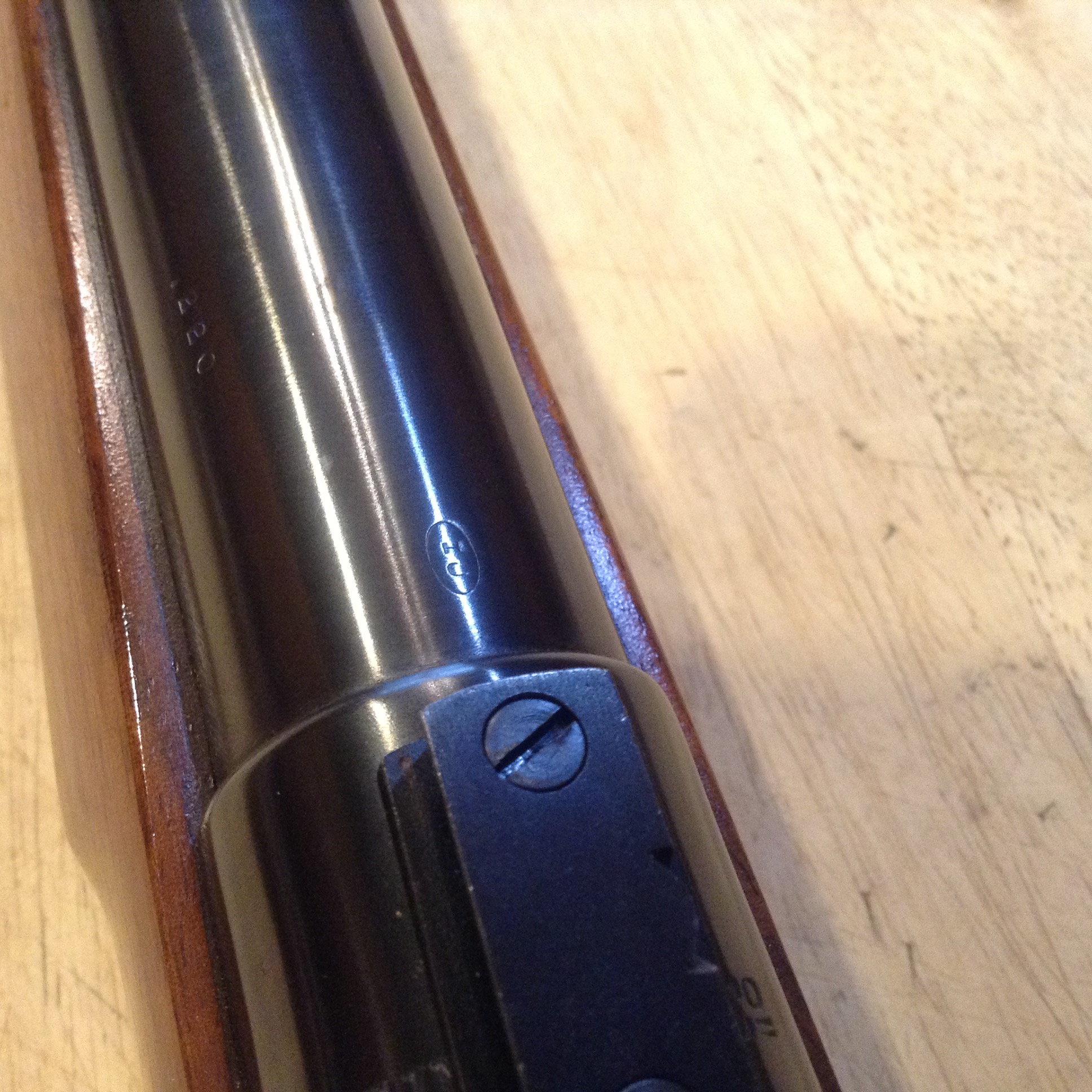

I'd like to figure out who built this thing... That faint stamp on the top of the barrel looks like an "HC" inside a little oval.

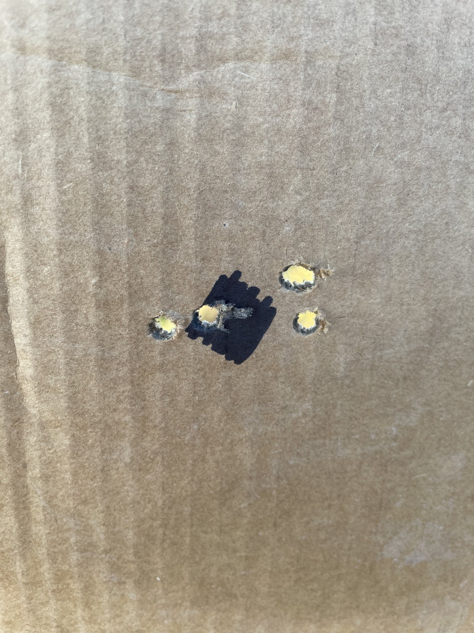

Might as well shoot this some. It's not like we don't have plenty of jackrabbits around here. Needs a good trigger though.

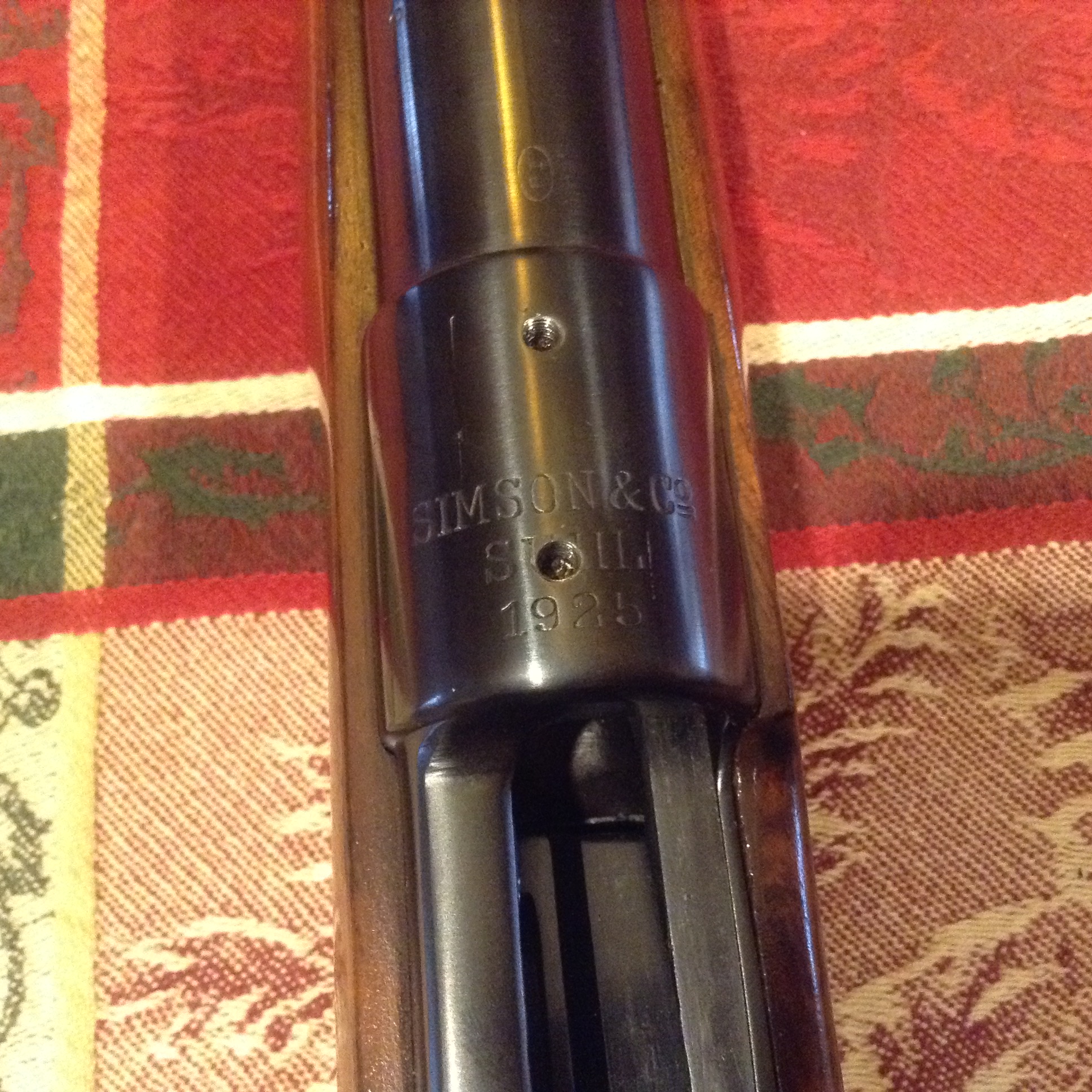

Action appears to be pre war commercial action. Simpson was well regarded in that era. Like Krieghoff, Sauer, Hanel or Oberndorf.
Very good action.
Interwar commercial action. Mount hole drilled through the roll stamping.
Looks like a 1960s Varmint build. Well done. Shoot the snot out of it! I bet it’s a tack driver. 220 swift was a 4000+ FPS cartridge. Way better than 22/250 and got a Ill-deserved reputation for burning barrels.
With sane loading it far out-performs most .22 center fires on both ballistics and barrel life.
But loaded hot, nothing touches it!

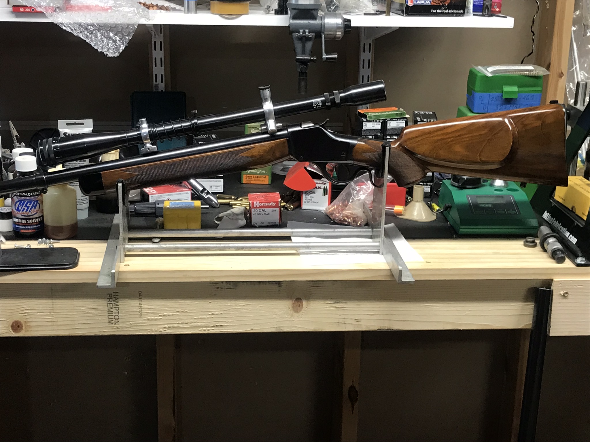

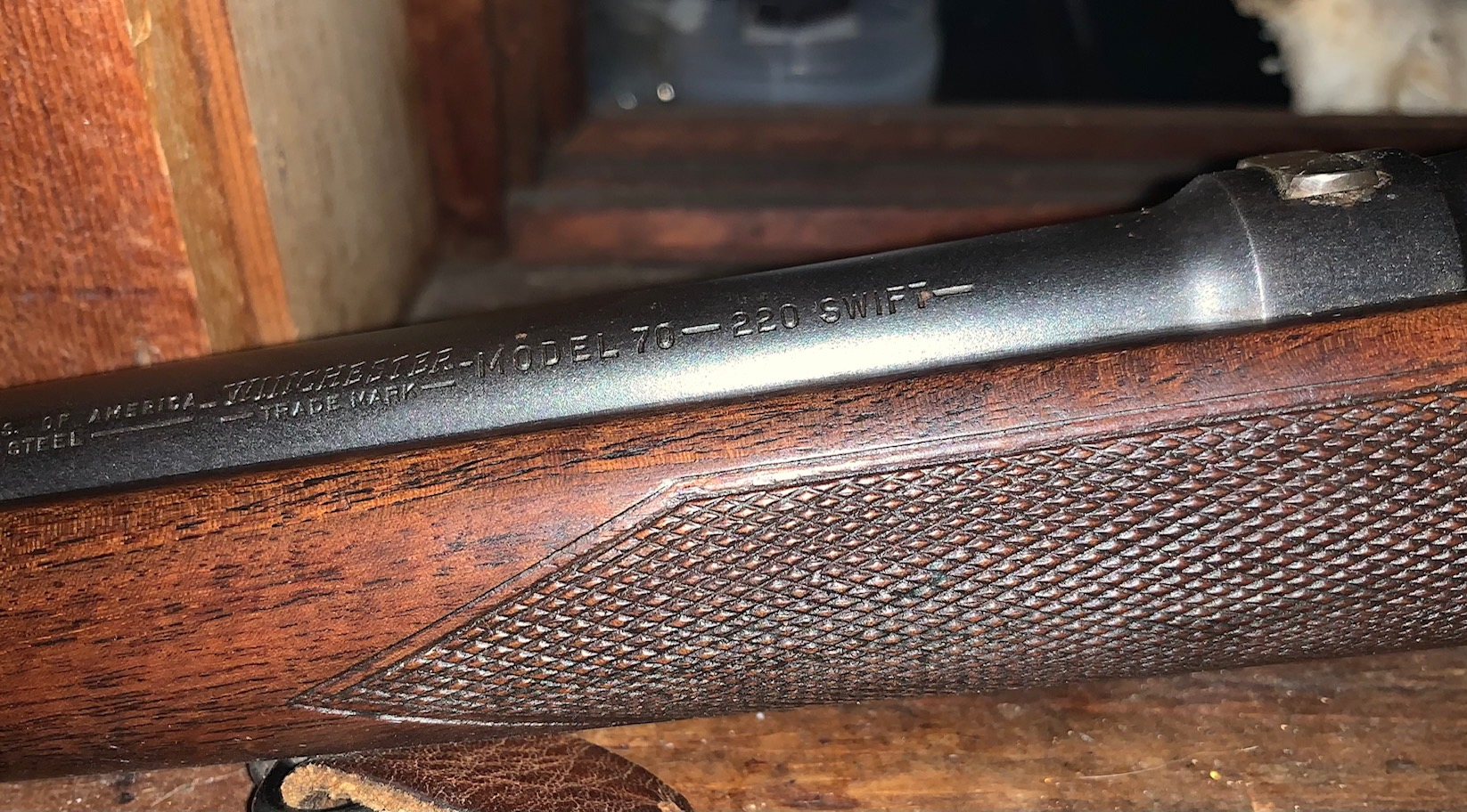

My only .220 Swift. Pre-64 Winchester. About 1,000 rounds through it. But I don't push 4,000 FPS, even though capable.
Used to wear a Unertl Varmint, but a friend had to have that scope and I have not re-scoped it yet. I want another Unertl Varmint... But they have gotten spendy! My Model 52 Target has a Litschert sport-spot which I love. But the bases are much further apart on the 52.
Made in 1950... when the Rifleman's Rifle was still king!
And just in case anyone is wondering if I have any experience in high-velocities, here's the .14 Eichelberger I built on a PacNor barrel and a Tikka Action. KRG Stock and US Optics scope with a Sphur mount and Atlas bipod. All built with input from some great friends here on SH! 12 grain bullet at 4200 +- fps. Pardon the lousy photo. I think there is a thread about it somewhere here.
Of course, this doesn't begin to touch some of the stuff we built at GD with multiple-stepped charges and hyper velocity projectiles pushing 10K FPS...
Meh, what do I know. I only have one .220 Swift.
Cheers,
Sirhr

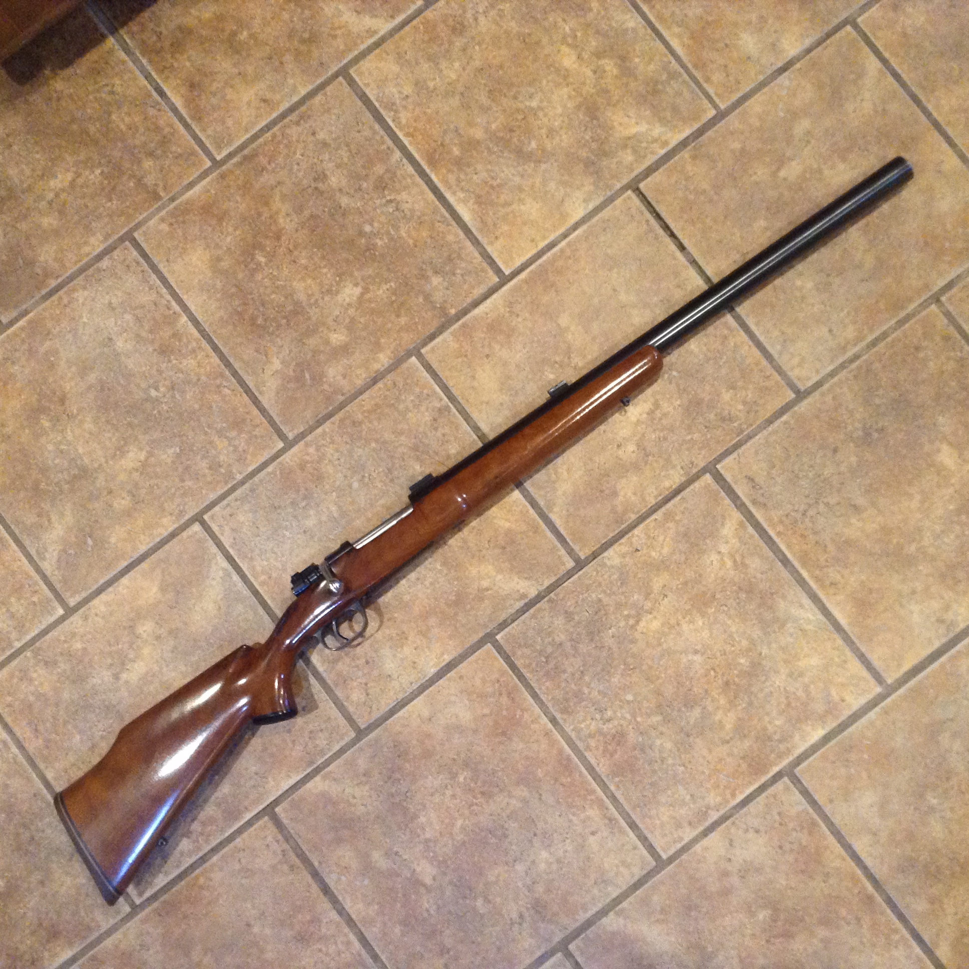

Bought my first 220 Swift in 1973 in a Ruger M77. Great rifle but sold it in college when I needed some money and regretted doing so ever since. A number of years ago I picked up a No. 1V in same caliber and eventually wore out the barrel. Robert Gradous rebarreled it with Krieger and had custom mounts made by D'Arcy Echols. It was one of Robert's last builds and did a beautiful job.
Pictures, please? Ruger no. 1's are always beautiful. That I don't have one yet is an oversight I need to correct. And a .220 would be a wonderful cartridge to have on a No. 1 platform!
Sirhr

I would agree that your M98 is from the sixties based on it's stock shape. Whoever had it build had very good taste. The Pachmayer white-line butt-plate might help ID the period. Simson Suhl is not just action maker but a highly accomplished gun maker that is better known for it's shotguns and drillings than it is known for it's 1925 pattern K98s. If you search Simson Suhl 1925 Mauser model 98 you will find a wealth of info.
Looking at the pics. you've posted it appears that the stock has a shadow line cheek piece. That is a refinement that has no function other than to reveal the stockmaker's skill or the the owners good taste when he placed the order. I would be very surprised if the trigger on the rifle was not upgraded when the rifle was built into its current configuration.
I know the target in the purchase was the Unertl but you won the daily double. Along with the 8X you got an outstanding example of a 60's era varminter. Looking at the overall condition of the rifle I'd bet when you scope the leade of the barrel that it shows minimal wear. Whatever you find let us know.
Look at that stock pic again, it is actually a groove around the cheekpiece.
I cannot remember seeing that approach before but I wonder if you can call it a shadow line in a traditional sense.
None the less the overall stock seems better than average for a chuck rifle of the period.

As for this rifle, several things.... I think the trigger is pretty standard, military-like, two stage. Nice and smooth, not too heavy, but definitely has some travel.
The cheek of the stock does not have a line underneath (if that's what was being discussed/questioned), it has a smooth radius on the bottom where it blends back into the butt.
And, most interesting, I guess, I think I've figured out why it looks so brand new! I found a 220Swift headspace "GO" gauge and the bolt will not close on it! Definitely short in the chamber. Not sure what to make of that... Seems odd that someone would put so much work into the rifle and not make sure the headspace was just right. Or, is this an attempt to have a tight "match" chamber?
As tight as it seems to be, I have my doubts as to whether or not the bolt will close on factory ammo. I guess we shall see.
The barrel is simply marked ".220" and nothing else. I'm not missing something with the caliber, am I? Any such thing as a short version of the Swift or anything like that I might not be considering????
Might try making a casting of the chamber and measuring it.
https://www.brownells.com/gunsmith-.../cerrosafe-chamber-casting-alloy-prod384.aspx
If it's not a Swift, it's something very similar. The bolt falls to about 60deg and stops. It doesn't have far to go to close on the gauge.

I think Sirhr is gonna hook me up with some!
I wonder if it was one of those rifles where the guy had everything, but got a short-chambered barrel? All that needs doing is run the finish reamer in .050"? Possible setback as well. As noted .220 Swifts were "barrel burners". But, many people I know set them back a number of times.
Well, after months of sitting on the ammo that Sirhr sent me, I finally got a day to fire this rifle.
Three 3-round groups on the two diamonds. Shoots pretty damn well!
