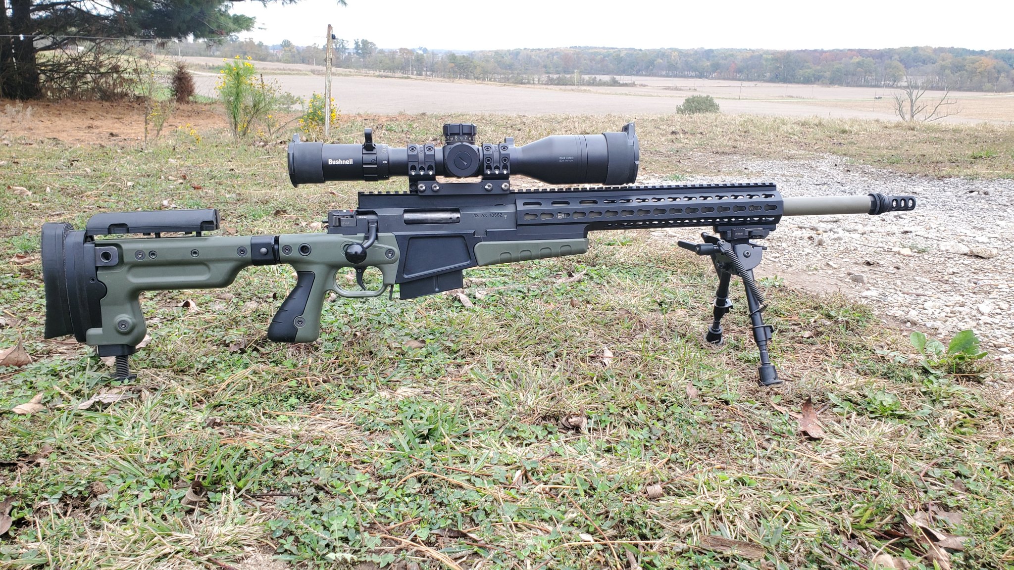

Yeah. That looks like it came off an AIAX/MC. Especially considering it has that weird rough looking material on the plate.
I’m making this estimation off the fact that both of my AX chassis’s on my vudoo and impact look just like that

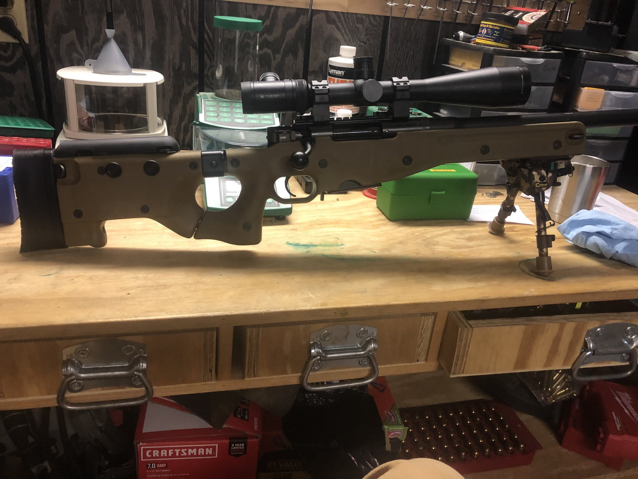

This is the rifle. So I’m guessing they just used it as a spacer. Seems to me with a little ingenuity I could make this adjustable up and down and rotate.

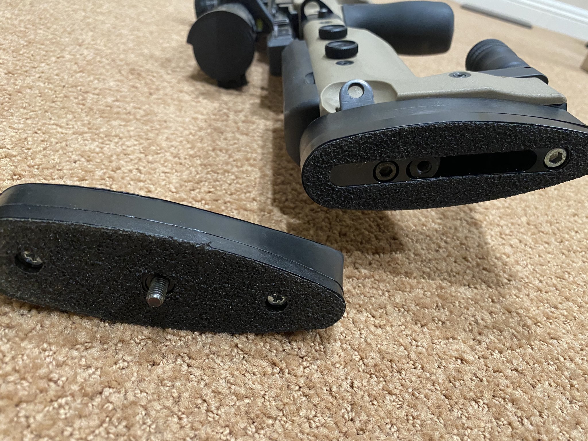

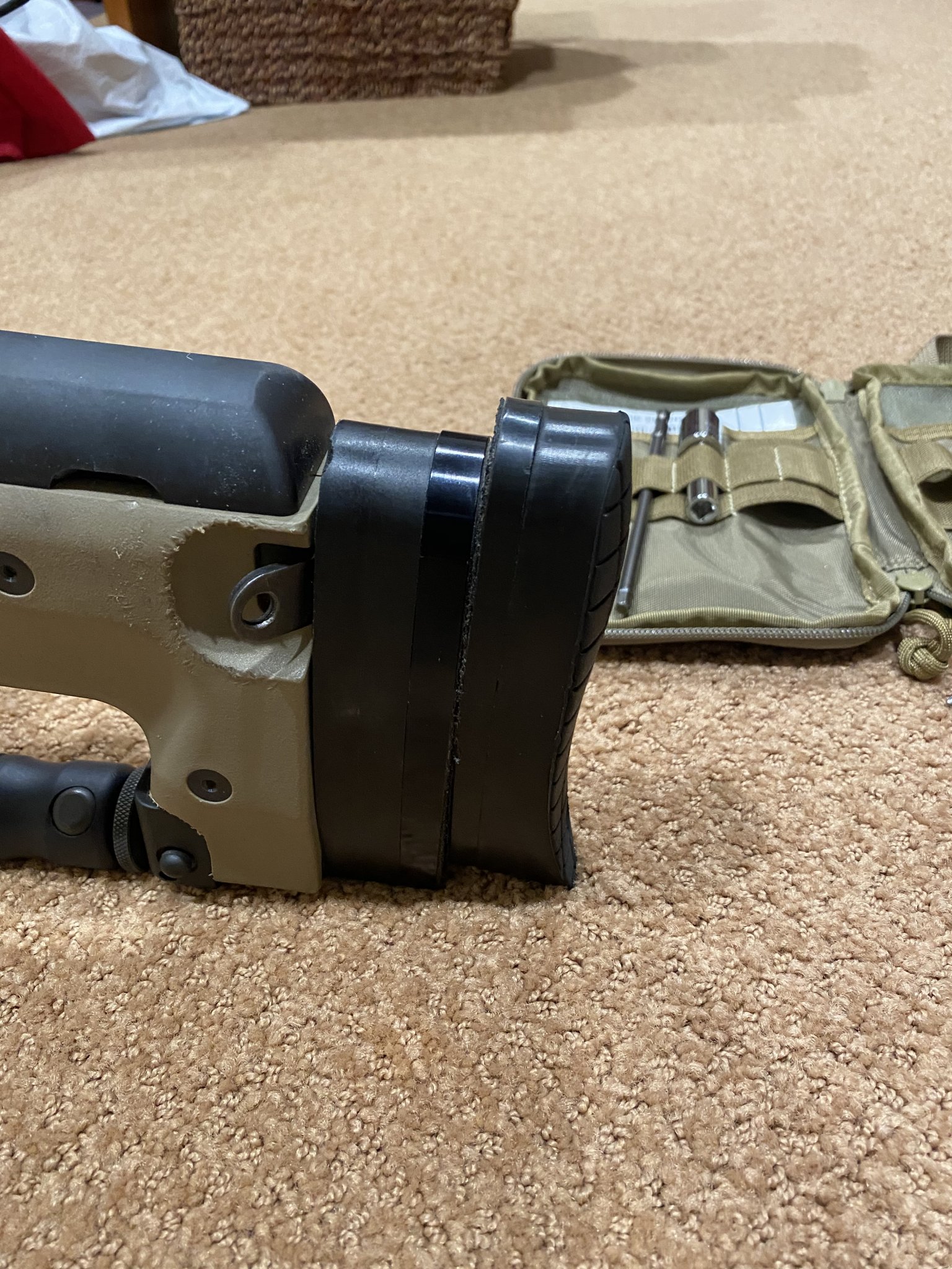

That is the adjustable buttplate spacer that bolts to the stock side of the AI. The rubber buttplate then bolts to the sliding stud in the middle and can be adjusted for height and tilt. Here's pictures from my AI AW of similar vintage. the first picture is of the parts. The part you have bolts to the rifle stock and through any length of pull spacers that you might have on the rifle. The buttplate then bolts to the adjustable spacer like the 2nd picture here.
Reactions: clcustom1911
That is the adjustable buttplate spacer that bolts to the stock side of the AI. The rubber buttplate then bolts to the sliding stud in the middle and can be adjusted for height and tilt. Here's pictures from my AI AW of similar vintage. the first picture is of the parts. The part you have bolts to the rifle stock and through any length of pull spacers that you might have on the rifle. The buttplate then bolts to the adjustable spacer like the 2nd picture here.View attachment 7457901View attachment 7457906

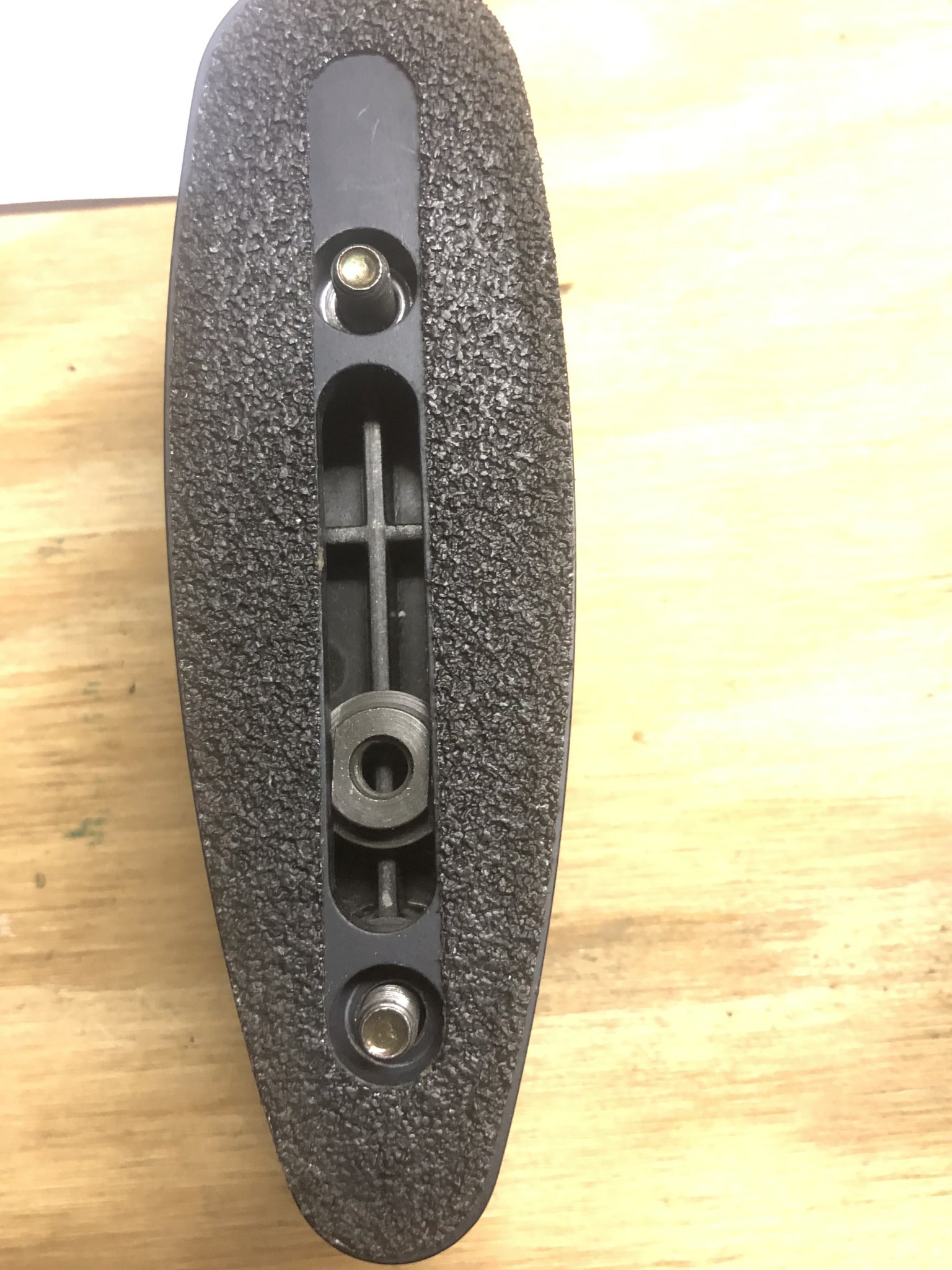

The rubber butt plate is special too. The one that is need for your adj plate has metal inserts in backside of rubber, that Phillips head screw screw into. Probably have to call Aina directly to see if the butt pad side of adj target butt is available separately. They only go up .4", so its not a lot, they do allow rotation and quite a bit of drop. Honestly, ive never needed it on my ae mk2/3. I did put one on my ax, just because the scope is mounted higher(due to tube forend)

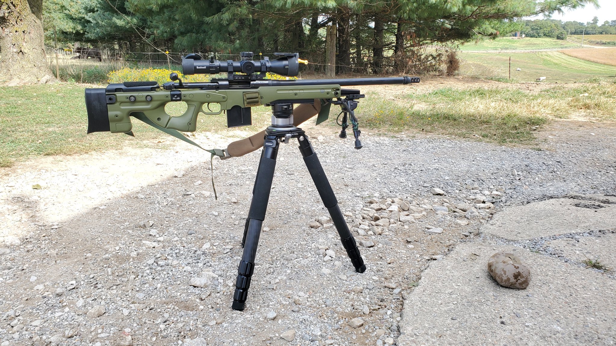

Fully raised target butt on mk1 ax
Top of butt pad is about same distance to top of cheek piece, with standard plate on mk2.

You posted a photo of your rifle- are you sure the rubber butt pad on your rifle doesn't come off by loosening an Allen wrench bolt in the middle of the pad? If it does, then the spacer in your first photo goes between the rubber butt pad and the plastic length of pull spacers.
