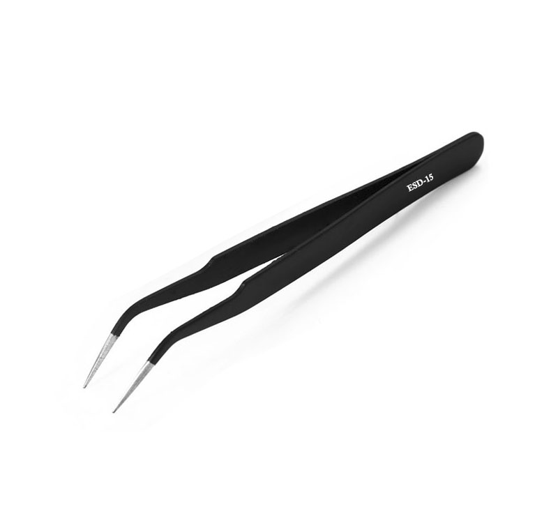

it counts the grains of powder one at a time or it gets the hose again , count them one at a time :cry:
