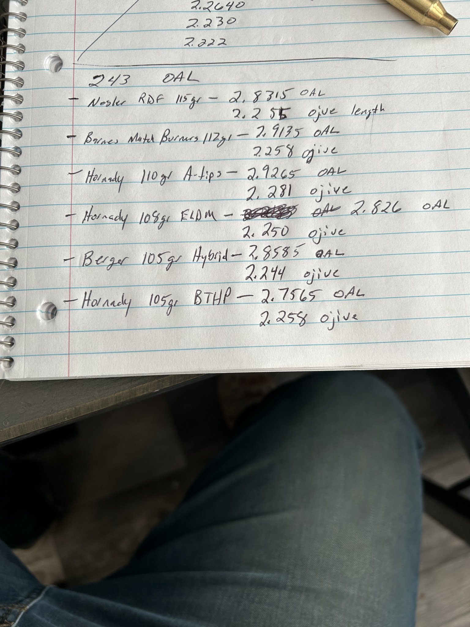

Thank you again for everyone’s thoughts and suggestions, I greatly appreciate it. Unfortunately for the last 2 years life happened and I wasn’t able to reload anything. The last 2 months I’ve been at the bench trying to reload and come up with a game plan. I reloaded 60 pieces of 243 brass in various loads and charge weights with H4350.
Nosler RDF 115 gr
Barnes Match Burner 112gr
Hornady A-tip 110gr
Hornady ELD-M 108 gr
Hornady BTHP 105 gr
Berger Hybrid Target 105 gr
For each bullet, I reloaded 10 rounds and varied my charge weight between 38.6-41.5 grains depending on what my reloading manual said for that particular round. And went up in .2 grain increments. Some rounds I have multiples of loads I think and hope will be best.
Unfortunately, I’m a big dummy and didn’t realize that I could load a longer OAL than my reloading manual said. So with that being said, the rounds I loaded up are just going to be used for a ladder test for velocity.
After talking with one of my buddies, I realized my mistake with the OAL gauge. I re-measured each bullet with my OAL gauge and came up with these numbers. Does anyone see a possible problem with the numbers I came up with. Also, for future reloading if I reload my .243 and seat the bullets using the ojive, 0.020 off the lands is a good starting point?
TLDR : 0.020" is at a good starting point. Pair down your bullets, 105 BTHP or 112 match burners are probably the best choice for a beginner.
Full explanation:
0.020" off the lands is a good starting point, and you can seat deeper from there to get the results you want. Just note your OAL is going to vary quite a bit with most non-tipped bullets so the 0.0005" you have listed on some of these is out of place. Measure to ogive, ignore OAL minus magazine limitations. Also, if you have magazine length limitations I would start at max magazine length and load shorter (assuming it is shorter than what you have listed).
You still seem to be casting a very wide net and I think you need to quickly pick one bullet to work on. Since you have them loaded up, I would shoot all of them over a chrono and see what you get for velocity. That will give you some idea of where the max charge for each bullet will be. You can shoot at a target, but with varying charge weights it probably wont give anything conclusive. I will note I would have started with 0.3 or 0.4 grain jumps and only do 5 per bullet, but you can always use these to get a rough zero and get used to shooting the rifle.
After you get some data, I think you need to pair down your bullets you move forward with. How far are you actually going to be able to practice with these regularly? You stated 1000 yards and in, but is 95% of your practice going to be 300 and in? Any of these bullets will make it to 1k easily out of a 243, b. In my mind, the A-tips do not make sense cost wise. If you are a top competitor, they might make sense but even then the 6mm a-tips are way expensive compared to the other offerings. From what I was looking at, the RDF was priced similarly to the Berger. I wouldn't waste my time with them, they are not as good as the Berger's. From there, I could make an argument for any of the remaining bullets. 105 BTHP and match burners are value bullets and probably the best to start with. They are not the best bullet as far as BC is concerned, but they are probably better than your wind reading and shooting skills. The 108 eldm is a bit more, and does give a bit more performance so if your rifle really likes them it wouldn't be a bad pick either just not my choice for a beginner. The Berger is probably what everyone would put their money on to shoot the best. But they are also the most expensive of the remaining bunch, and until you have a lot of trigger time you are probably blowing money for no benefit. You are going to probably burn through this barrel anyhow before your reloading and shooting skills exceed the limitations of the bullets (no offense, but I am years into reloading and I think this can still apply to me). More practice will outweigh the performance gains of a better bullet.
I will also note you need to keep your goals realistic. 5 shot 4-6" groups at 1k is not something most people will be able to do repeatably. There is plenty of information out there on it, but environmentals will open up your groups at that range. 1 mph of wind is about 1.5" with this setup, so a gust in the middle of your group would immediately ruin any chance of a 4-6" group. I think you should set your goal at 100 or 200 yards to be ~1/2 MOA 5 shot groups with a velocity SD of 20 or less. Even 3/4 MOA will do everything you need to do out to 1k. Repeatability of groups way outweighs cherry picking one group to throw online and say "my gun is a 1/4 minute gun". If you can shoot 3x 5 shot groups in a row that are 0.5 MOA or better (or even 3/4 MOA, you are not leaving anything on the table with your ammo.
