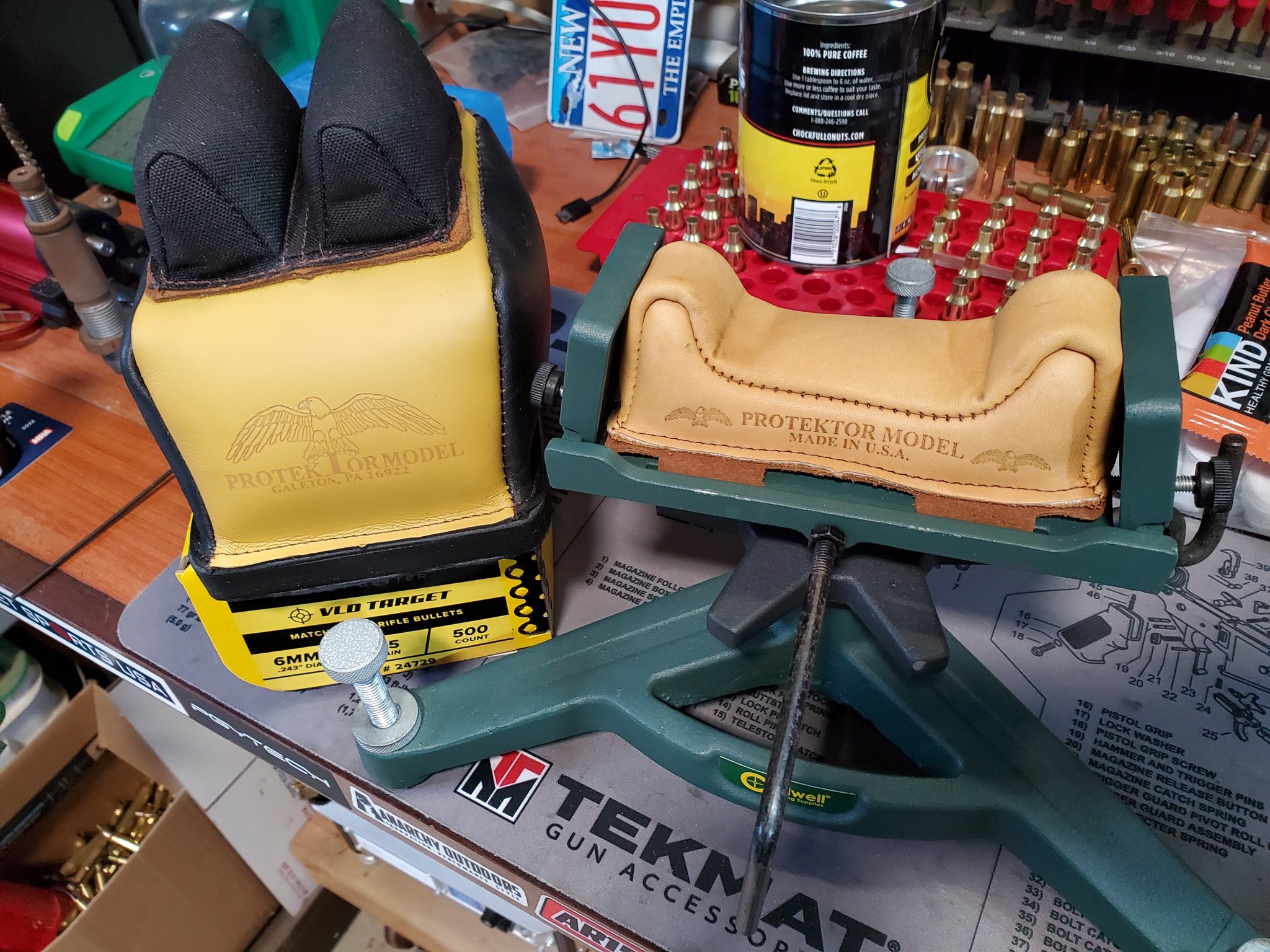

I bought a protector for a varmint Bench rest league shoot. Very pleased with it.

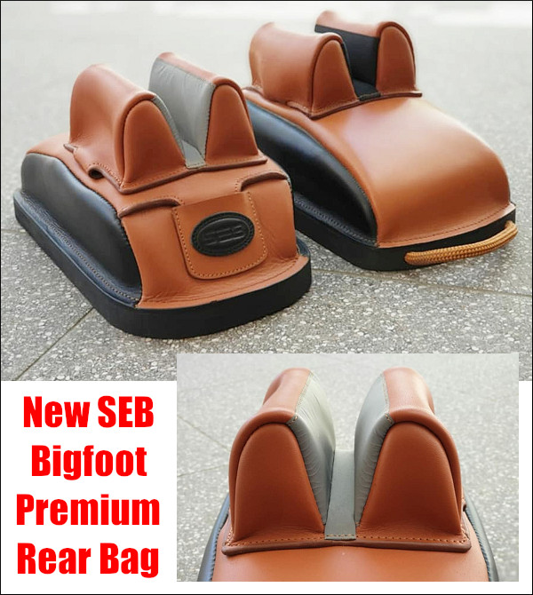

Gonna be hard to beat a bag like the above Bigfoot paired with an SEB Neo or Mini.

this is at the top of the list for stable rear bags. It is used primarily by F-Class shooters. If you are not into F-Class, go with a a lighter bag for a wider field of use.
One caution to my recommendation of this bag. I expect Seb designed this bag with the Neo and Joypod in mind. Both have joysticks for getting your reticle back on target after a shot. I have this bag and the joypod and they work excellent together. However, this bag is like a rock. It does not squeeze and moving it to achieve windage alignment is a chore. If you like to make adjustments using your rear bag to get your reticle back on target between shots this bag won’t work. you will be forced to muscle your front rest to regain crosshairs back on target.
You're not wrong about the heavy bags currently in vogue being non-squeezable, but... many guns have a slight taper to the toe of the butt stock. You can do some fine-adjusting of the elevation by sliding the gun forward or aft in the bags, and the taper will raise or lower your point of aim ever so slightly. Many front rests, even before joystick controls became the norm, have a windage adjustment knob that will move the whole top over one way or the other. Usually a very narrow range, but like I said, many rests *do* have that feature. If you're trying to shoot FTR style, i.e. with a bipod and one of those big heavy rear bags... well, it doesn't take long to get adept at nudging the gun/bipod one way or the other ever so slightly. Often times sliding the gun back and forth on the rear bag helps speed this up. As an aside... when I first tried messing with a joystick rest, maybe 12-15 years ago, my rear bag was *not* one that was heavy nor packed like a rock. Drove me nuts, because after every couple shots, I'd run out of range with the joystick and have to readjust the coarse elevation adjustment on the rest. Turned out the bag was settling under recoil. Had to 'pound it in' after setting up in position to compact the sand to minimize any subsequent settling. Fun times.
