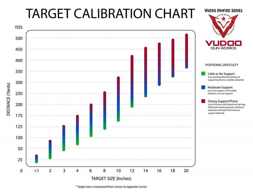

I've got a variety of targets, a kyl that goes from 1/4-2 inches, good for 50 or a bit farther. Targets from JC steel, Xsteel, and cheap reactive ones from Do All and Champion. 22's aren't hard on targets. A couple smaller IPSC for out to 200-250. If they're bigger than 4 inches they're pretty easy to hit out to 150 if there isn't much wind and your rest is at all stable.

That chart is exactly the kind of info I am looking for! Thanks B6graham

We also definitely go smaller than that out to 310y. And also as large as that at the same time. It’s about stage balance. Tough targets to challenge the best and easier targets to ensure that newer shooters get some hits.
yup.
1/4" KYL at 65-75'
2" IPSC between 120-140
4", bowling pin, sasquatch out to 200y
KYL down to 1" at 125-145y
wind at your range can be a major factor too. we shoot on a north facing 600y NRA range with minimal winds most of the time
For my PRS 22 matches I typically run 2-4 MOA targets depending on distance and the difficulty of the rest of the stage - time/prop/movement etc. 2-3 MOA on the closer stuff, and 3-4 MOA on the stuff beyond 200. Its a tricky balance to challenge the best shooters while not demoralizing the newer guys. I will also say that difficulty is highly dependent on your environment. My range always has wind, if you don't have wind that will make a huge difference.
