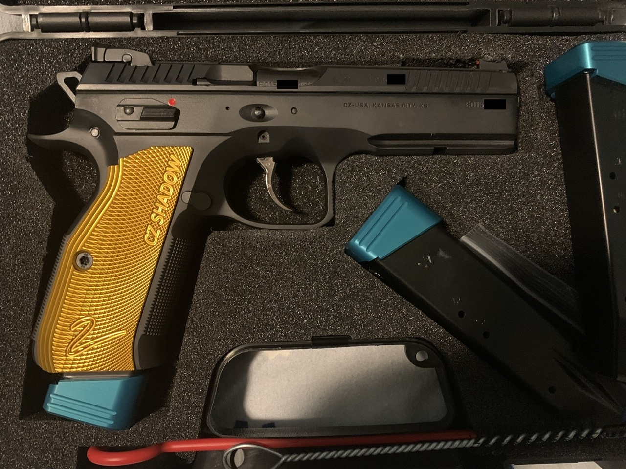

    Just picked up a low round CZ Shadow 2
    This is a Blue grip DA/SA, but the guy put Orange grips on it. Mags are 17 with +2 Blue base plates. So it’s kind of ugly, but price was to good to pass.
    It does not have the factory Optic cut slide.
    What are the best Mods bang for the buck on these Shadows? Preferably mods that won’t disqualify it from comps. Hell I’m not even sure what class these fall under?
    This is my first CZ & I’ve never shot a pistol comp.

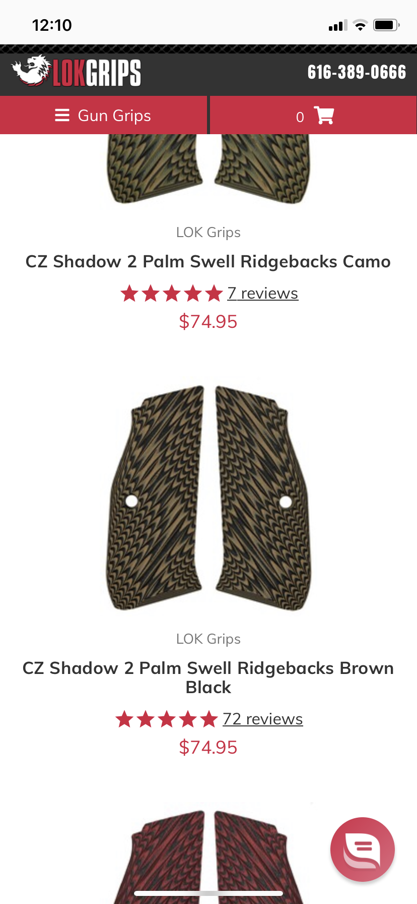

    I’m thinking Lok grips & a Cajun trigger kit.
    Maybe a Cajun slide bushing.
    Any in-site from CZ owners/competitors would be much appreciated.

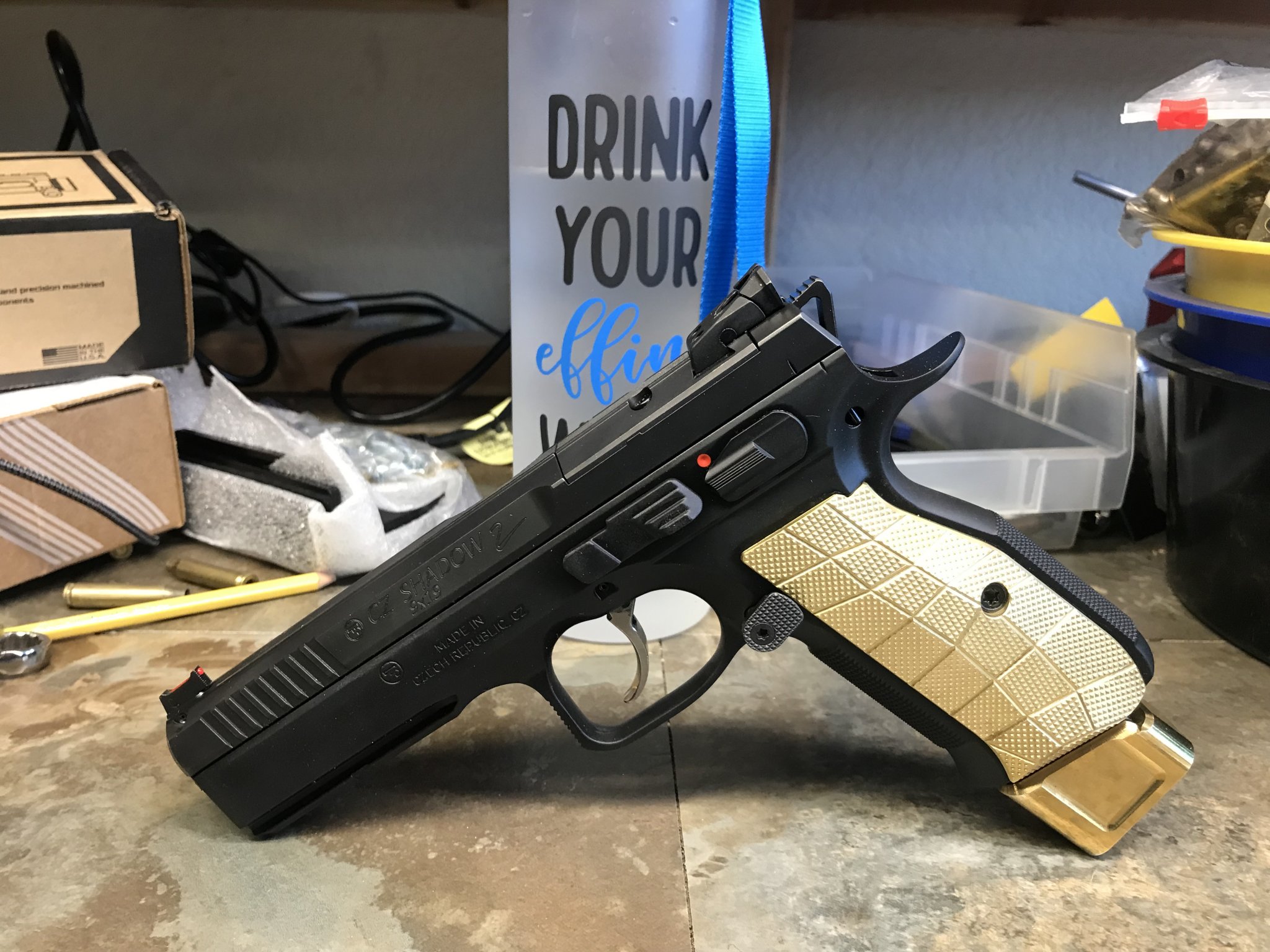

    This is relevant to my interests. I just picked up an S2 OR, I threw Lok Brass Aggressive full grips on it. I picked up some mags with patriot brass pads.
    It's loud, but its growing on me.
    They recently came out with the option to cerakote the Brass grips black, which I am quite the fan of.

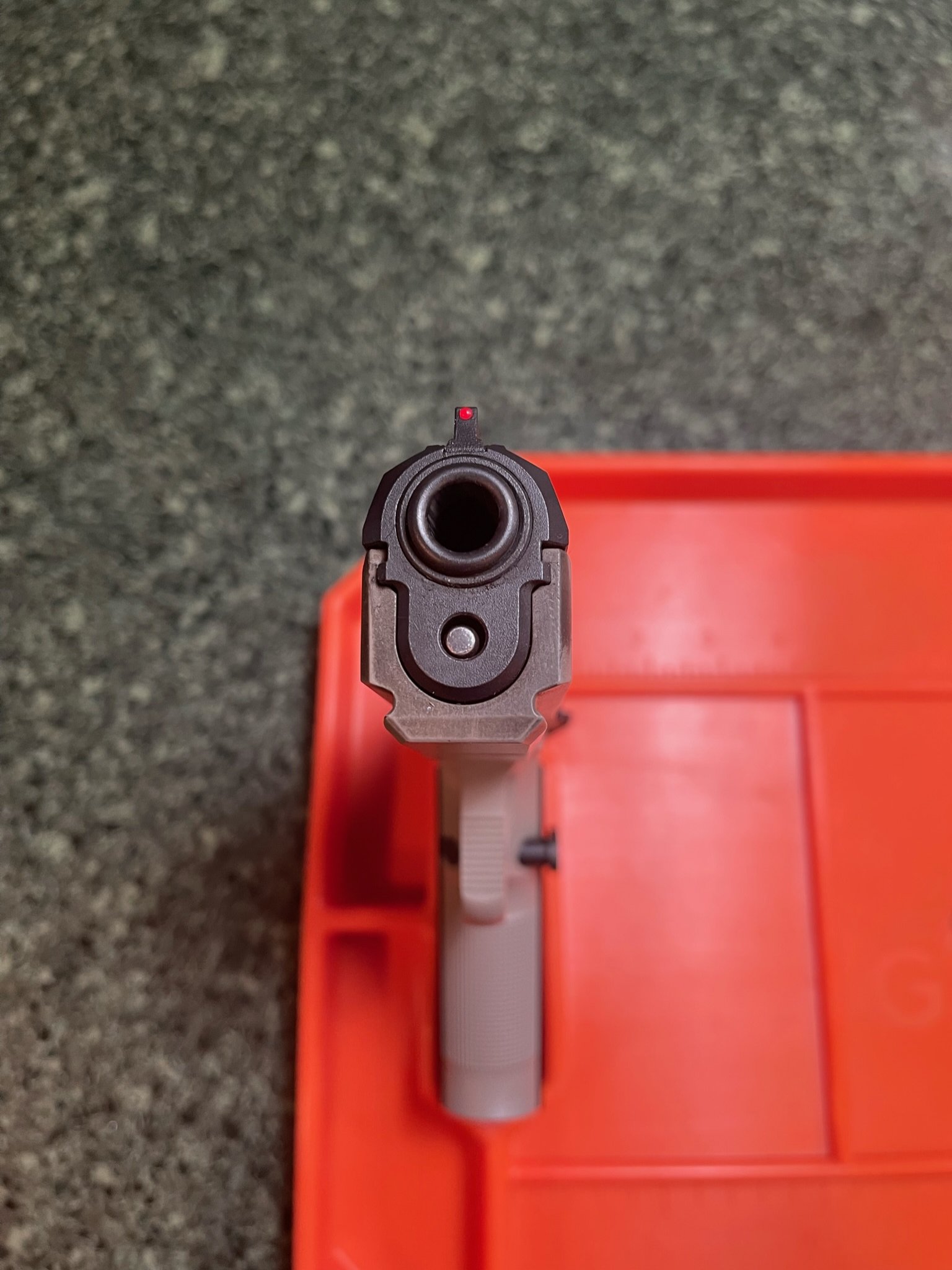

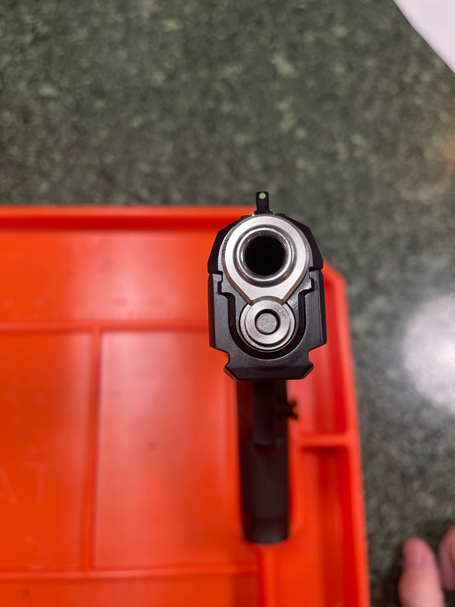

    Thanks. Mine has the bushing visible in pic in post 1. Is your Orange gun bushing different than this? I think mine is a 2015 model assuming first 2 numbers of serial is the year.
    Oh, I didn't think USPSA cared about weight? 59 oz is the weight limit.
    Wouldn’t brass grips put it over weight for USPSA?
    The Orange bushing is similar to what the 1911's use. Mine is tight enough to require the included bushing wrench to remove. I hear they loosen up after some time and can be manipulated by hand. I just noticed the front sights are different between the S2 and the Orange. Screw from the top vs. traditional roll pin from the side.

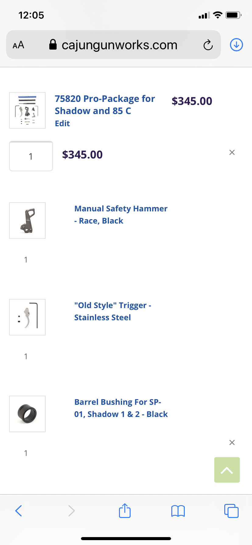

    Here’s what I’ve got in my cart from Cajun & Lok.
    Now I need to list some stuff in the PX. The wifey has taken notice of my gun expenditure’s & She’s got her 👁 👁 on me now.
    Probably also going to sell the Blue +2 base plates & look into the Henning base pads As @tfc suggested.
    I almost bought the pro package last night, but the dlc trigger being out of stock made me pause.

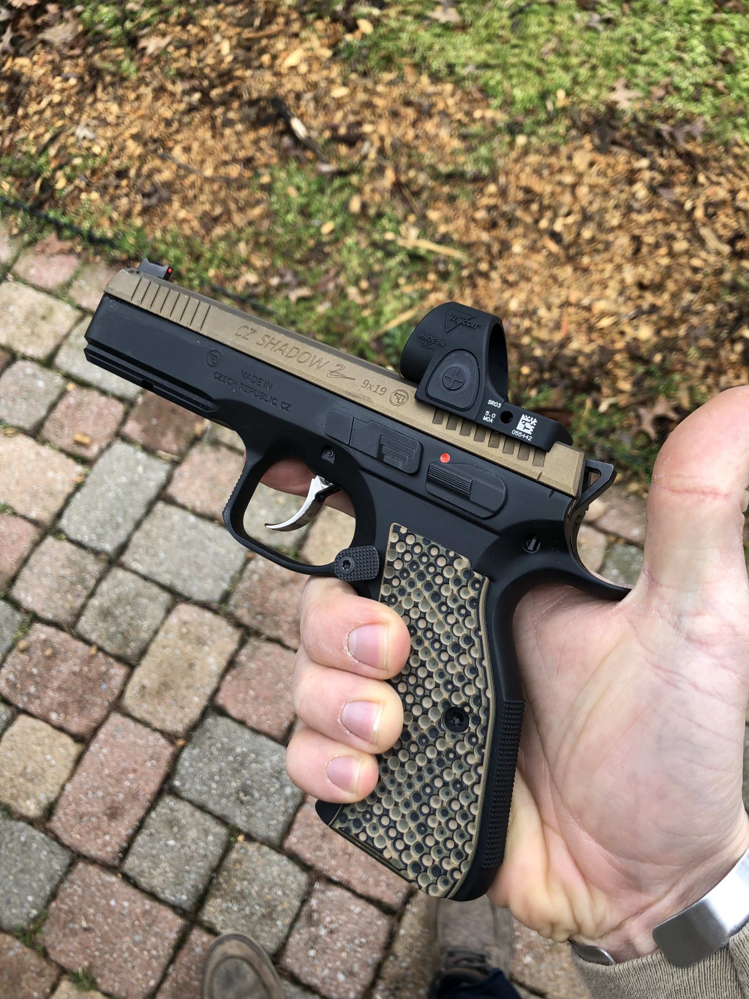

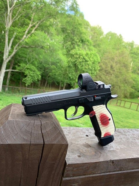

    You're going to love that pistol man... it's damn addicting. I sold all my glocks last fall and switched over to CZ. Just got mine back from Primary Machine who did an excellent job milling mine for an SRO; super low. They also offer different colors of cerakote for no extra charge. I put the LOK palmswell Bogey grips on and thats the biggest change there. I'm going to put a few thousand rounds through mine and then get a kit like mentioned above for it. Have fun...
    That is sick.
    Not having a firing pin block means there's no firing pin retaining pin through the slide which means they can mill the fuck out of the top of the slide to get the optic that low.
