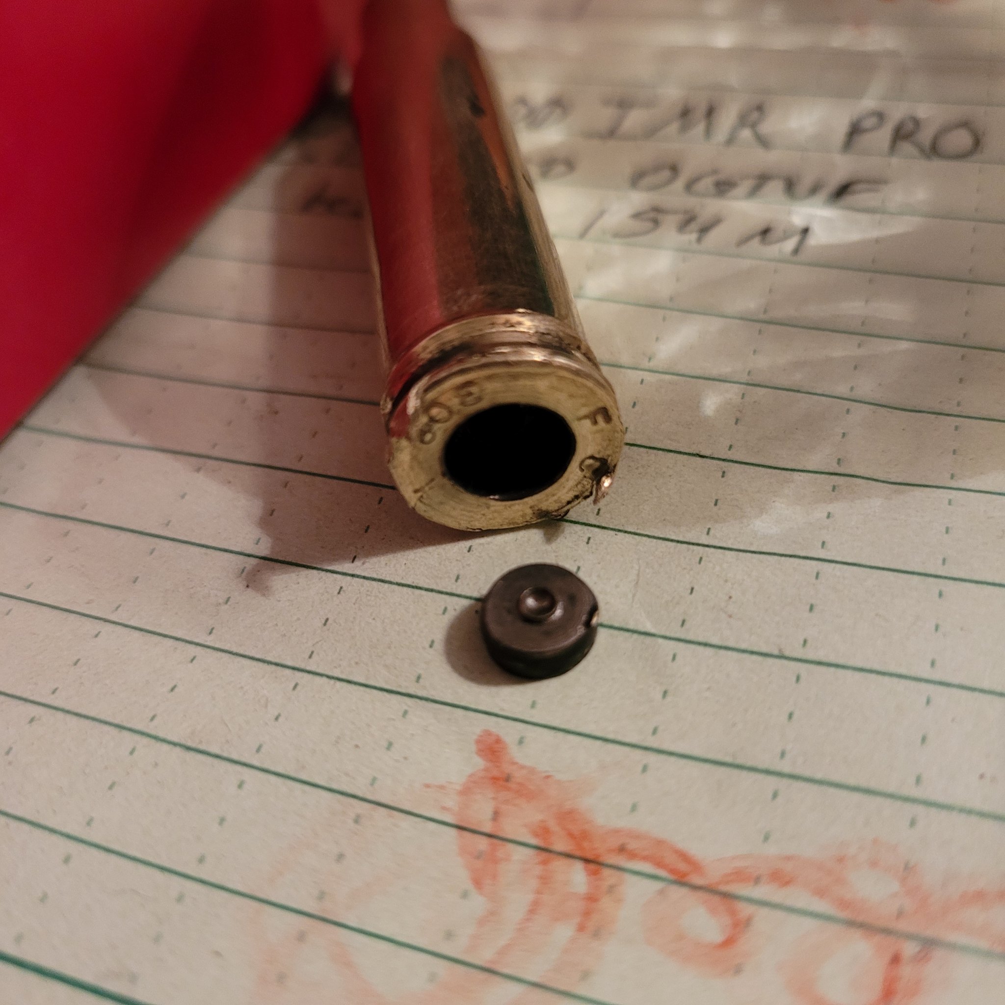

    Was doing some load development. I have a bunch of CFE223 that I actually don't use for 223; but it was too cheap to pass up. So I'm using it for 308.
    I looked around, found others recipes, found Hodgdon's data. I went off Hodgdon's data. Starting load is 45.5, max is 47.5
    *this is where i fuck up*

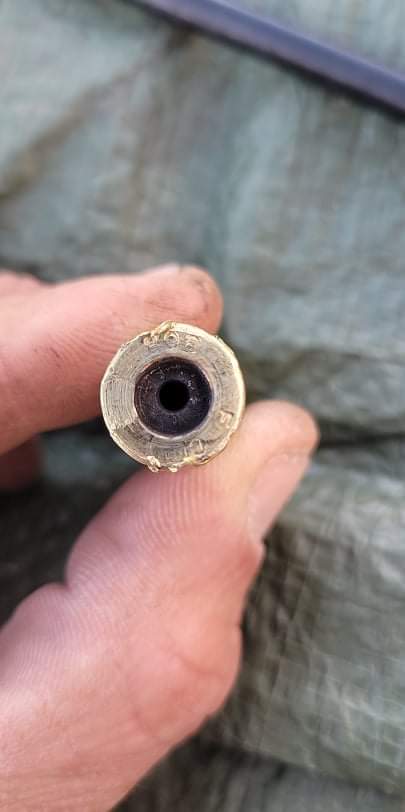

    Using FGMM brass*, wolf primers. Cases are full length sized with a .002 bump on shoulders. Hornady 178 BTHP COAL 2.86.
    Started at 45.4 and did 5 rounds in .3 grain increments up to 46.9

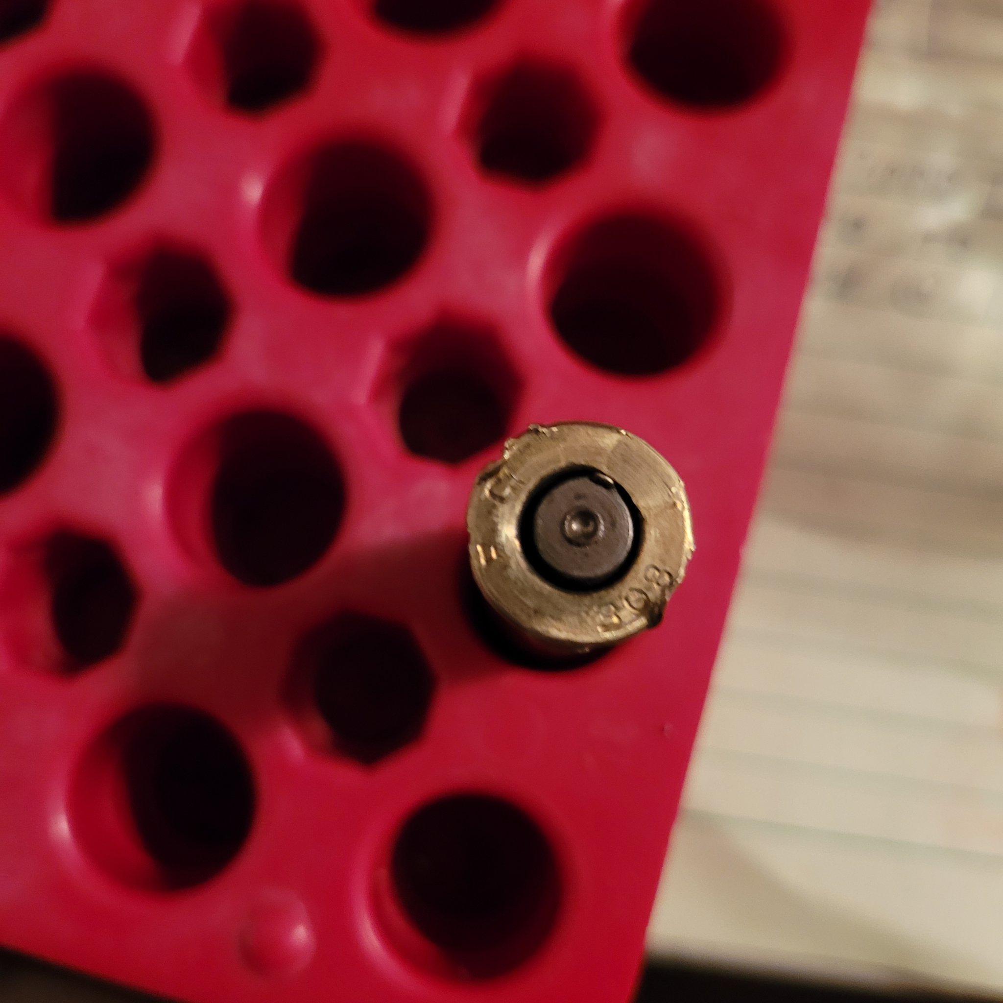

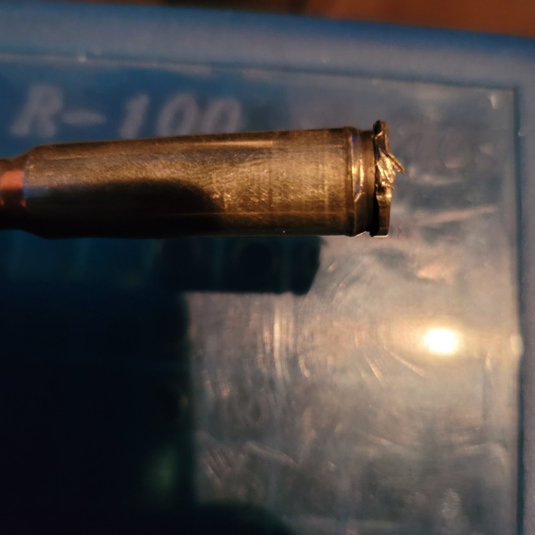

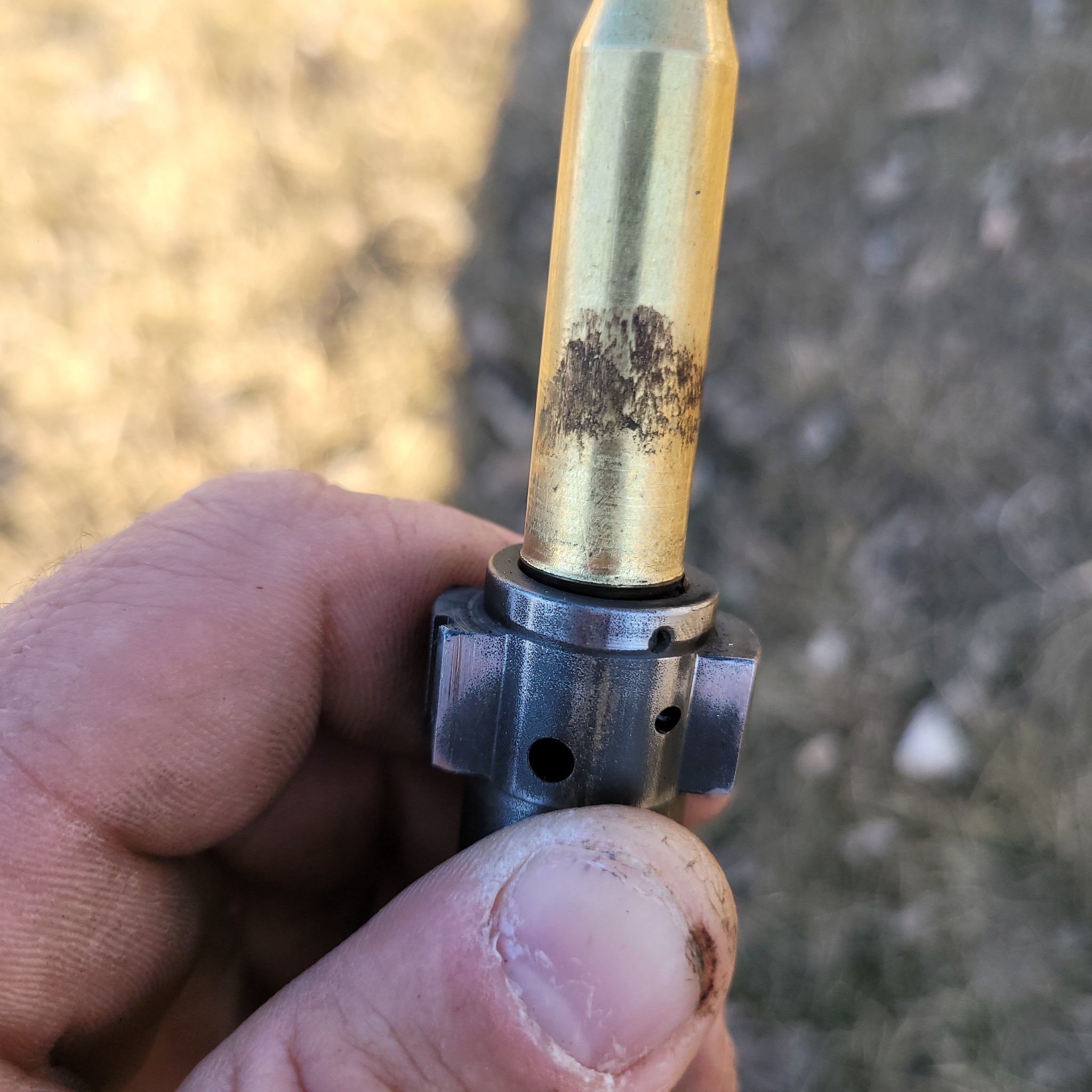

    The gun is a factory Remington 700P with a thousand or so rounds. At 46.6 on the 4th round I had powder or debris blow out the back of the bolt. Thankfully I wear glasses and just had my face peppered with what felt like dust.
    Could not lift the bolt. So wacked it with a mallet. Could not pull the bolt back, so wacked it with a mallet. The case was stuck to the bolt.
    Could not get the case off the bolt until I tapped it a bunch on the table.

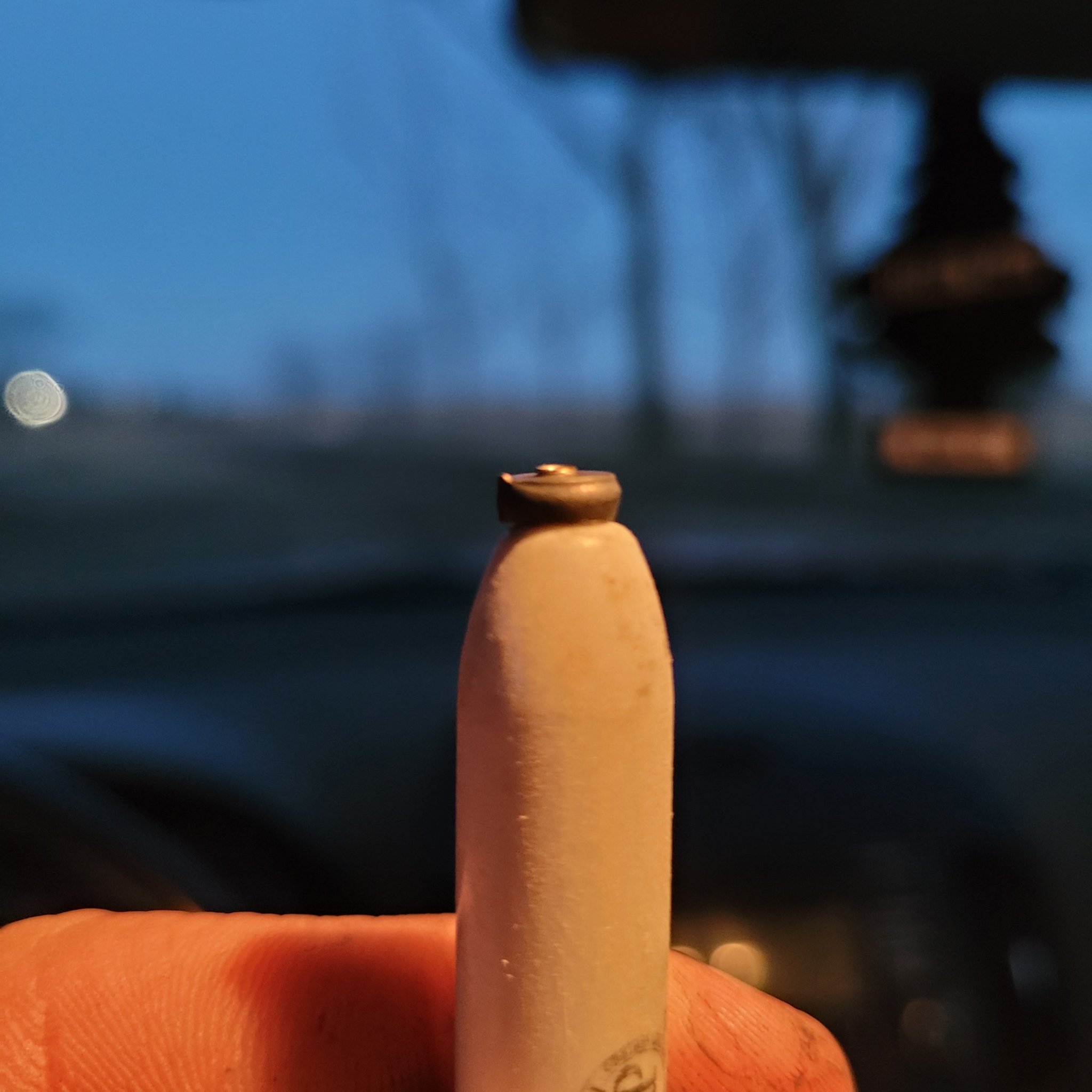

    The primer went flying the moment I got the case unstuck from the bolt.
    The flash hole seems to be twice the size of normal.
    All the rounds prior had no sticky or even a little difficulty lifting the bolt.

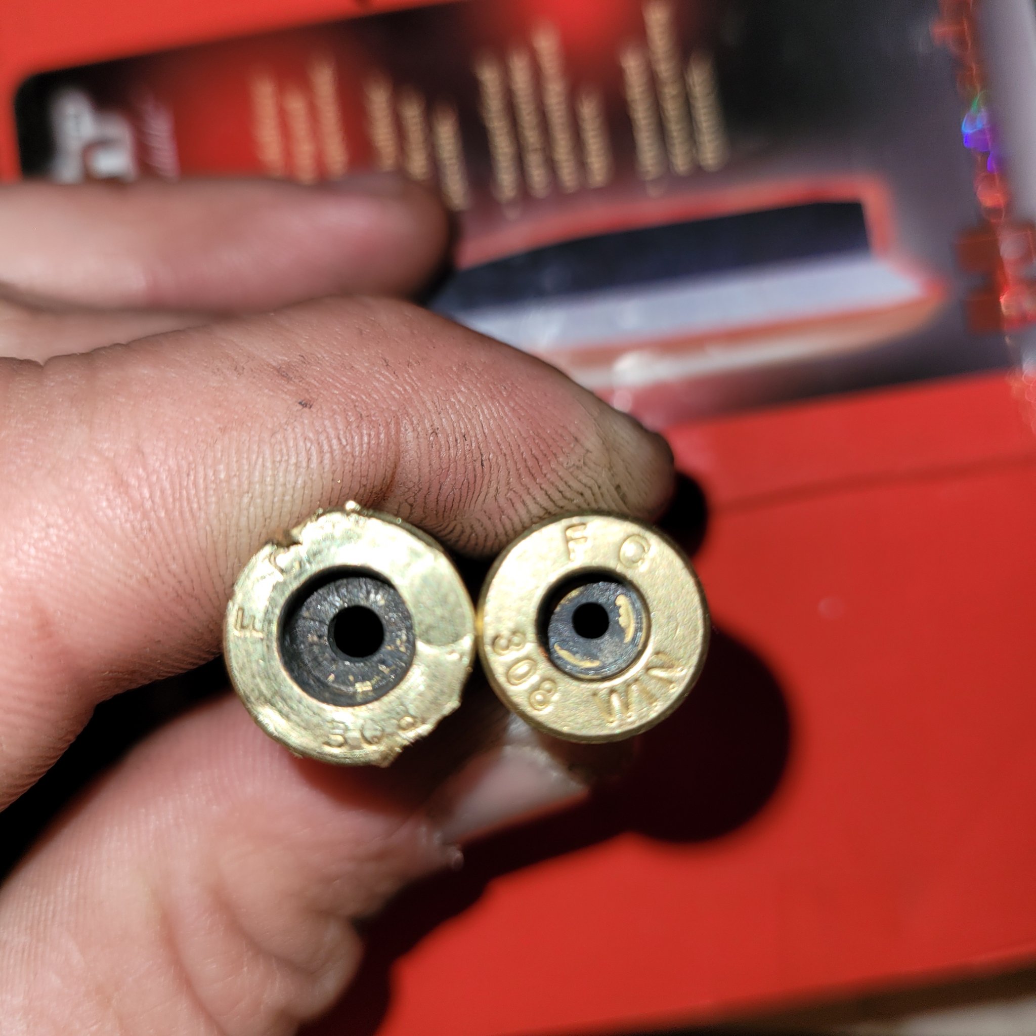

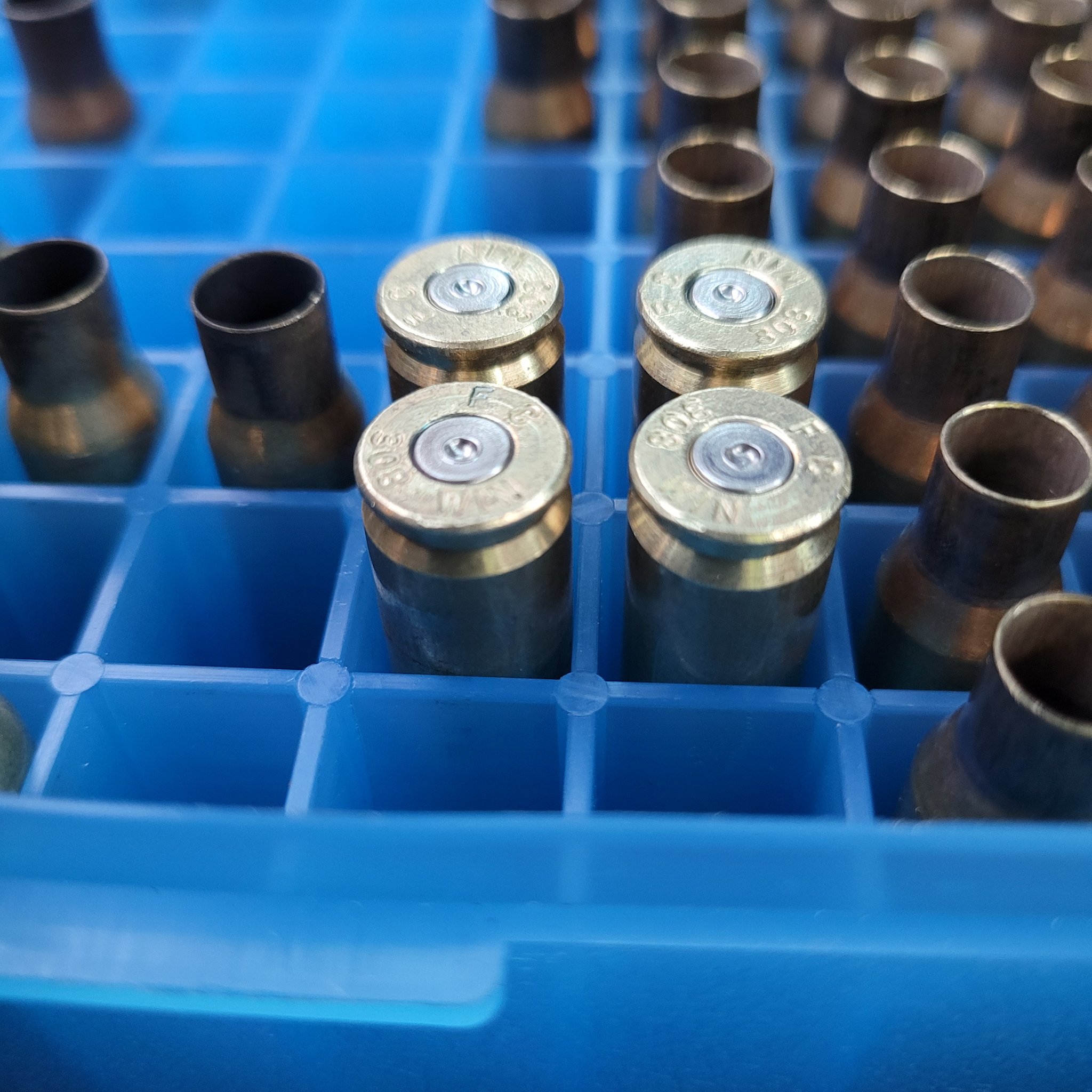

    The top two rounds in the next picture were 45.4 the two below were 46.6
    I always get cratered primers on most non military primers. So I don't really use that as a sign of pressure. And the primers still have a radius.
    So what happened?

    So it looks like you’re using the Hodgdon data for 175s, I see they are using Winchester cases which I believe to be thinner than your fat ass federal cases. So that would be an increase in pressure combined with federal being softer makes sense that you blew a primer pocket. Hard to tell from the pic and angle but it looks like you’ve got swipe signs you missed on your “fine” example cases?

    That was stupid of me. I also did fuck up the rifle. The extractor is broken and will not extract a case from the rifle now.
    I’d make sure you don’t have brass binding it jamming in the little recess for the extractor to bend into.
    Being a 308 it should be a real simple swap. If it were the riveted/mag extractor it’s tough and I’d ship it out for the m16 conversion like mentioned above. Not a bad upgrade either way, but the factory spring is cheap and easy.

    I think it was just a way over charged case. Then the fact that FC brass is apparently softer. That case just said no to a high pressure round.

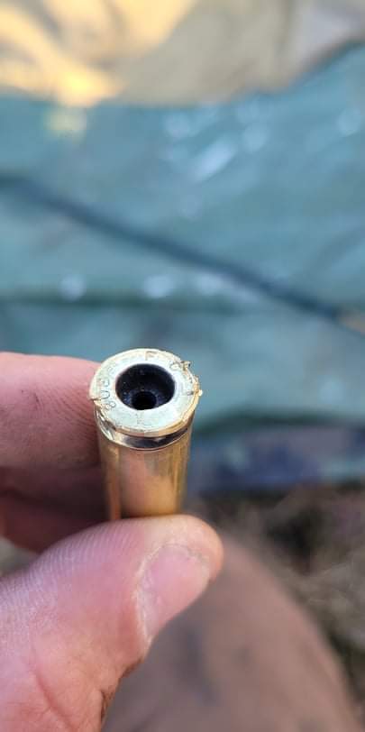

    The flash hole was normal. Then it got bigger and bigger and bigger as the pressure exceeded max for that brass.
    Is that normal for the flash hole to expand that much on a severely over pressure case? That's wild.
    What do you think would happen if you actually had a flash hole that large on a normal case? Wouldn't that exert an exponentially larger amount of pressure shooting backwards similar to what it takes to push the bullet out?
    Yes I have seen cases like that. Some people treat gun powder like gasoline. They fill up till it’s full.
    I have never seen a flash hole that big in a rifle case from the factory. Those are usually punched and are pretty consistent. And such a case would normally be identified during case prep and not used. I don’t think it would affect things tho. Large flash holes have been used in Win Clean pistol ammo back in the day because the lead free primers were underpowered.

    I'm not completely buying the case capacity theory. You were shooting 5 rounds per load, all FGMM brass, at .3gr increments 45.5 to 46.9 of CFE223, and on the 4th round of 46.6 suddenly this happened? Because going from a minor ejector swipe to the results of round 4 is a major, major change. I suspect something completely different than brass capacity with a slight powder overload (unless you DID significantly overload that one case). I would pull round 5 and weigh the powder charge. It just doesn't make sense that shot 1, 2, & 3 @46.6 were fine (very minor pressure sign) and shot 4 did that without something being way different for round 4.
    ETA: Pull all your remaining loads and weigh the powder charge. Also, any chance you may have accidently put a different 30 cal bullet in round 4? Like maybe a 208gr Hornady BTHP?
