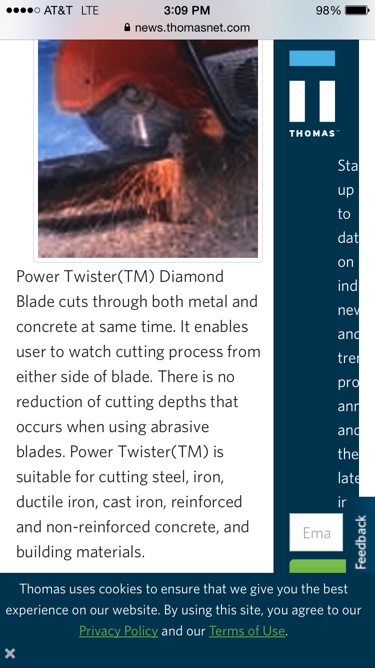

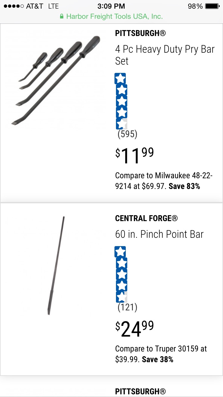

The problem is this will get you in a lot of safes
And this will get you in the rest of them. Luckily most smash and grabs don't have expensive concrete saws and diamond blades
So don't forget to layer security. Alarms. Cameras. Alert neighbors. Opsec. Etc

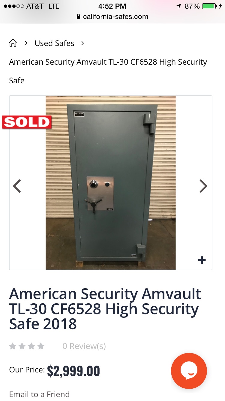

Craigslist is your friend.
I got a really nice paperwork/cash safe off there for 50 bucks once.
Check this one out. Just 400 bucks and it looks like a decent one.

The tools that will be used to open your safe while you're away usually come from your own garage. Secure them first.

The same cannot be said of the high end AmSec gun safes, as they offer actual UL TL ratings (even TL30X6 on a couple of models). Even at that, though, as others have mentioned, anyone with enough time and motivation can get into anything... so layering security and fire reporting methods to hedge your bets against grinders/cutters/torches is the best approach. Further, if you have anything like a plasma cutter or oxy/acetylene setup, make sure to keep the tips in your safe; they're small, and effectively render those tools useless if a bad guy wants to use them to try to let himself into your safe.
