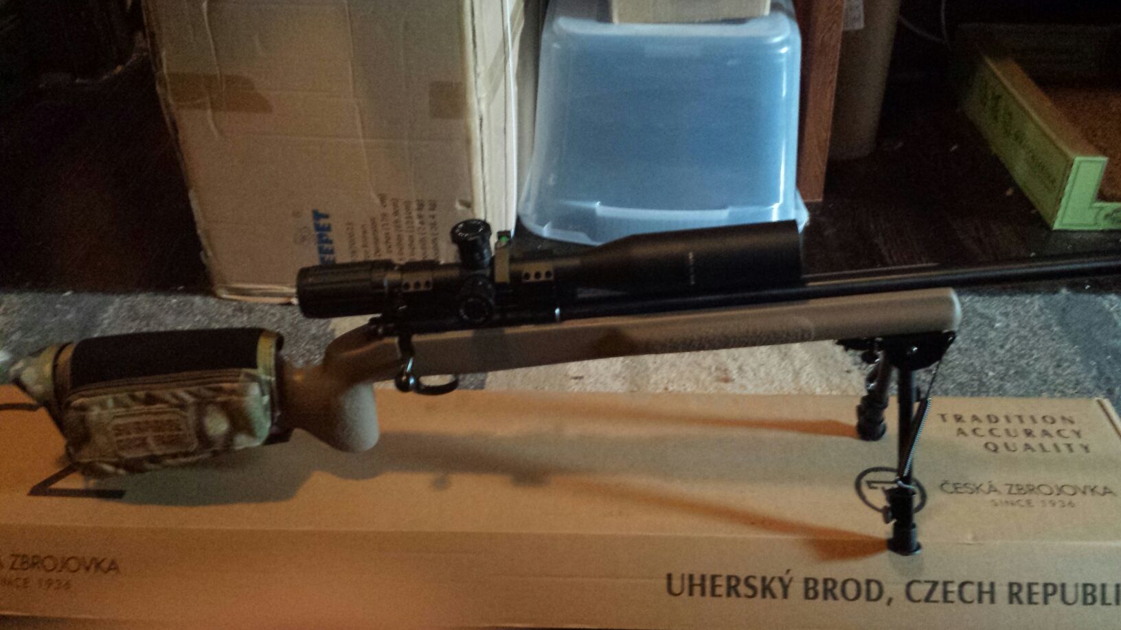

Forgive the shitty photo and boxes. I'm in the middle of moving and not in the middle of cleaning or being a half ass photographer.
It's an SWFA fixed 10x on a DIP 20 MOA base. It works out pretty well for what I'm doing with it.

Is that blackhawk bipod good quality? I know it's probably not build like a Harris but for a .22 like a cz455, have you had any problems with it?
.02 on the blackhawk pod, definitely not a harris, much flimsier, the pod lock feature on it is pretty sucky compared to a harris, the arm springs aren't as stout. but it is a third of the price. for someone on a strict budget it serves the purpose, i guess.
For what I use it for, yes. I actually put a load on it before squeezing off. It is holding up well. Would I use it for a centerfire for actually ops/competition? No. You can't beat the price...
