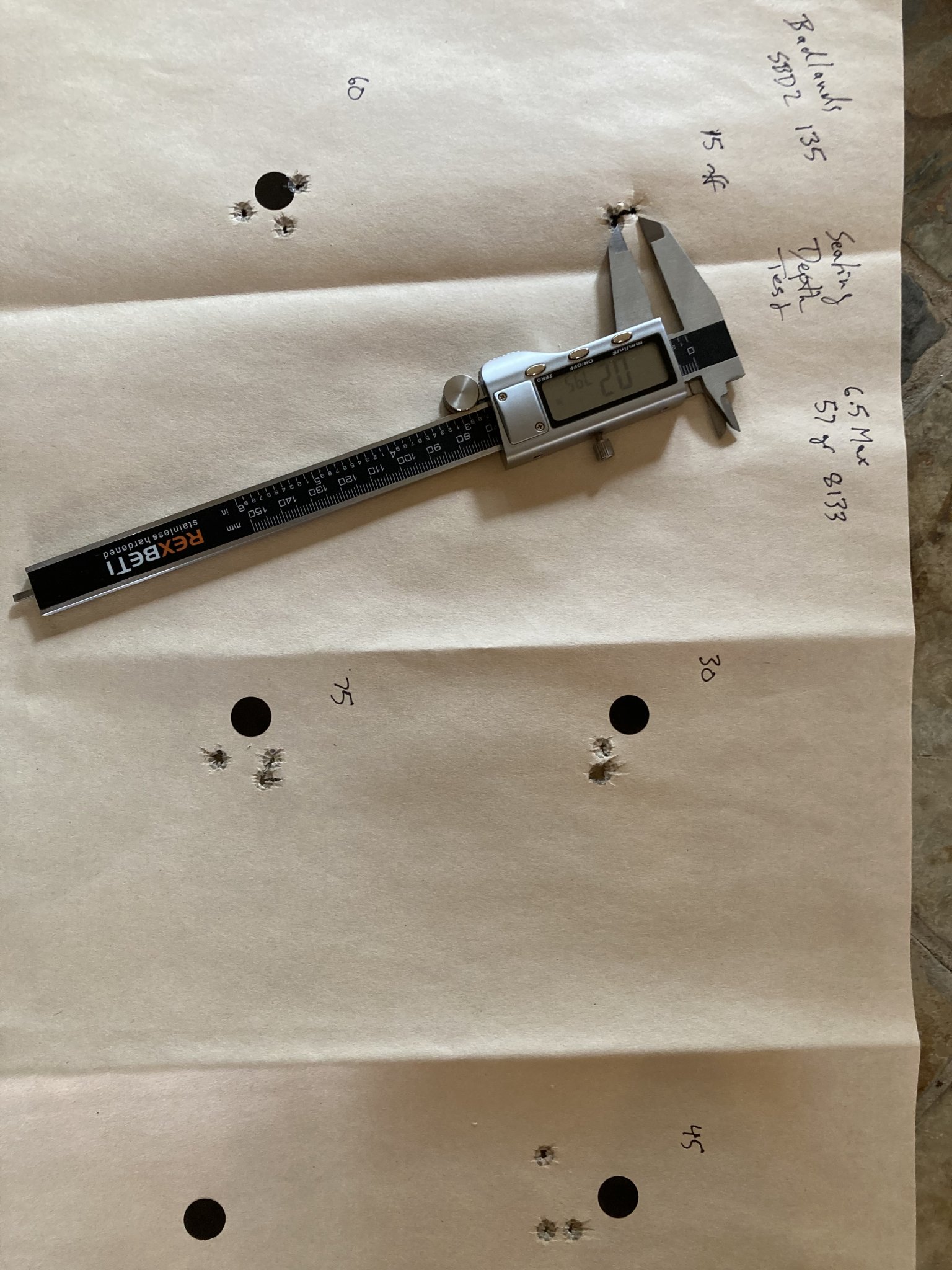

For actual shooting scenarios where this has shown up for me...i had a 223 barrel a while back...shooting 80 VLDs. I did powder tests, i did the Berger jump tests (the off the lands version i think from .020 to .120 or whatever it was)...and everything was basically 3/4" @ 100...some groups around 1/2", some closer to 1", but everything in a decent sample size...3/4", which is not a pretty looking group shooting small .224 bullets
Buddy of mine said "try them .005" off"...so i did, groups instantly cut in approx. 1/2...went to shooting a lot of ragged holes groups on the regular in the 1/4-5/8" range...and it did this for a pretty long time, until the lands wore away...it basically became a 3/4moa system again over time

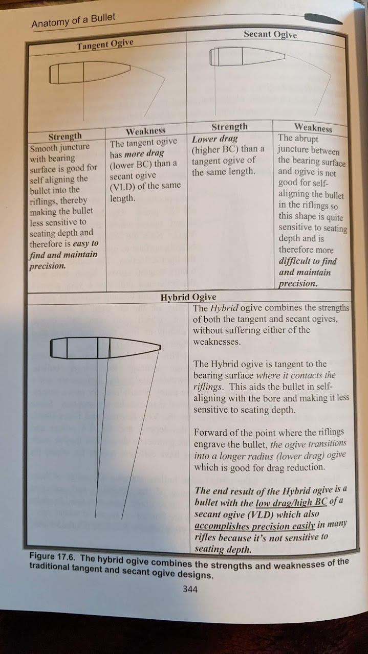

https://bulletin.accurateshooter.co...ant-hybrid-bullet-geometry-explained-by-litz/
doesnt answer the question...i know the differences in bullets...i shoot the ones i shoot for a reason
how do bullets with more forgiving designs at the throat...also account for various muzzle exit timing?
unless litz is implying similar to my posed question, that how the bullet is handed off is what matters...but that doesnt align with most everyones talks of muzzle exit timing...thats the rub

That's what it's implying. The juncture between ogive and bearing surface of a bullet design may or may not lend itself well for bullet alignment into the lands and it's more about alignment than it is timing.

and yes...ive seen peoples small sample testing that show "clear winners"...i have stacks of my own also. I also have stacks of load dev where i shot "forgiving" bullets across 2-5 grain charge windows and .100" jump windows that didnt move significantly at all...possible can barrels be oscillating within a similar window at all times, and the variation seen on target is just how straight the bullet was handed off and leaves the bore?

Maybe it’s not a timing issue alone. Maybe it’s a timing issue qualified by a bullet engraving issue.
For example, if a tangent or hybrid bullet engraves more gradually then timing becomes less critical. A secant hits the lands abruptly vs a tangent hitting the lands gradually which softens the blow sort of and makes the transition easier.
Does a secant stop at the lands and then begin to move again? Does a tangent simply slow down a bit?
Neither bullet stops once ignition happens, it is nothing but acceleration until the bullet exits. There is very likely a difference in the acceleration once they hit the lands but I bet that only JPL could determine exactly what that is.

Seating depth test for a 6.5 Max. Based on all of the load development I've done, I believe seating depth is more important than powder charge.
id be curious to see what a handful of 10 shot groups of 15 off vs 75 off looked like
ive never shot any badlands, maybe they respond to how my VLDs did...that looks similar to what i saw with my VLDs
