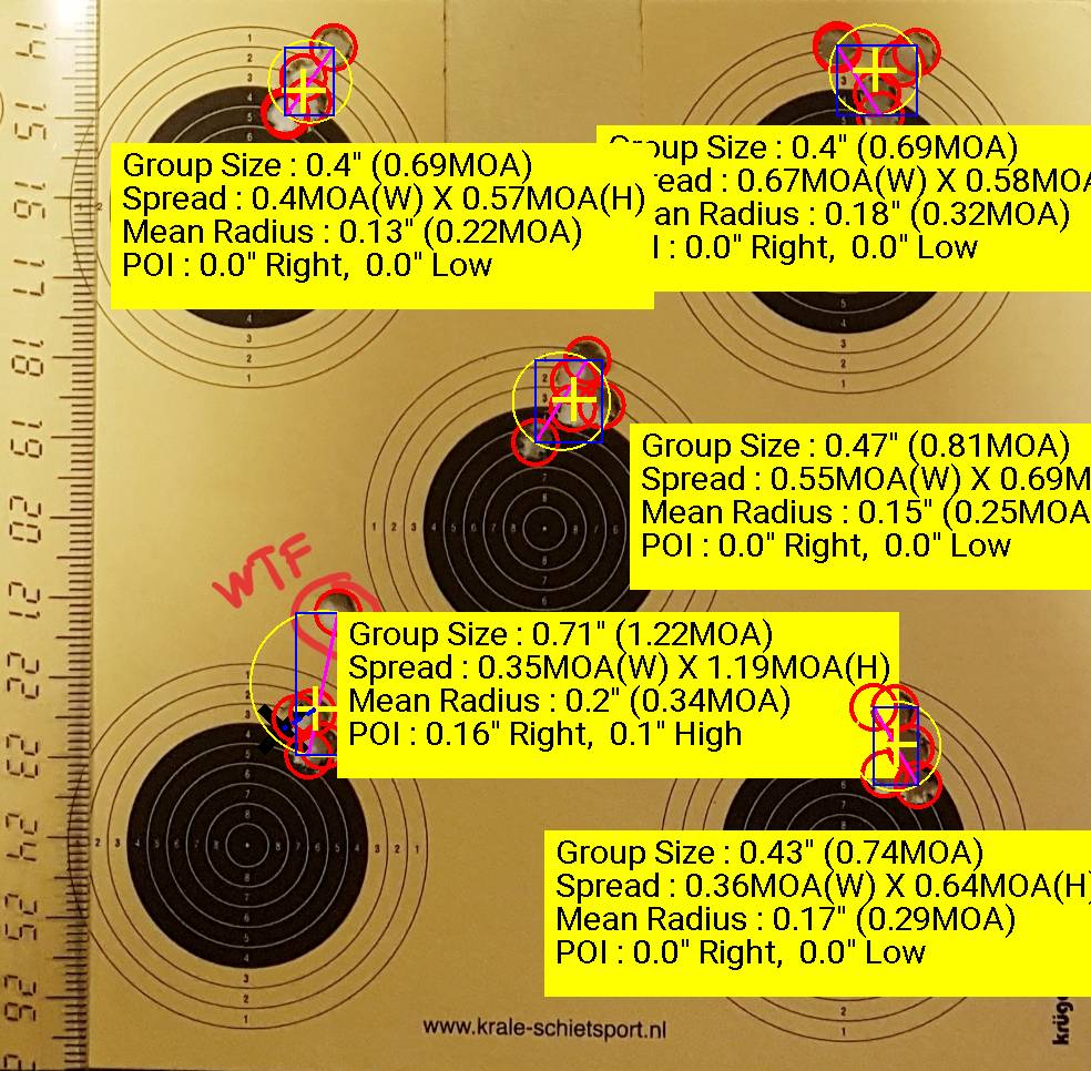

That does this:
7093242
Thanx.

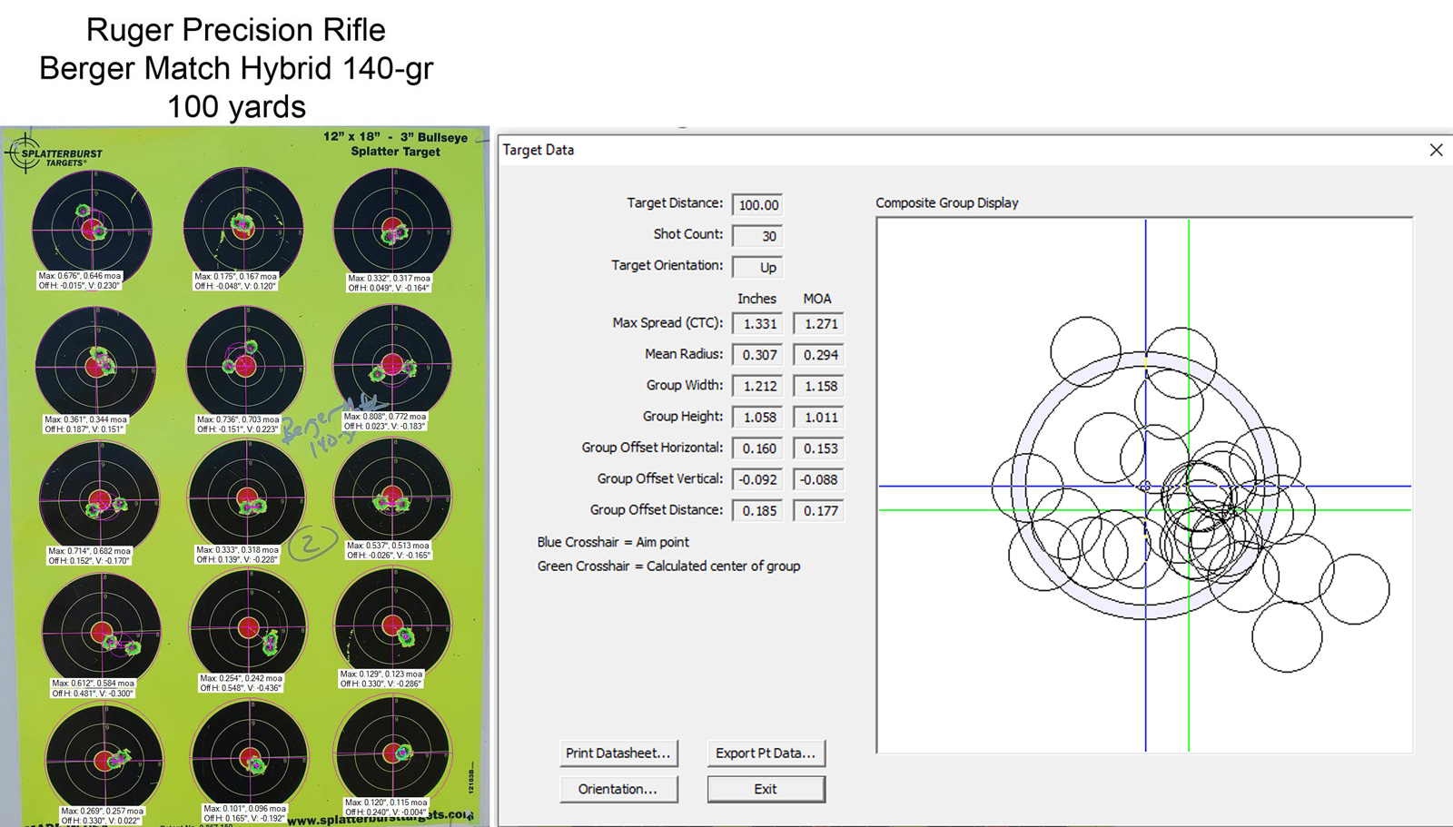

BallisticX for phone and On target for PC (that's what you have in your photo. OnTarget is more feature rich in terms of saving and zooming, plus has some other measurements/aggregates that can be useful. Along with the ability to put multiple groups on a single photo.

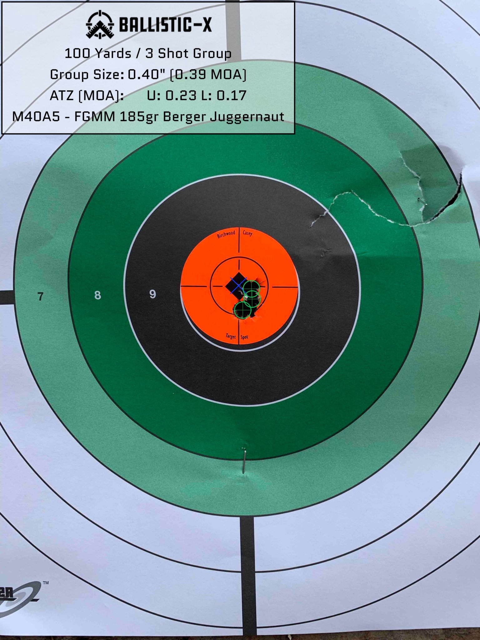

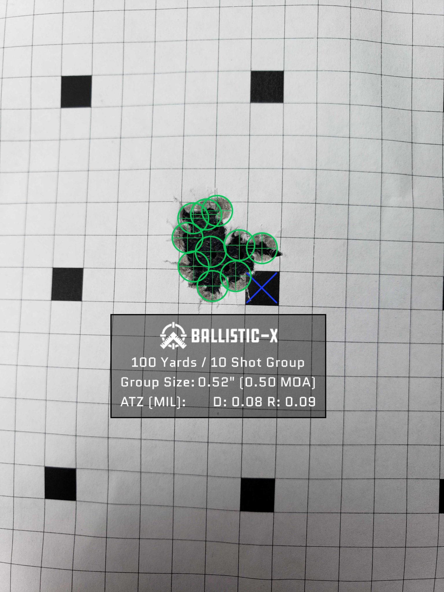

But BallisticX is fast, and super simple:
7093258
Reactions: tnichols
Ballistic X. You can add notes also to reference later.

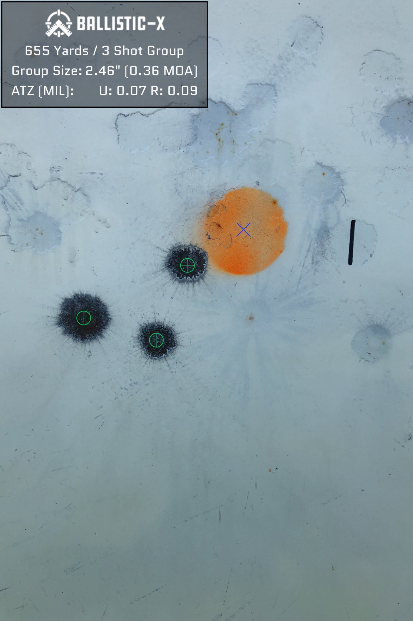

Yup Ballistic X. Who doesn't have a smartphone these days? Gives you zeroing corrections too.
Reactions: rydah
AFAIK, Ballistic-X doesn't do multiple groups on one target - you'd have to take separate images, or start over for each.
The picture originally posted is from On-Target Precision Calculator. There used to be a free version (v 1.x) and the 2.x version had more features and was pay-only (free trial period, though). It is Windows only, no love for Mac/Linux/Chromebooks.

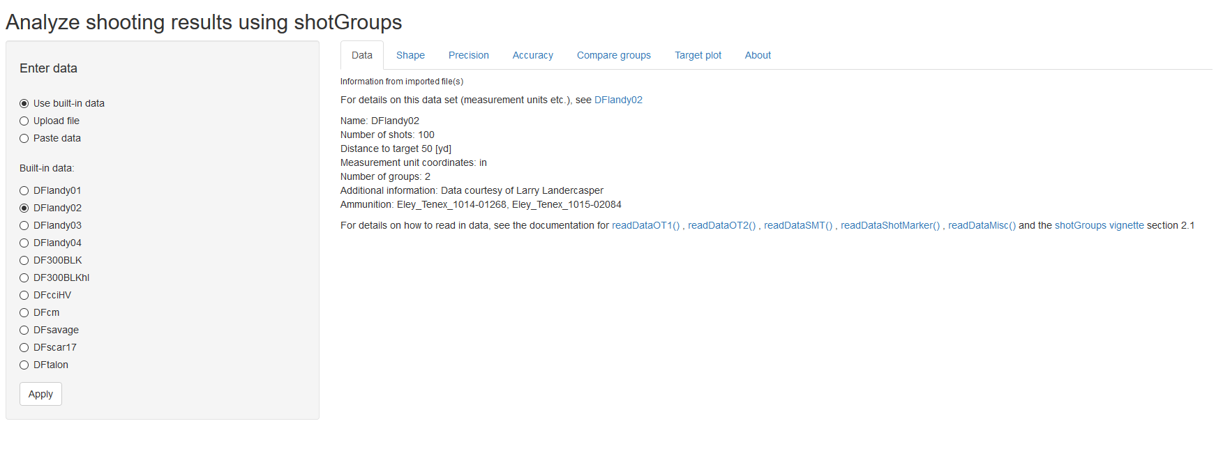

If you *really* want to get your geek on, there is always shotGroups...
Personally I prefer doing it directly on my ShotMarker e-target when I can, but I wish it had a few more bells-n-whistles as far as the group analysis goes, but then again, one can always export the data to shotGroups ;)

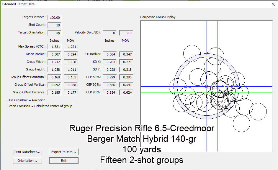

I much prefer a PC app than a phone app... Especially because I like to process several groups per target image. OnTarget is the best, IMO.
I made this video demo not long ago:
@Racer88 any chance of you making another video on the TDS functions?
Such as? I'm not an expert. I'm still learning. :) The only other thing I can think of that might make a good video topic are the "virtual groups" (or as I call them "composite groups."
Bingo. I've seen where people have used those for plotting OCW tests. I think the manual mentions it, but IIRC its a tad light on details on that particular facet. If you've got it figured out, a screen cast / video would be *awesome*.
Actually, this is more what I was referring to:
Where the process breaks down for me is the 'built-in' function that will automagically scan a target sheet (only one of the ones provided for download/print by OnTarget) only works with one shot per bull - not with three or five shot groups per bull, which is the way I typically do OCW testing. The 'ADC' number is kind of a misnomer, as its an 'average' of only one shot.
Getting from the big strung-out mess of the virtual group (like what you linked to) to precise, coherent information like this, but with 3-5 shots per bull... is where I was looking for info. And no, the developer isn't interested.
At this point, my current approach would be to export the point data from the groups to a CSV file and pull it into something else (spreadsheet, RStudio, etc.) and manipulate it to *make* a graphic like the one TDS produces for the one-shot-per-bull targets. Just haven't got around to it ;)

That said, I have OnTarget TDS. And if you *really* want to get your geek on, check out shotGroups... but be prepared to have to a bit more work.
That link brings me to this.... No idea what I'm looking at.

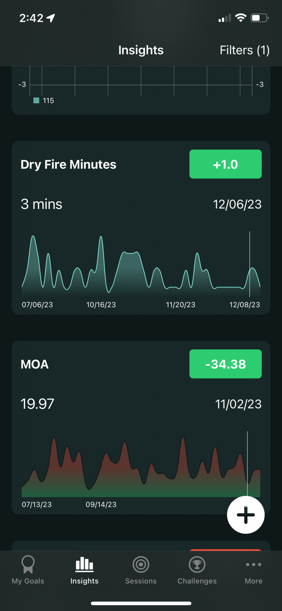

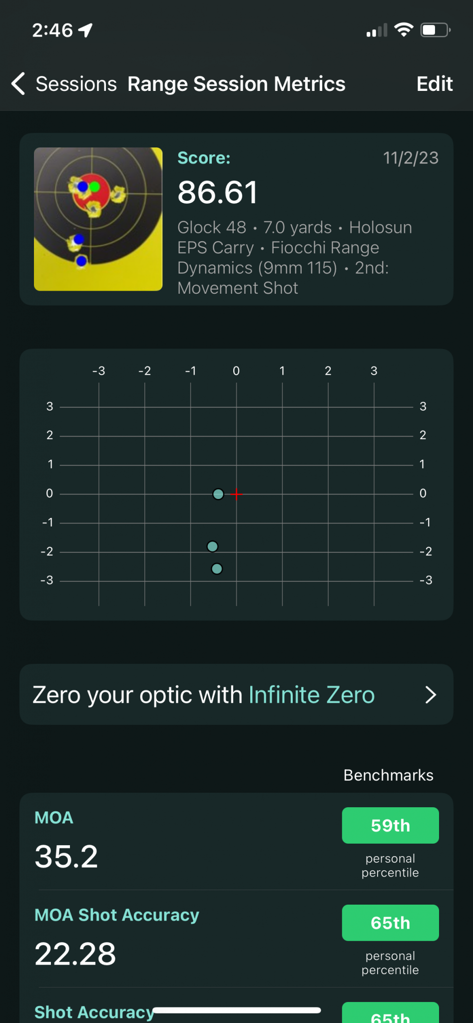

I wanted an easier way to measure shot groups in where I didn’t need special targets or had to mark an inch reference, so I built Ballistics Report.
Plus there’s a ton features, including global benchmarks for shot group metrics, charts and graphs to track improvements and a ton more.
Always looking for feedback so let me know if there’s something it’s missing. And it’s free to try.
