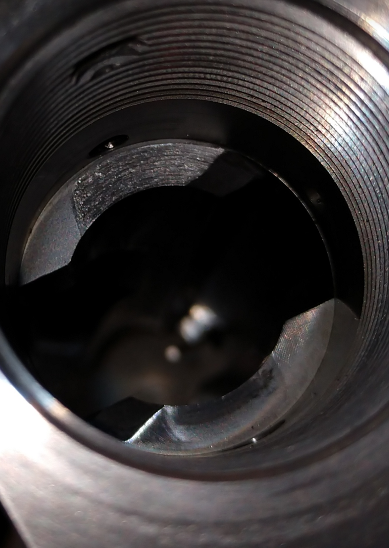

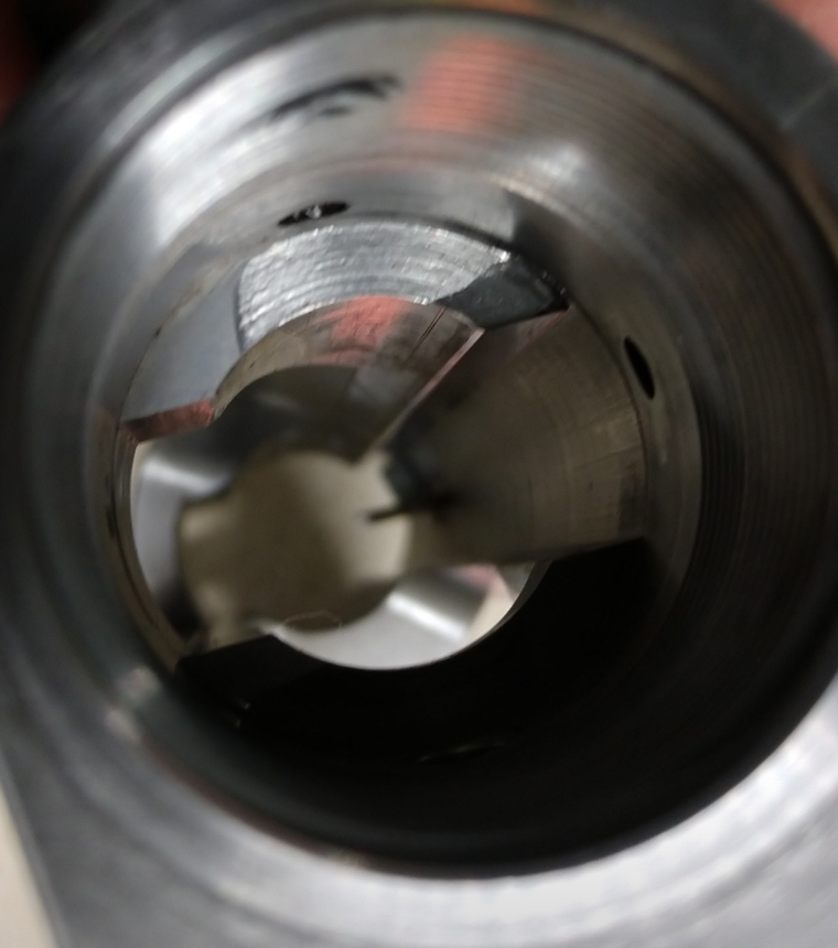

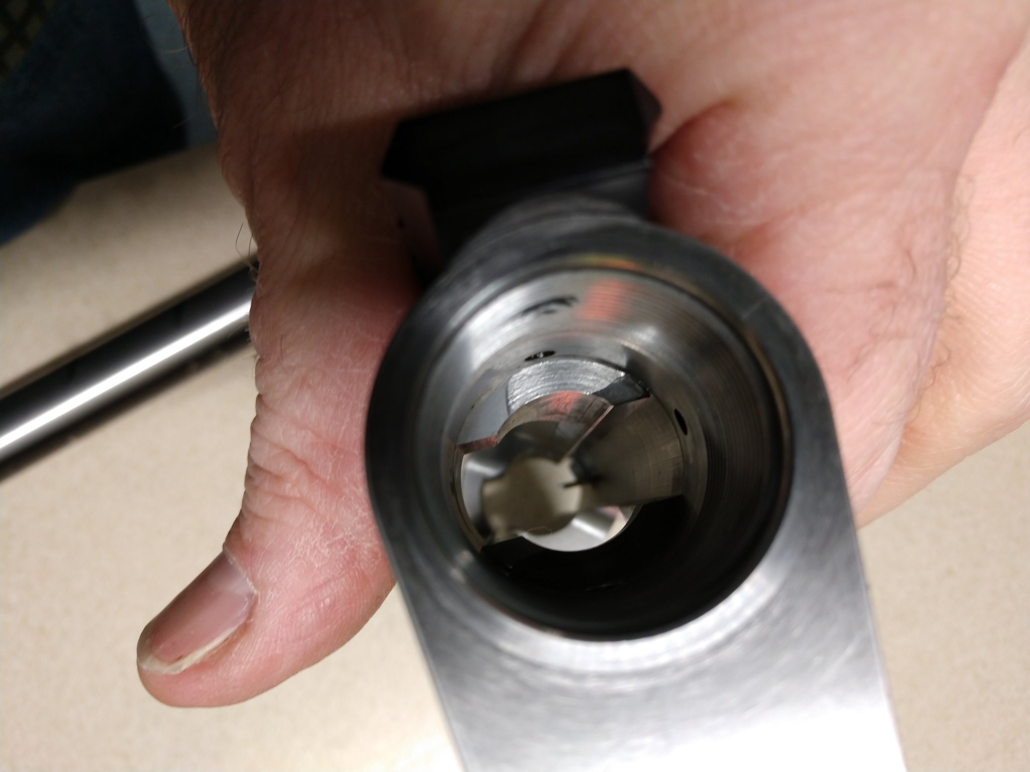

    Hmmm ... I just took the barrel off and found this after spraying cleaner on n there and wiping it down:
    Maybe something got in there and stuck on the lugs?
    Did I ruin this action?!

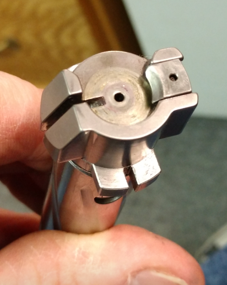

    Whats the back side of the bolt lugs look like? If they are GTG you might get away with lapping.
    That damage was probably done from forcing the bolt closed and galling the lugs.

    Lugs are galled, do you lube the bolt lugs? No lube and forcing the bolt closed will do that.
    Check the bolt lugs also.
    Send it to the mfg they should be able to clean that up depending on how deep the galling is.
