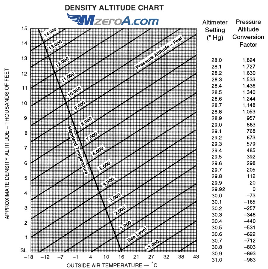

You could get a unit without DA and manually calculate it or get close with a DA chart. It's just worth it to me to have it as its practically all I use the kestrell for.
