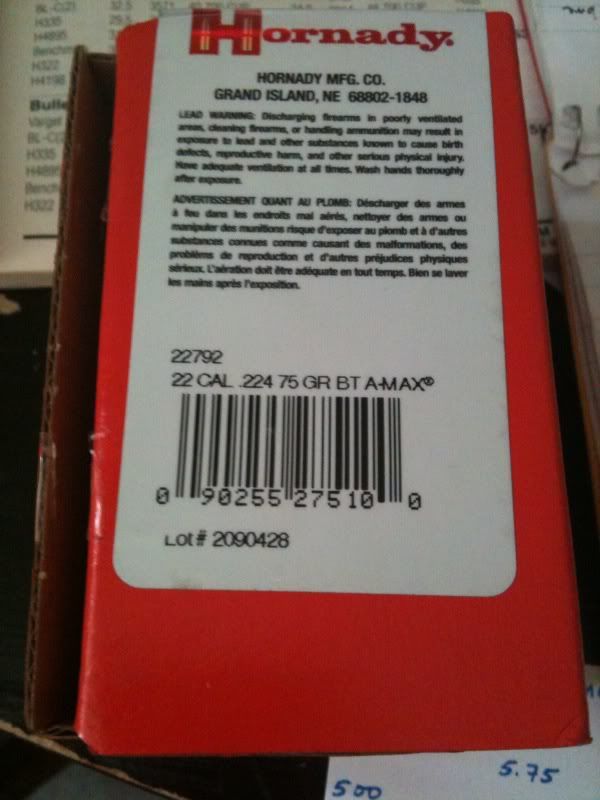

Where'd you find AMAXs for a 9" twist?? My box says 8"?!

The Perforator - what is the lot number on your box of AMAX 75s? The ones in the pic are from 2004. If Hornady made a change to their marking of the box I want to know so I can stop posting this pic in every 9 twist 223 thread that comes up

Lot # 2090428

Mfg 4/28/2009 - I will quit posting my pic for 9 twist, other than a point of history. Thanks for putting that up.

Were are good thanks - I don't have any 9 twist barrels on rifles I'd shoot non-mag length bullets out of.
My guess is Hornady did not change the bullet - just the label on the box - due to too many complaints about performance issues with the AMAX 75 in the 9 twist. I'll see if I can verify that.

My guess is Hornady did not change the bullet - just the label on the box - due to too many complaints about performance issues with the AMAX 75 in the 9 twist. I'll see if I can verify that. </div></div>
Yeah, just a box change. The 50 gr Vmax and 68 gr BTHP have switched over to the new prettier box. The #22792 for the 75 gr Amax stayed the same...
