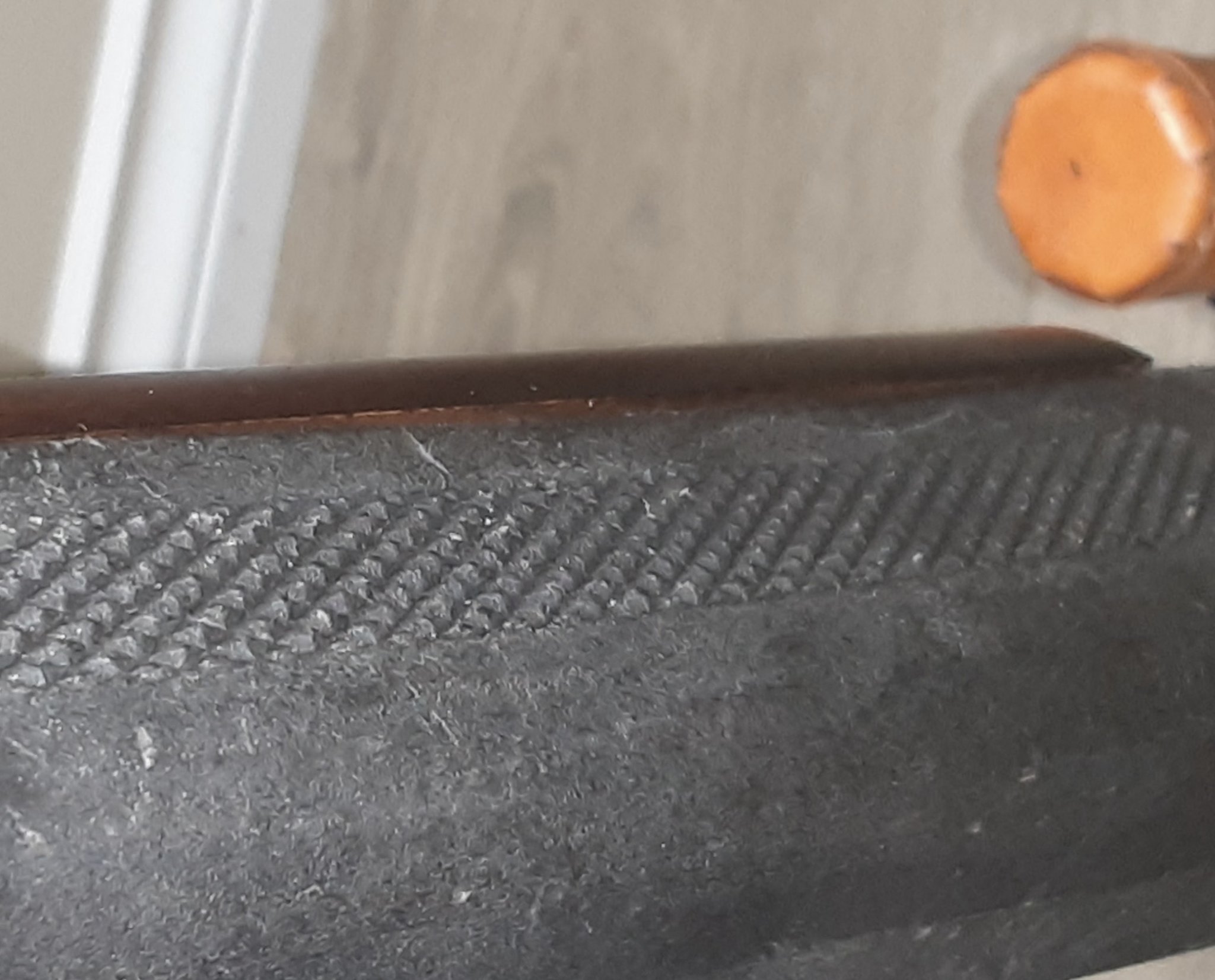

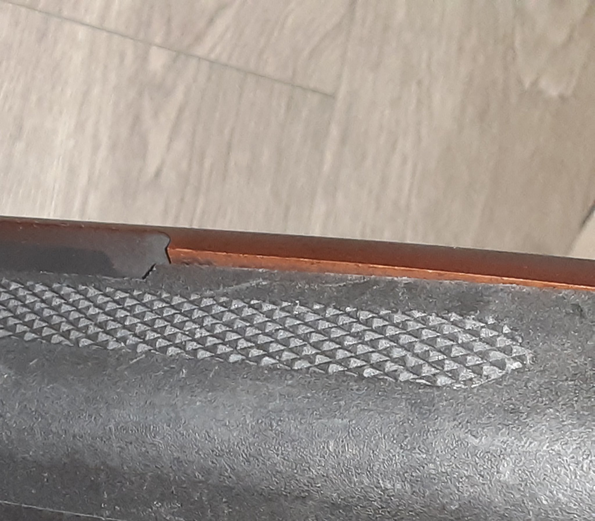

Surprising what comes up on a web search; I recently bought a Choate folding synthetic stock for M1 30 carbine. Bought online, last one in country as far as I know and it works fine except it's a bit beat up and mis-shaped where it meets parts of the chassis - doesn't all line up properly. It's not terrible and doesn't affect function but I like things to be symmetrical within reason. Nothing I can do about the beat up part but I'd like to fix the bent stuff. I'm in Canada (eh) so it's near impossible to find a lot of firearm-related things and equally impossible to get US vendors ship to here due to gub'mnt rules ("keeping Canadians safe." Yeah, right.:rolleyes:). So I'm definitely keeping this less-than-perfect stock but am trying to find out if the warped areas are fix-able. I'm thinking a heat gun applied carefully and then pushing the softened stock material (some sort of nylon compound I think?) in the desired direction with a wood wedge or whatever. Hopefully it won't melt or burst into flames. Will keep you posted... Oh, first post here, btw. Looks like a really good forum!(y)
