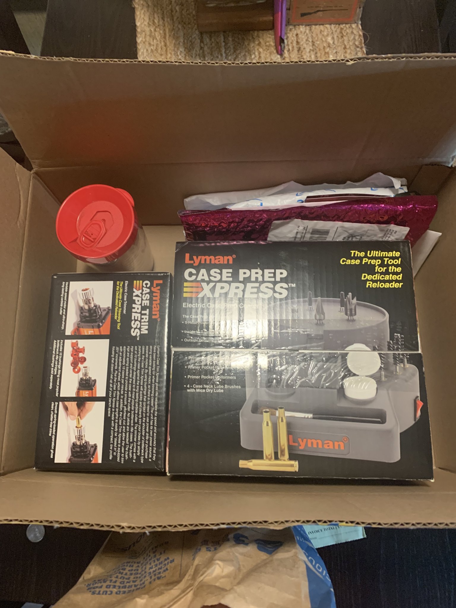

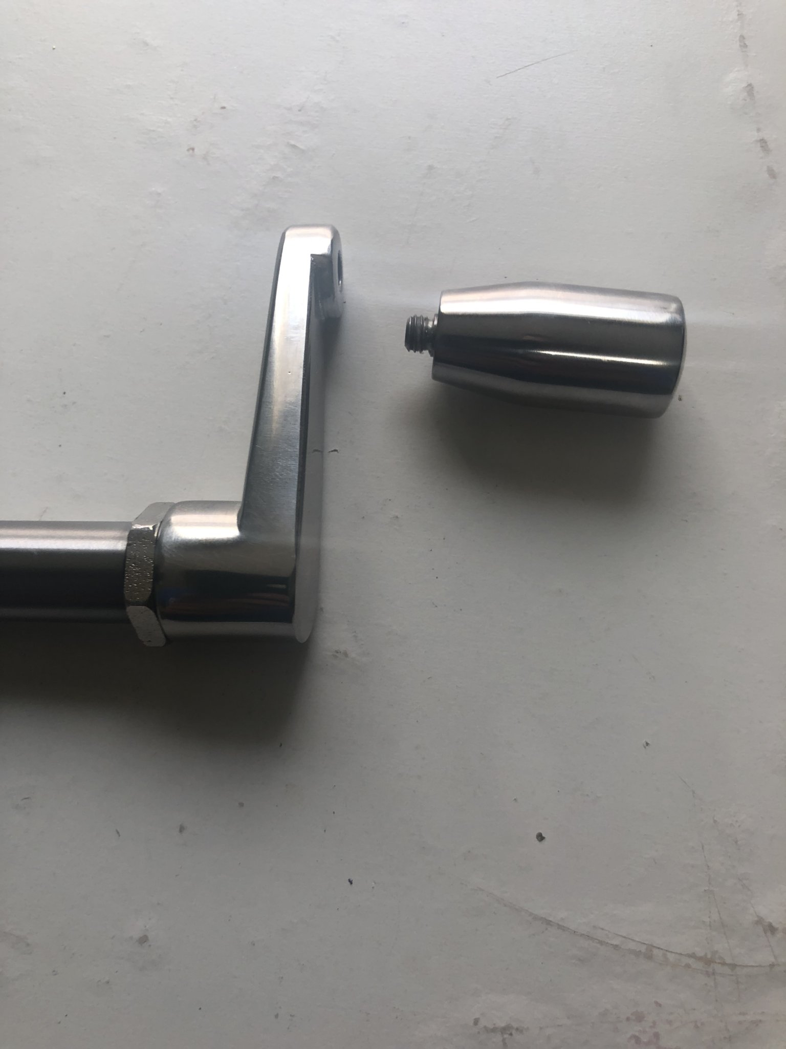

That was fun for five cases. So annoyed. There goes 179$

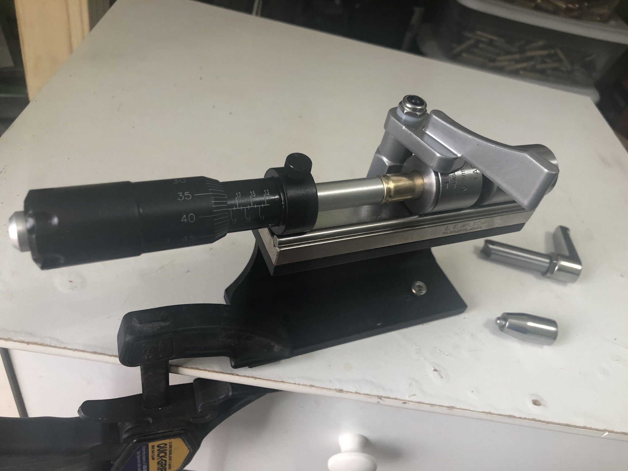

This is what I use and I quite like it. They got a new model with interchangeable chambers. Will be buying one of those for 308 and 223 when the time comes.
I was looking at the Giraud, but I am thinking about giving this one a shot. A little over $100 but it does several calibers.

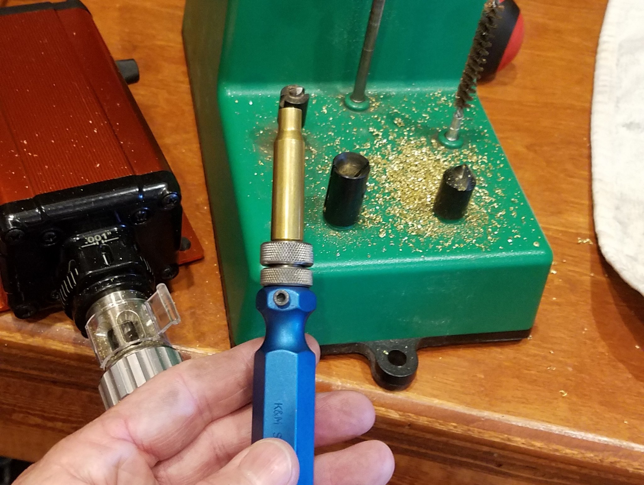

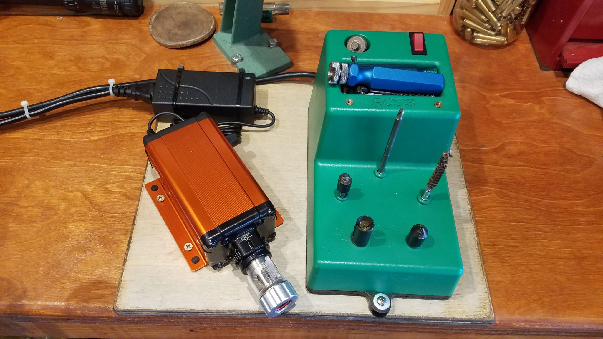

The Lyman is worth the hundred bucks.
I did find I get a more accurate length if I put the brass in a case holder instead of holding it by hand.
Plus, it doesn't fuck with my carpal tunnel as bad.
My K&M holder is probably in Iowa so I used this Lee until the new K&M delivered yesterday.
I mounted mine to a scrap of Luan along with the RCBS prep center.
Once I mounted it, I decided to do a timed test.
I took 50, 308 cases, lubed them with Oneshot (No, not him, it was the spray lube by Hornady), waited two minutes for the alcohol to gas off.
Resized all 50, wiped the lube, placed each case in the Lee holder, trimmed, chamfered, deburred and cleaned the case neck.
Once that was done, all 50 cases were primed with a Lee .
I didn't rush, I just worked at a steady pace.
Total time, 30 minutes.
I used to avoid trimming like the plague.
After buying this Lyman, I don't mind trimming at all.

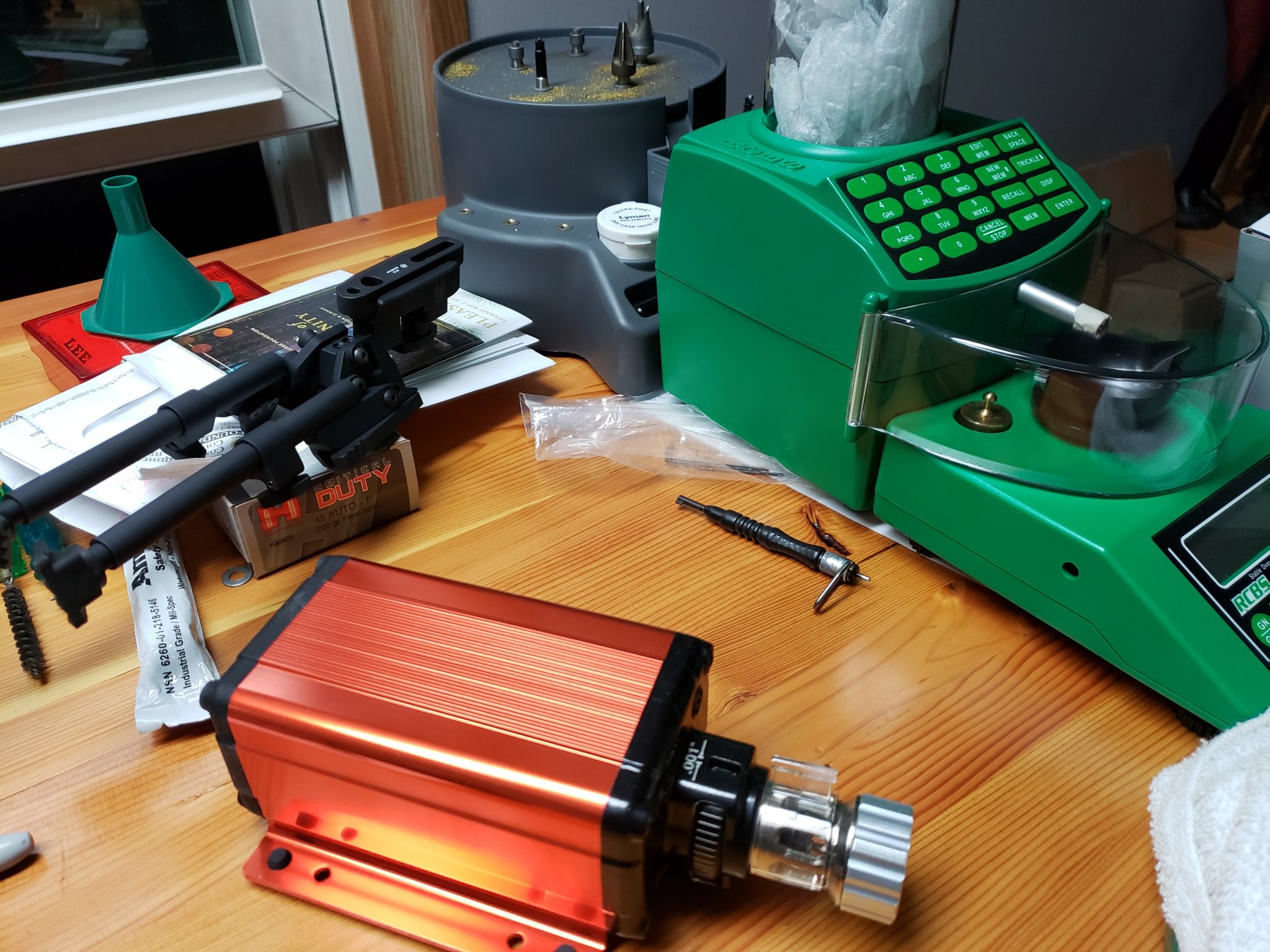

@Mike Casselton suggested the damn thing and that was good enough for me. ? Even got the Handle n Shellholders come'n. ?
For the money you're talk'n bout? I think it's gonna be a decent investment.
