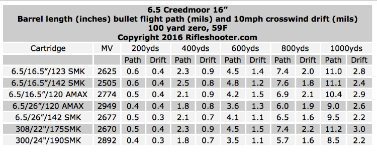

I am going to build a “lighter”weight 6.5 Creed AR. I want to with a 16” barrel but don’t know what twist to go with. Would 1:7 be good? Or should I just stick with 1:8?
This will be built on an Aero Precision enhanced upper (with the beefed up barrel retention system).
The data I am considering for a 16” is below.

Regarding the initial twist post, twist is only in barrel to achieve correct rpm spin. The actual rpm a barrel is capable of producing is dependant on muzzle velocity. So if barrel is shorter, faster twist could help stabilize the slightly slower MV depending on load.
