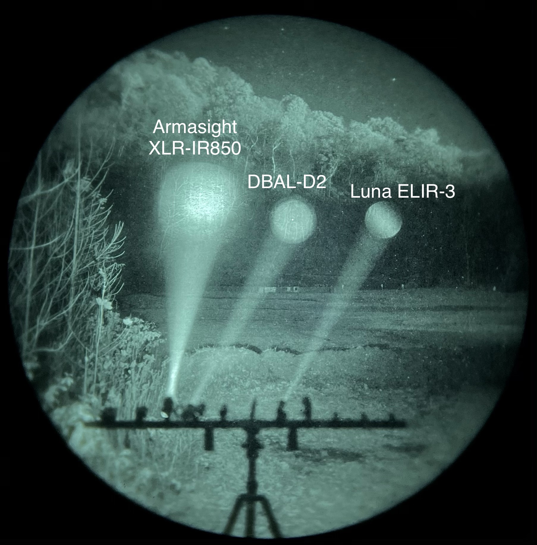

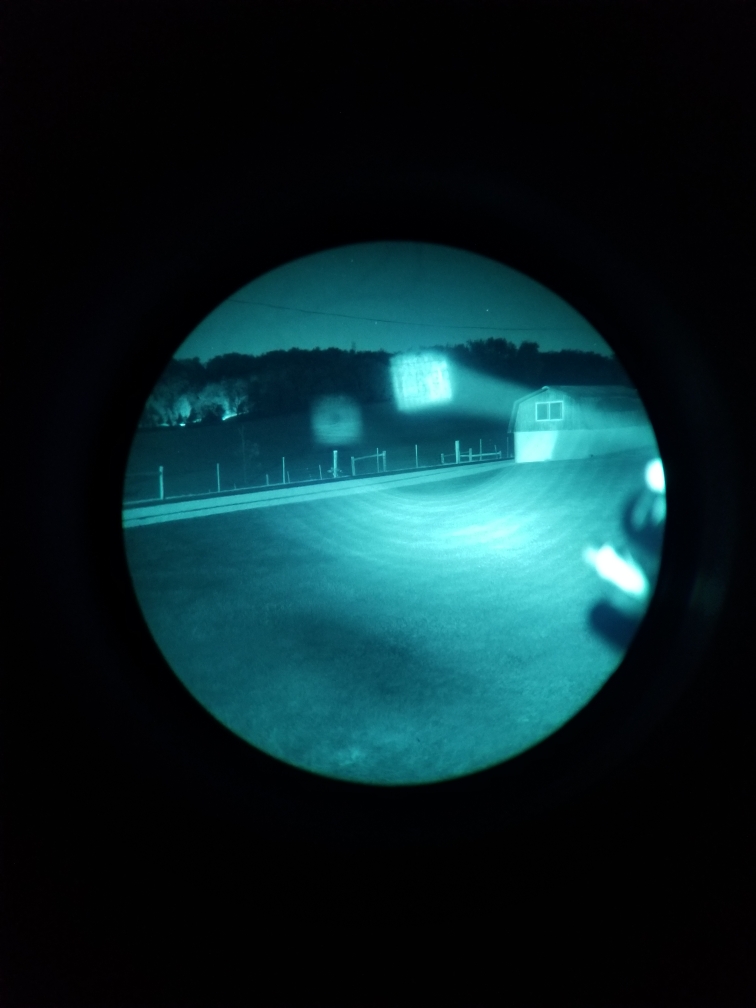

    Here is a quick pic @jwramp grabbed the other night of 2 of the mentioned ones if it helps for reference.

    I could be wrong on the dbal focus, but seem to recall the one I played with wouldn't tighten down. Threw a lot of IR out, but once we got past 400 yards it seemed to peter out compared to a peq where the usable distance increases as the beam is tightened.
    The rheostat adjustment on the perst is pretty cool and it seems to have as much, if not more, juice than my 45 mw peq.
    I own a DBAL D2 and for the price it is an excellent laser illuminator and one of the few non-MAWL civilian options that will reach out to several hundred yards. Many other popular civilian options seem to drop off as you go beyond 100 yards, so they are not great for hunting.
    You can control the beam width by turning the bezel on the illuminator. The manual says you can adjust it from a 2 degree illuminator beam to a 30 degree beam. At its widest it almost fills your viewport from a standard PVS-14 monocular. At its narrowest, the beam is maybe about twice the size of the narrow beam on the MAWL. The laser also has good reach to use for aiming.

    I'm consistently impressed with the ELIR, especially for $350 retail (B&H was the last place I googled and saw them in stock). Nice small form factor that tucks onto a side-rail a little easier than some of the larger laser units when you have a clip-on mounted, and infinitely focusable down to a small beam for when you're really zoomed in. Nice rheostat knob on it too if you don't need it full blast.
    You are full of crap. A dbal d2 can focus down just as tight as a mawl. If you don't really know don't comment on stuff. The dbal easily can be seen 500-600 yards on a full ipsc.

    You are full of crap. A dbal d2 can focus down just as tight as a mawl. If you don't really know don't comment on stuff. The dbal easily can be seen @900 1k yards in full ipsc.
    Does it increase the intensity of the beam, or just make the circle smaller? Genuinely curious.
    The d2 has a high and low output...300mw and 600mw. You can focus the beam from 2 degrees or wide open at 30 degrees...it's pretty much the best pointer/illuminator for less than 1.5k
