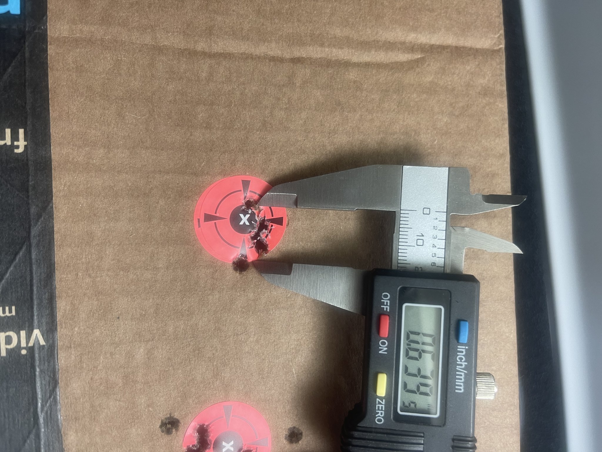

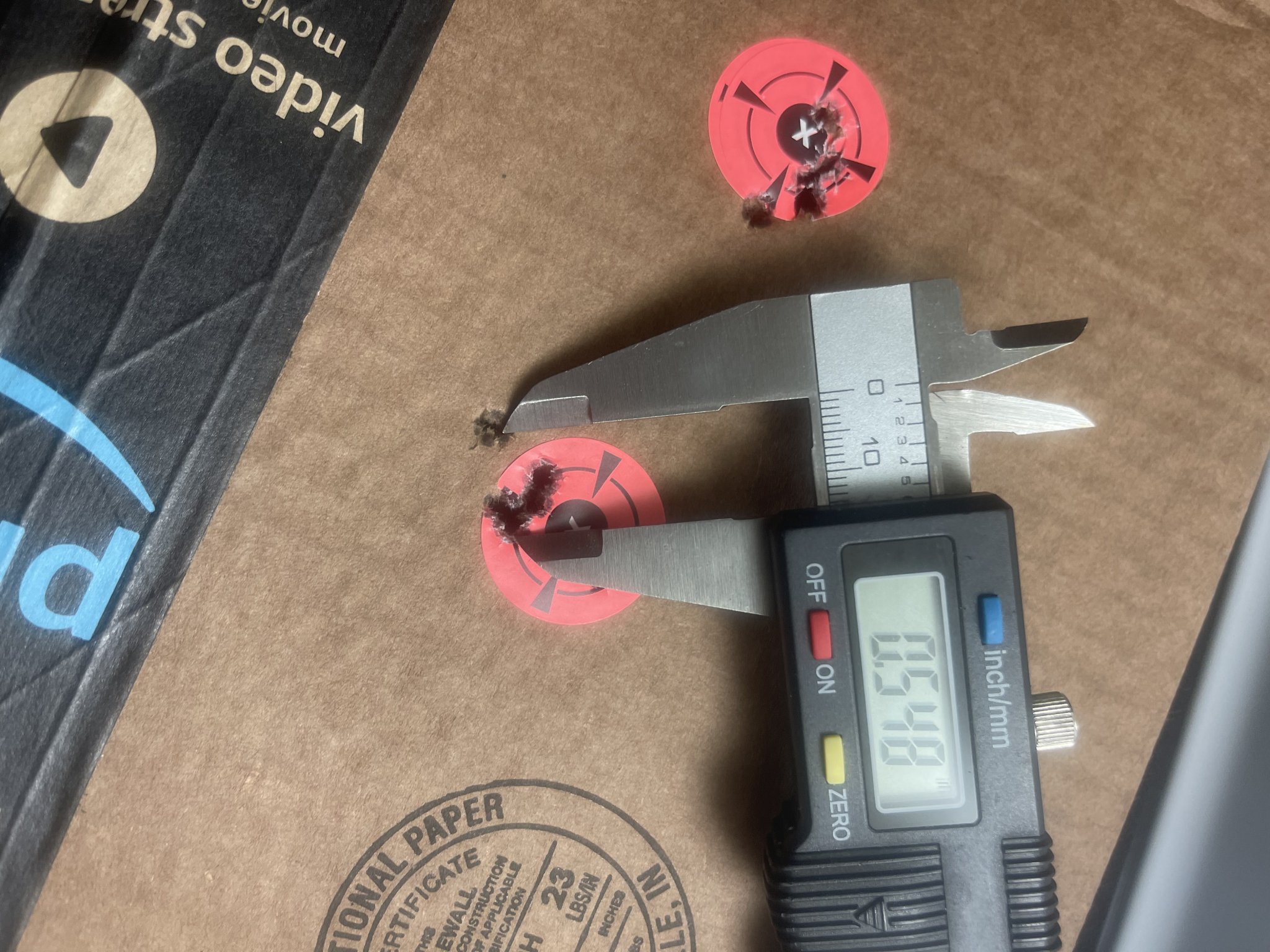

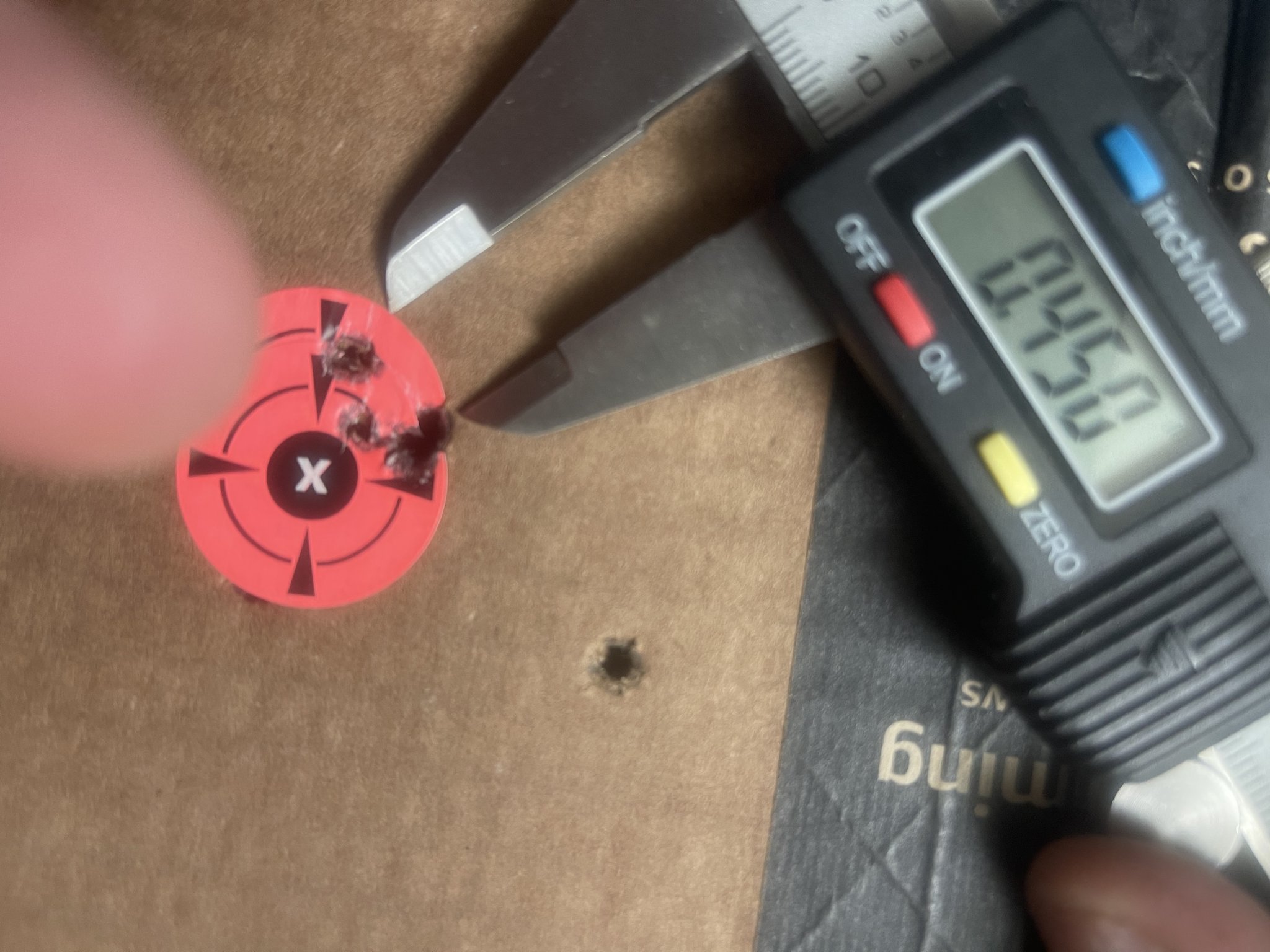

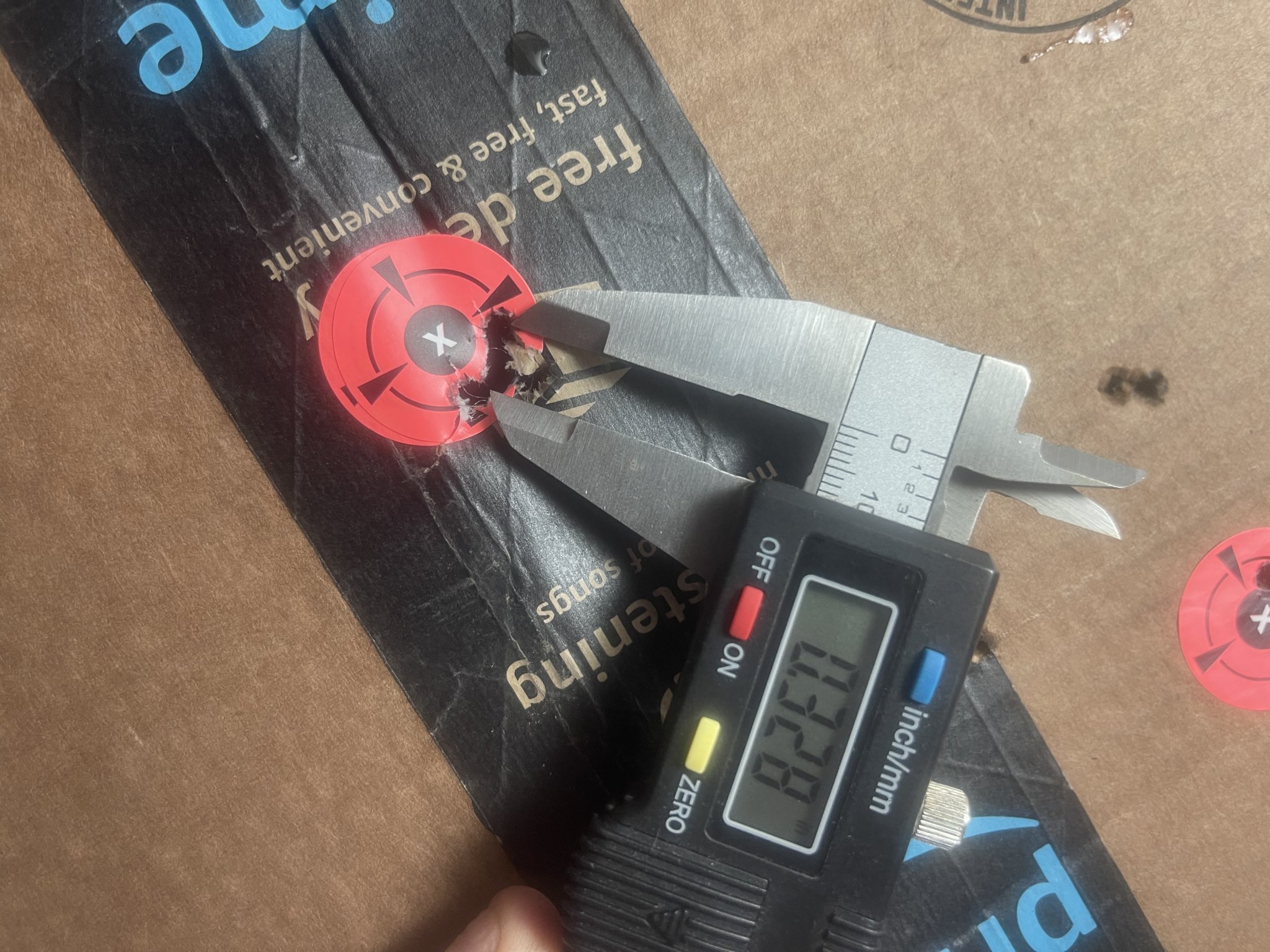

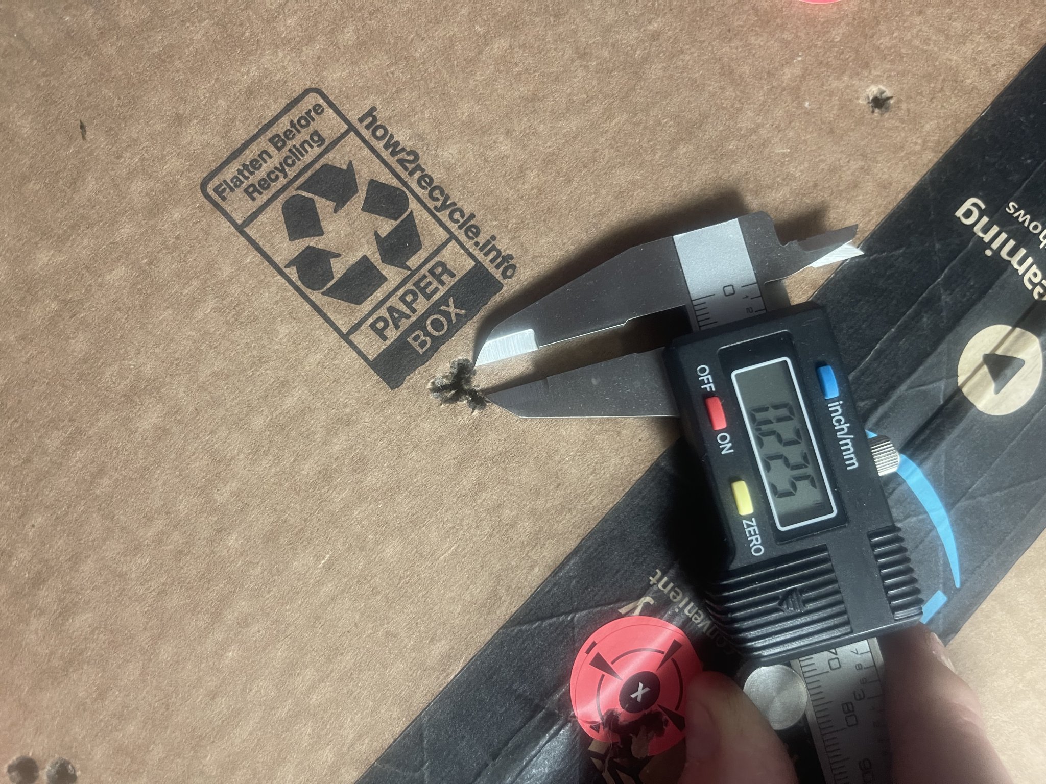

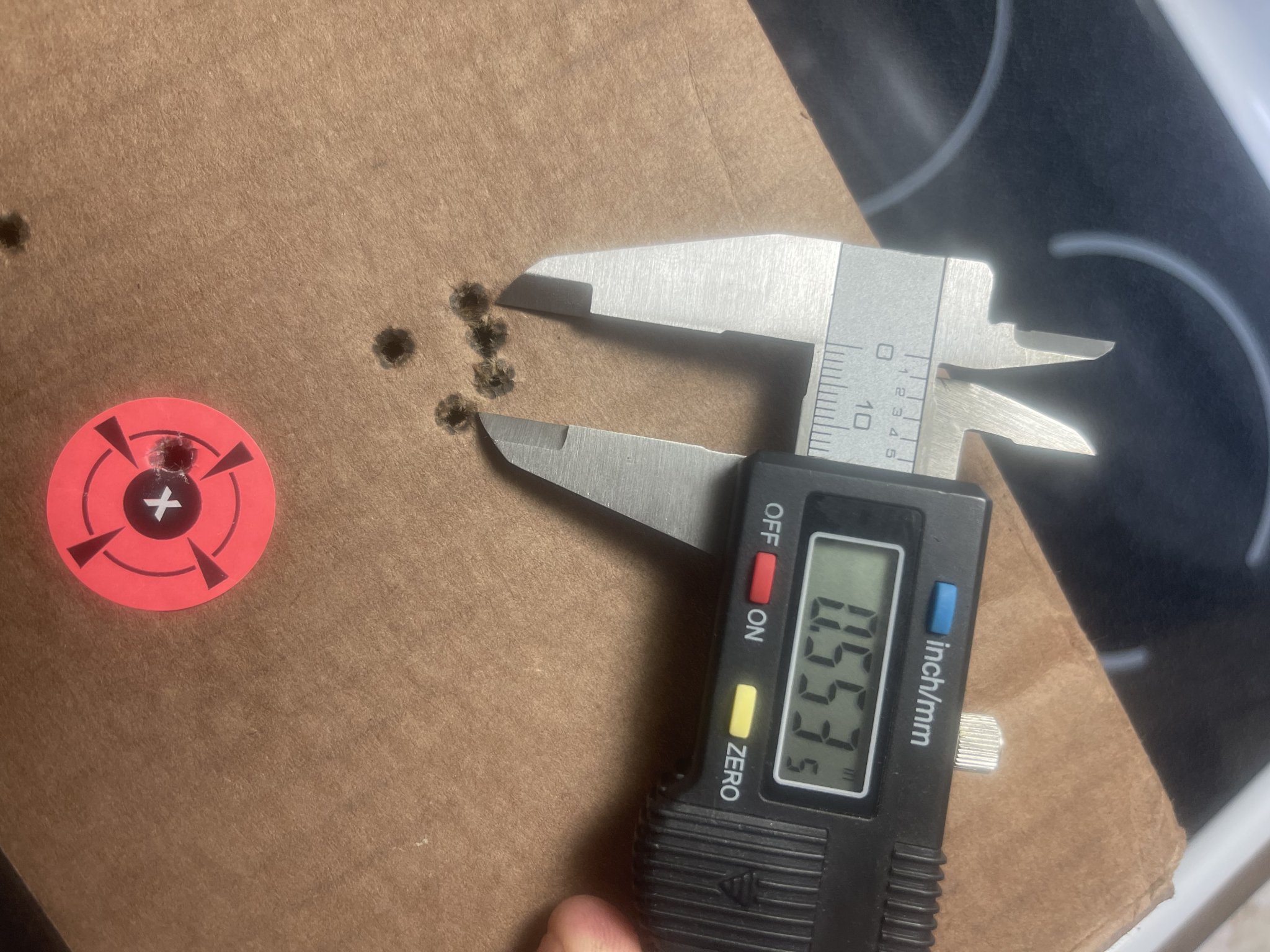

So how does this rate? B14R with SK LR match
50 yards
The 5 round groups in the caliper are legit. Some were shot on previously used targets. Hence the extra shots
Reactions: DubfromGA
I stopped checking groups. After looking at the grid thread I do that now when I zero my rifle. I make sure I’m within 0.2” or less at 50y shooting at intersecting lines. POA = POI is my goal. Could care less about groups unless I’m just wanting to see what I can do.

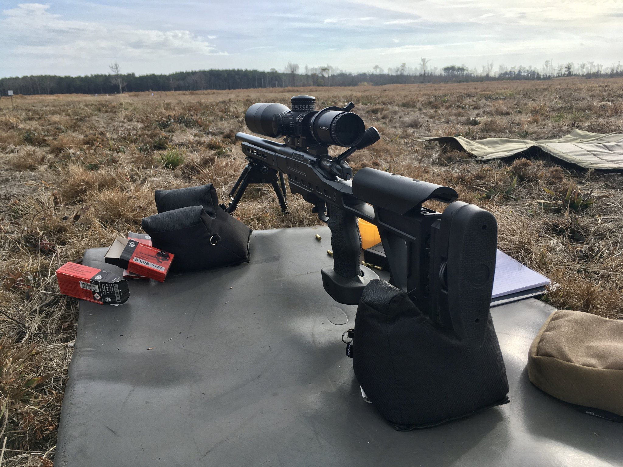

Pics of setup, rifle and view downrange.

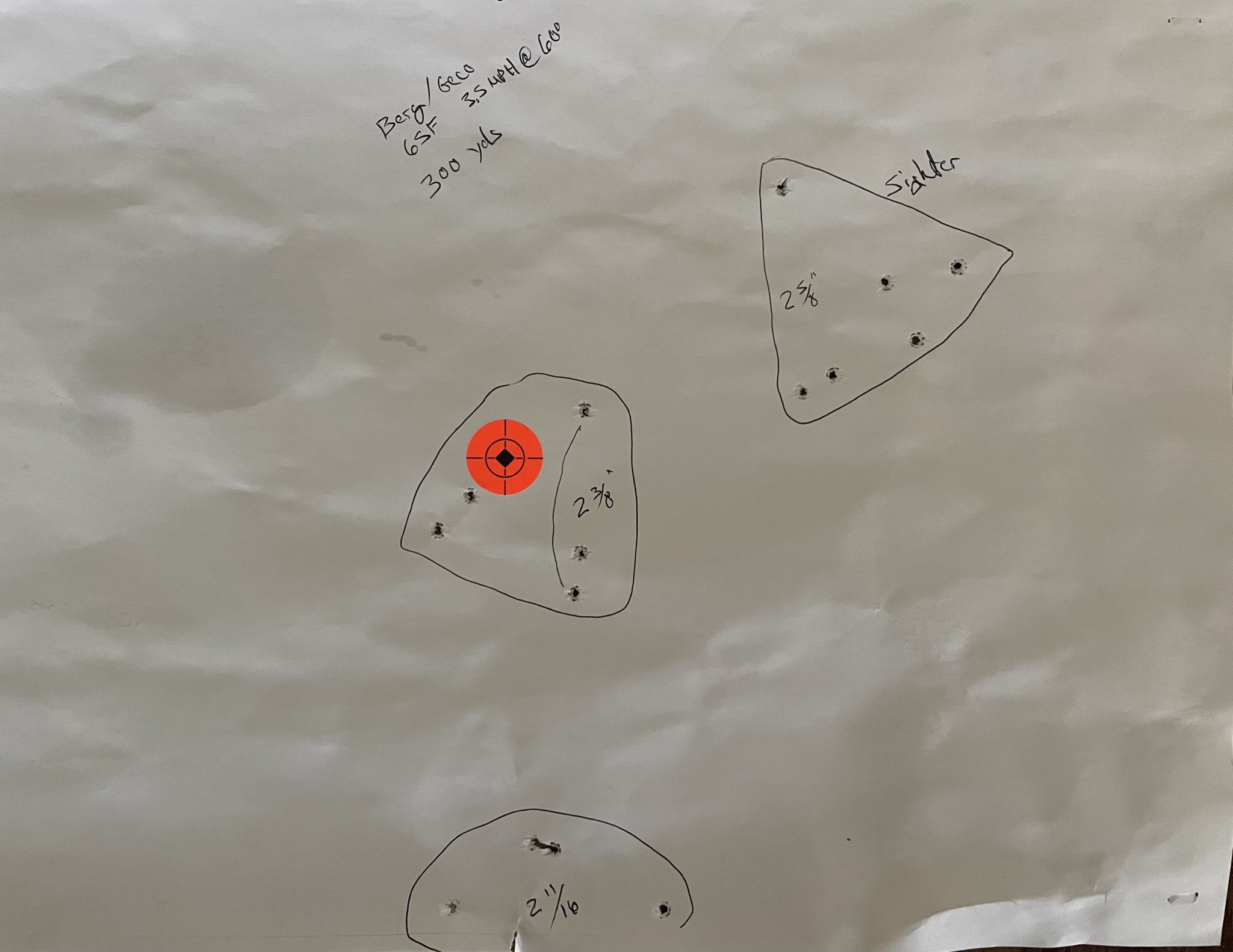

If I could do this (positional shooting) I would win ever 22PRS/MARS match I shot!!!
I'm pretty new to this but I'm with @DFOOSKING if you cant build a position quickly and negotiate obstacles and shoot in wierd positions it doesn't matter how good the rifle is shooting off a bench. 2 mil of wobble on a 2moa target is a big miss 99% of the time.
some useful thoughts and stuff here. my thing with wind 3-14mph (v rarely get less) is moa or less @50; hope for moa @ 100; 200 til skills increase 3 moa. solid tripod rest and rear bag. use good ammo tac 22 or "better" i.e. sk,eley,rws. decent rifles-anshutz,457 mtr,so limiting factor is me.
You are right on all accounts ... I'd never thought of accuracy in terms of group size. I'm banning myself for the rest of the day.

100y- 1.0” ctc
200y- 2.0” ctc
300y- 3.0” ctc
Basically 1 MOA at all ranges would give you a hit every time, assuming you are centered when you trip the trigger, have decent follow through, have read the wind correctly, your scope’s elevation dope is correct, and your gun/ammo’s cone of fire remains constant.

1 moa at 300 yards🤣 I gotta see this!!! What ammo you find that will do that Warren??
Geco Bolt Rifle sir.
(Edited to add), You may have shot with Derek Heinrick who also fired on this same target with my rifle and then his own. He, Kenneth Gage, Ray Griggs, Richard Senn, an I were screwing around on steel out to 507yds.
I preferred to see what my gun was doing on paper after a recent tune, but stopped at 300 and switched to steel. I’ve invited you to come down and shoot with us on Facebook, and I’ll extend the same open hand here. I hope you will take me up on it.
Since folks think I’m cherry picking and bragging: Ray fired 5 rounds at 200yds on another day, through my 40XB that was under 1”, and that was with CCI SV.
If that is fairly common for your rifle and ammo then that is very impressive. What was the conditions when you shot this particular target (wind & temp)? Is this typical for any lot of Standard Velocity or just that particular one? What rifle again? Just curious…

Thank you, I saw that. I was looking for a little more specific, like gusting / switching / what vector / rifle build specific. Really not a big deal, just curious.
Reactions: BisSilent
Rifle: 2019 Bergara B14-R in their BMP stock. Set up the way I’ve written in the past, not just thrown together. 40MOA steel NightForce rail and 1.060“ MPA BA mount/ring assembly, Vortex SE in MOA. Factory trigger.
This was after tuning the action screws (torque). This day I didn’t chronograph, but from experience with the ammo believe it would have clocked 1065fps.
Ammo is Geco Bolt Rifle, purchased before the pricing insanity for less than $25. a brick.
Winds were light but fairly consistent with few gusts. My bullet drop app was fairly close until reaching 300, afterwards things got screwy. I’ve since learned to tweak to match true (real world) it by juggling bc and scope height, but after 300 I need range time to map things separately.
BTW my Geco ammo bears the RWS headstamp, I’m unaware of what it may correspond to in their house line-up.
