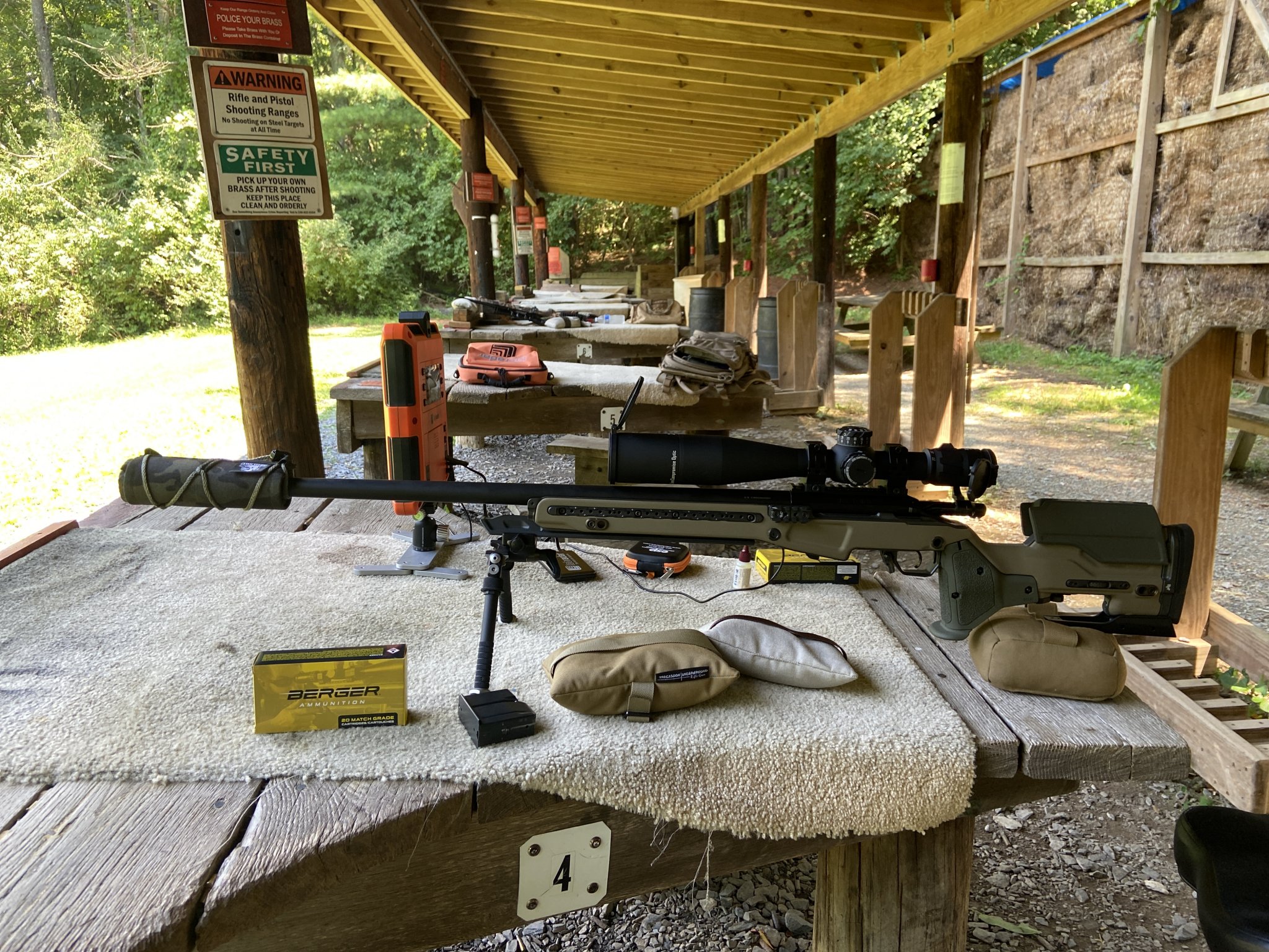

I actually went the opposite way of thinking like an F-Class or true bench gun with the big front clamps and obscene weight. But then again I complain that my AI is a pig at 18 lbs. Who knows what this guy wanted.
Reactions: Baron23

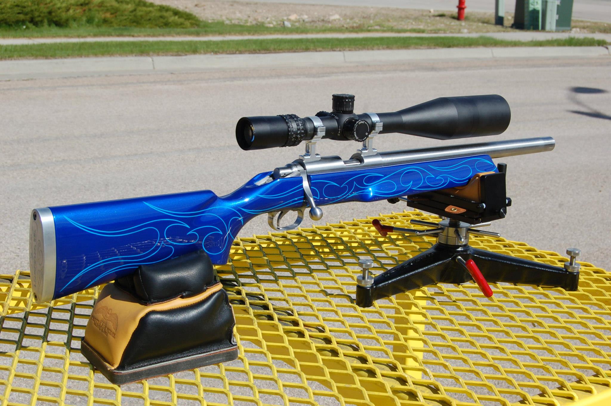

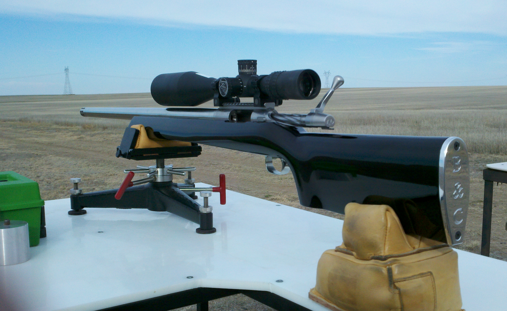

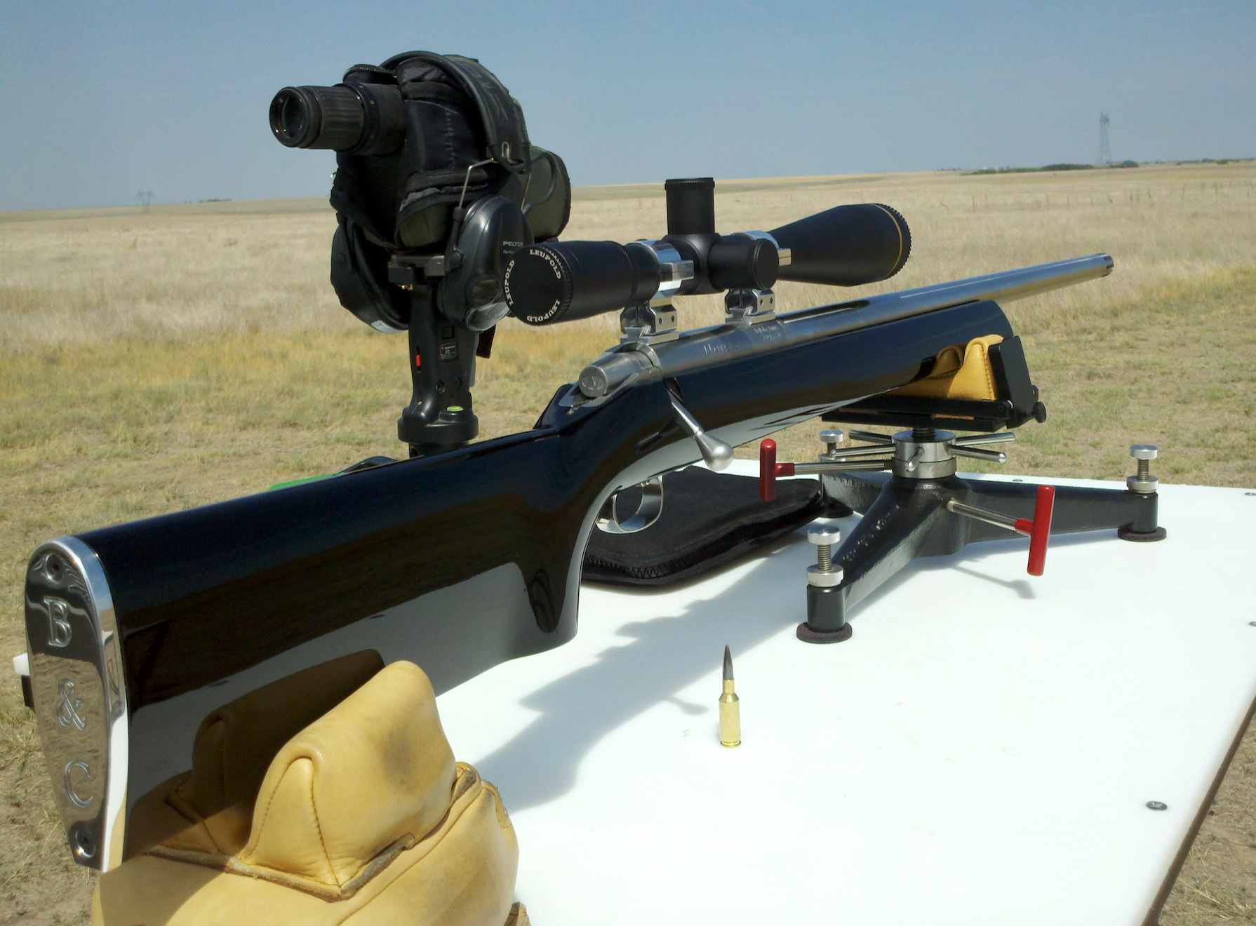

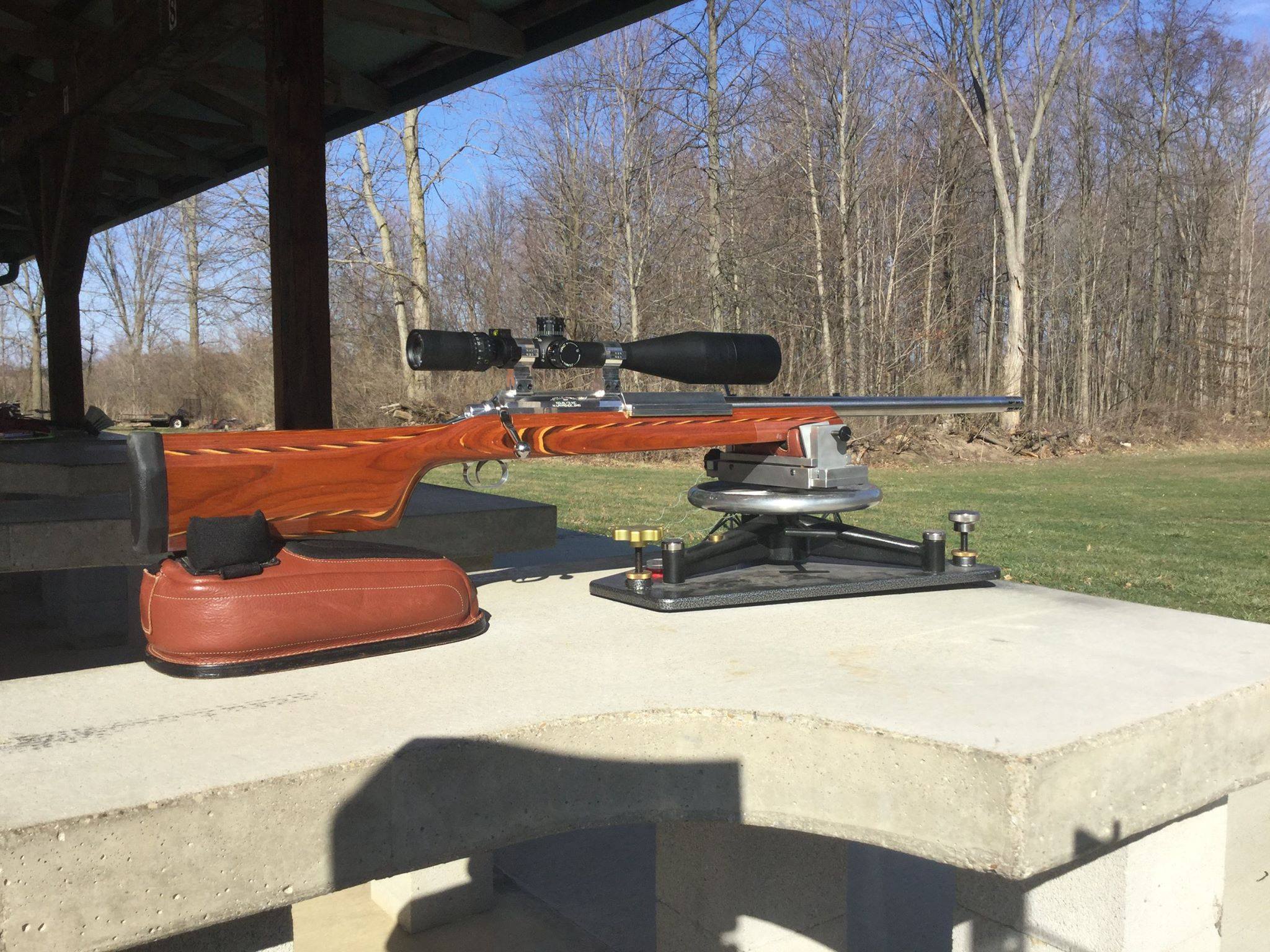

I built this in 2011 for a local Varmint Silhouette fun match. Started off with the Leupold Fixed 45x and a Kelbly's 1000M stock. Then I made a couple changes.
Nesika Action, Left Port, Right Bolt
Bartlien Barrel
6BR
Jewell bottom safety trigger
Kelbly 1000M I duplicated because we don't have a weight restriction and I wanted about a 7.5lb stock at the time I built it. (full bedding chassis that goes the entire length of the stock from the forend tip to the butt plate.
-I have since shot a few matches where there was a weight restriction so I swap stocks for the original Kelbly's.
Nightforce 12-42 NSX & Rings (NP2DD reticle but if I could do it over it would have likely been something like the NPR1)
Had a local body shop paint the stocks for me.
I built it for the VS matches and absolutely fell in love with it. Just fun to shoot and crazy consistent. Happy I went to the NF scope for the shooting and testing I use the rifle for today.
In the VS matches we shoot prone and off the bench.
When I built that rifle it was the same time the 6 Crusader came out, and yeah I built one of those in a PRS style rifle. Always wanted to build another BR rifle like the one pictured in 6 Crusader.
***Only issue with this gun is in the Western KS wind, I have to clean the bolt between sessions of 50 rounds give or take. A little dust goes a long ways on that action.
I did upgrade bags and front rest since these pictures.

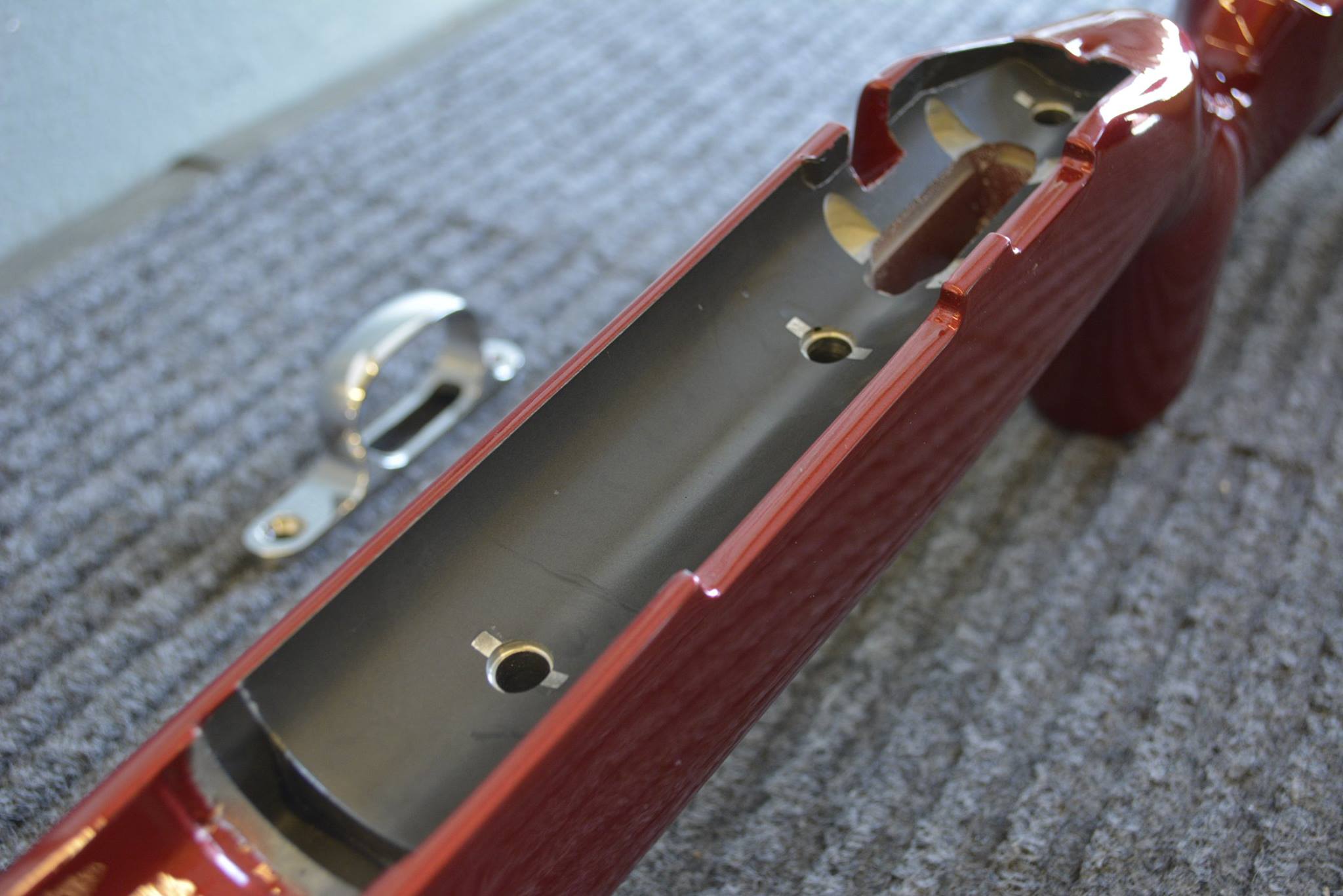

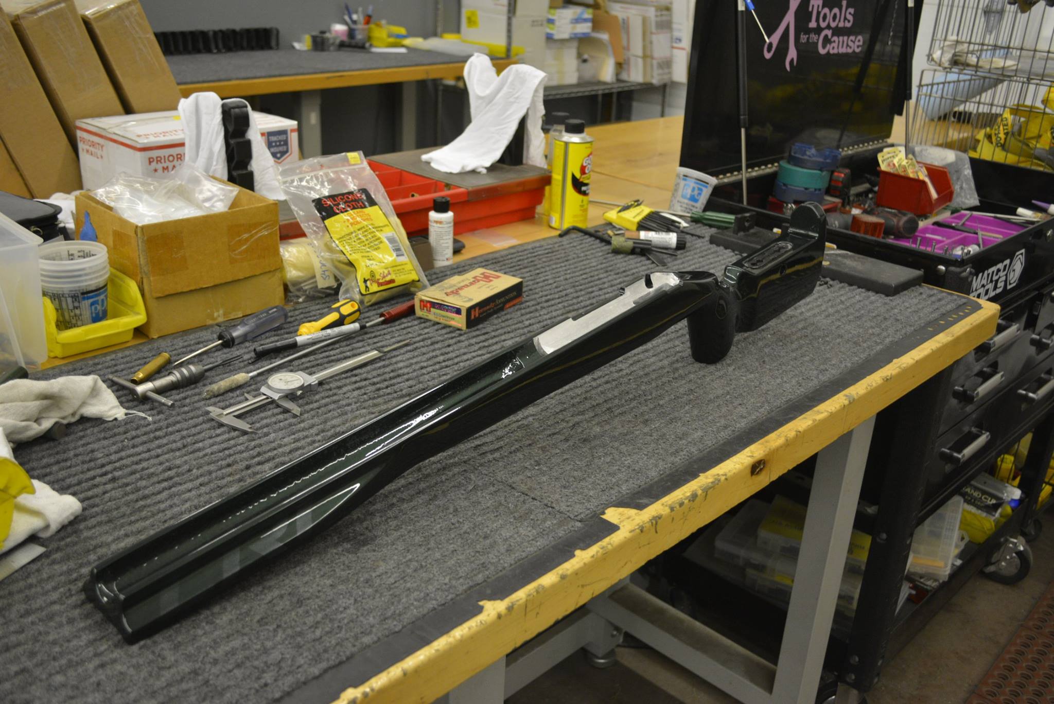

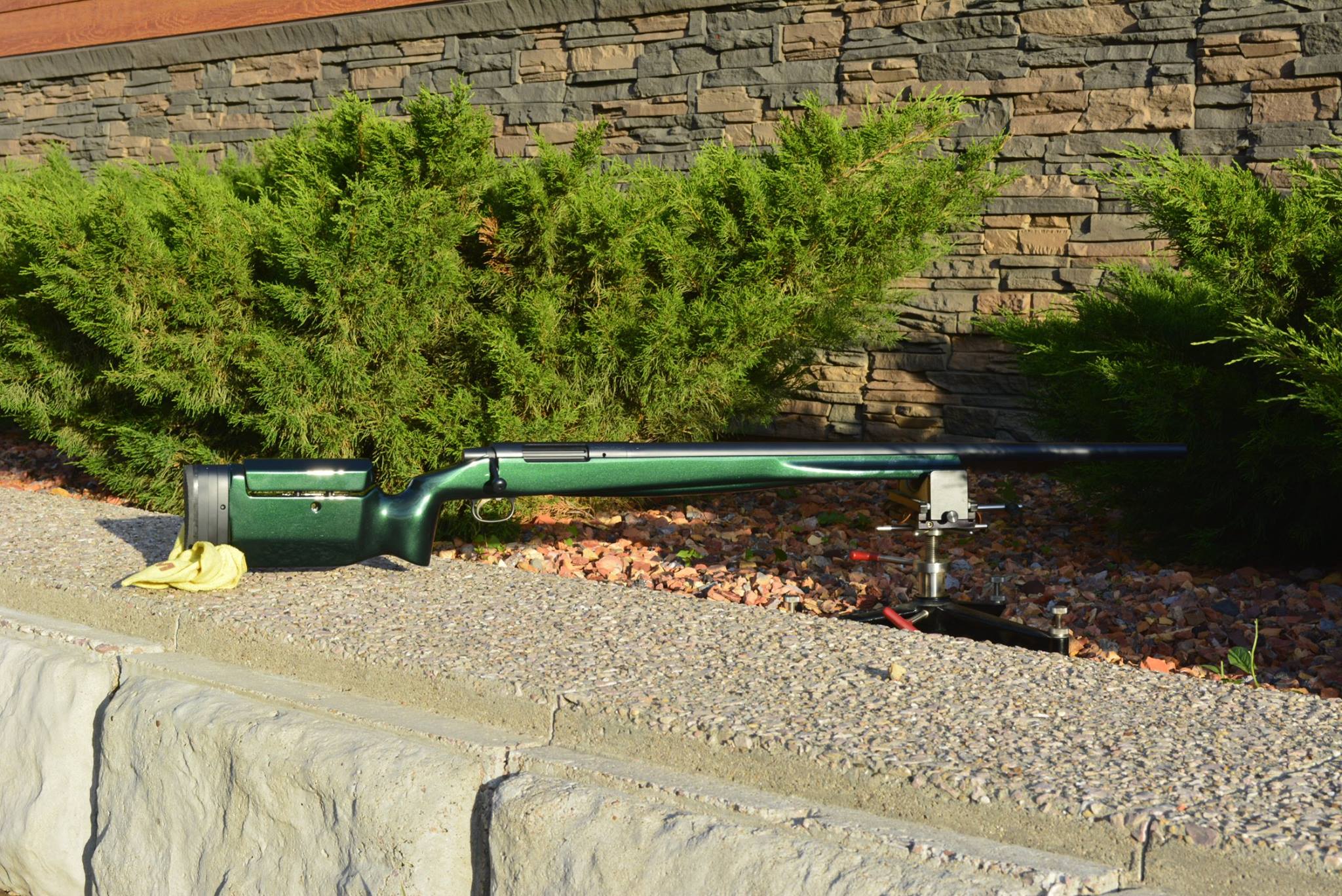

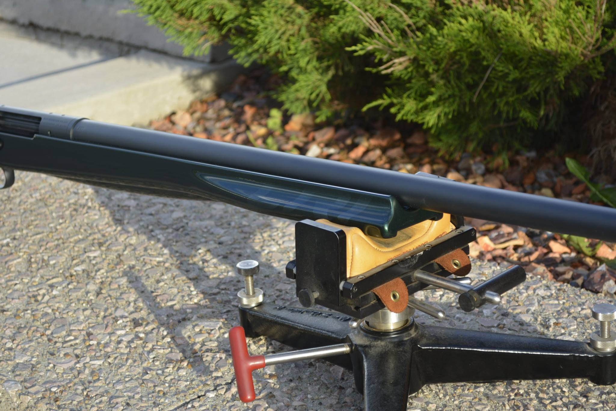

An example of what I've done for folks in the past.
Happy to help.

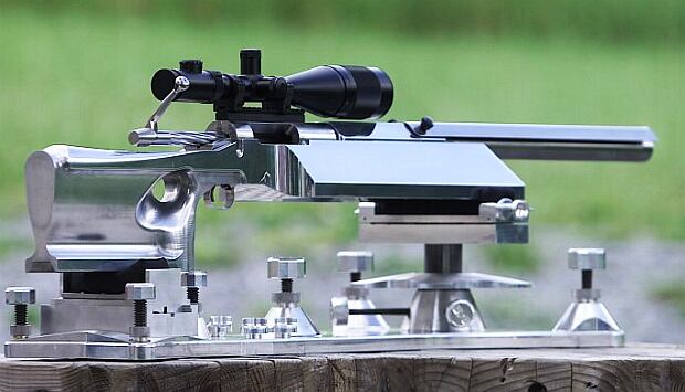

The man did say “bench”. So, I suppose something like this would be the ultimate (picture borrowed from 6BR Forum)
However then he changed the parameters. So, if I was going to choose a “bench” gun that was really something like a PRS rifle, I suspect A Manner’s or Foundation stock or an MPA chassis, A decent barrel, of your choice. (I have had superior results with a Shilen, but the MPA barrels I am using are pretty good) any of the good actions available and a nice tigger by TriggerTech or Bix n Andy.
However then he changed the parameters. So, if I was going to choose a “bench” gun that was really something like a PRS rifle, I suspect A Manner’s or Foundation stock or an MPA chassis, A decent barrel, of your choice. (I have had superior results with a Shilen, but the MPA barrels I am using are pretty good, any of the good actions available and a nice tigger by TriggerTech or Bix n Andy.

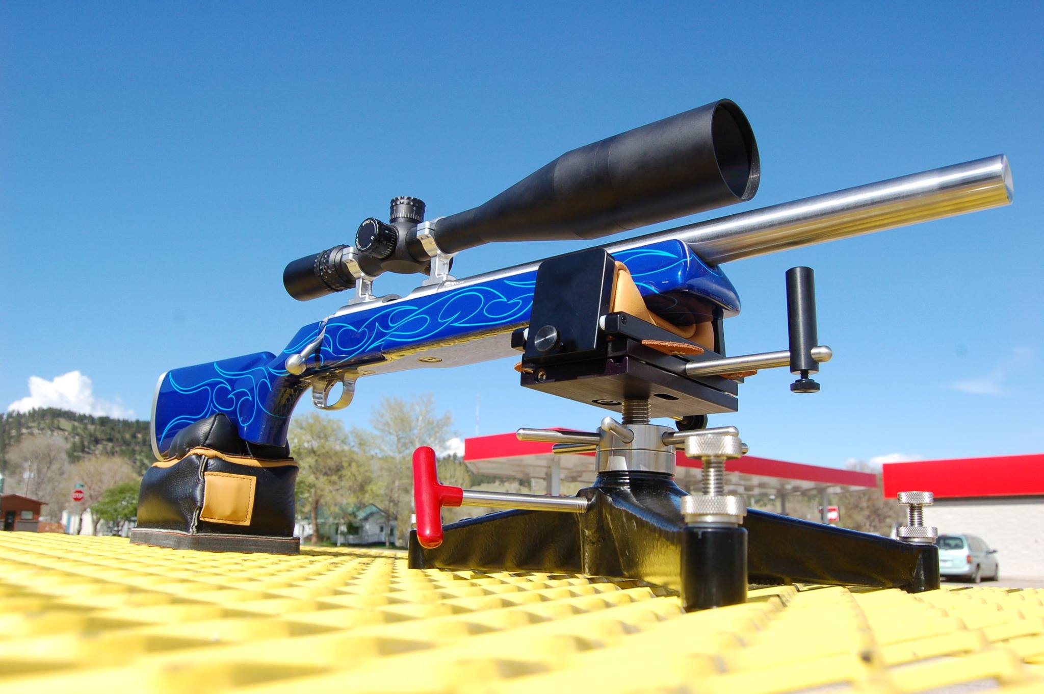

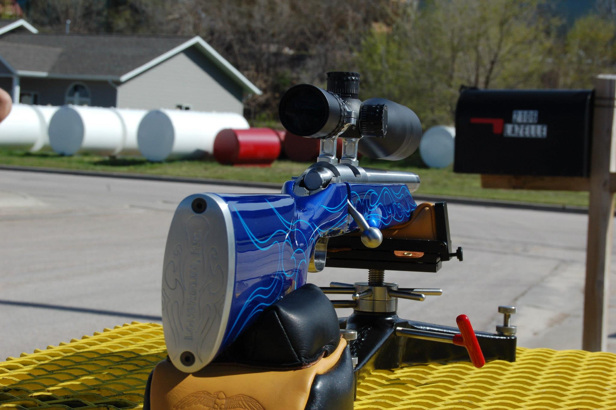

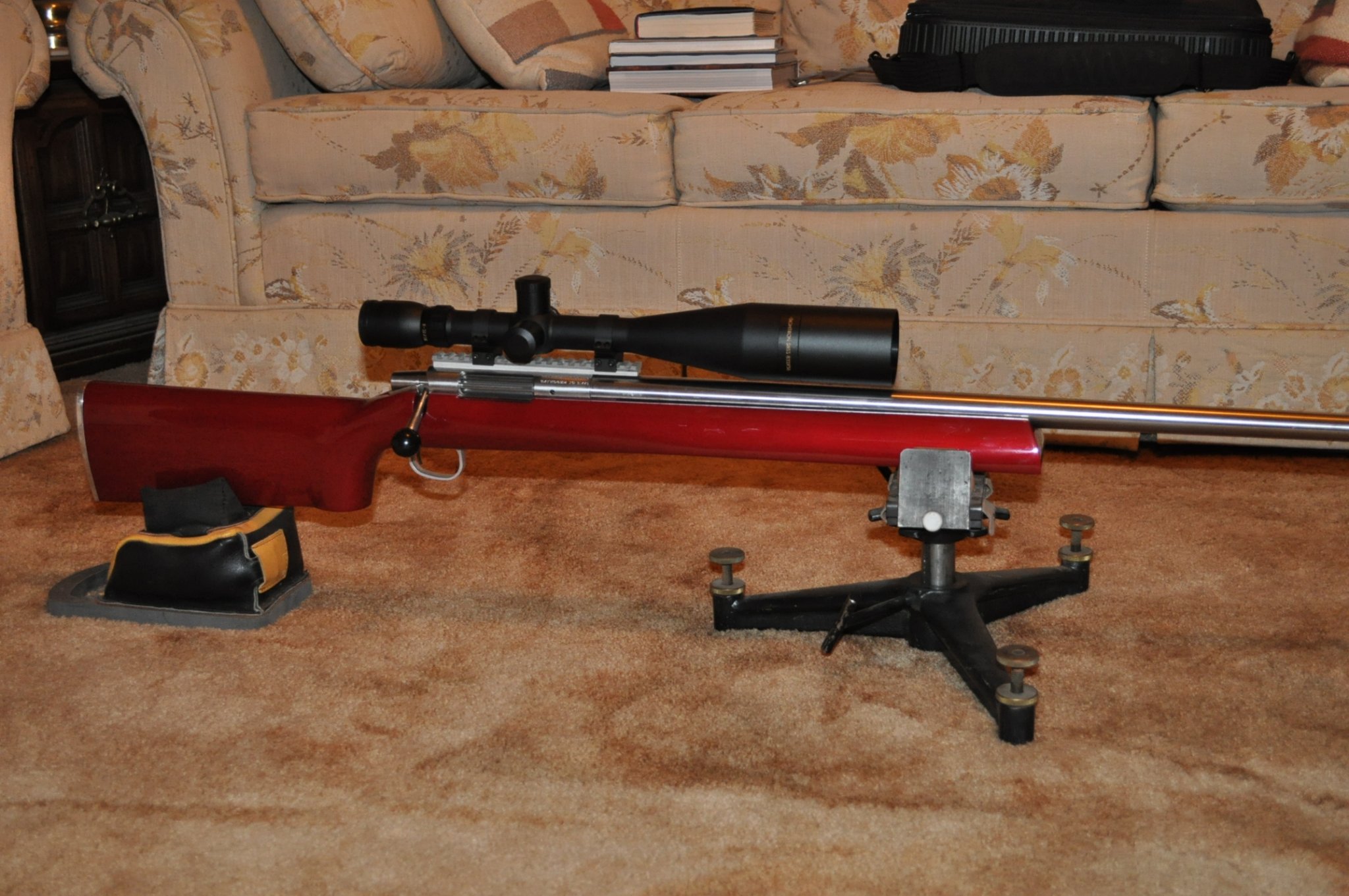

1000 yd benchrest light gun, Shehane MBR stock, Kelbly's F class action left port right bolt, Jewell benchrest trigger (2 oz), Hart barrel , Vais brake, and is chambered for 6.5 x 284 Shehane.

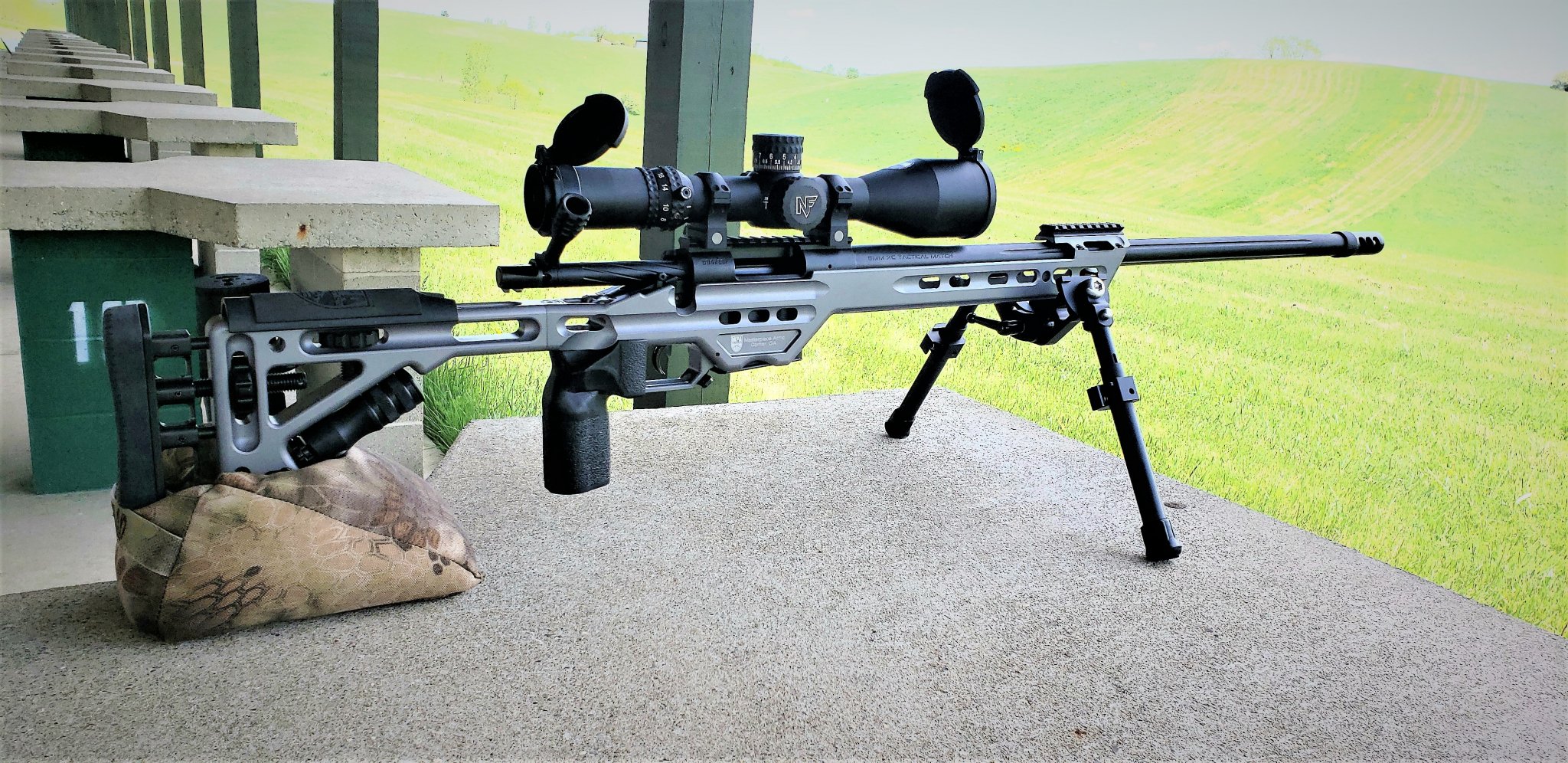

For a non-dedicated BR rifle, MPR chassis, Defiant action, Huber 2 stage trigger, Bartlein barrel, Hellfire brake, Caliber 6XC
Either one should fit your budget. Like other have advised figure out what you want to use it for then pick the best components you can afford in a caliber that fits your needs.
OMG, I didn't even know guns like this existed !!!!!!!
Reactions: Dead Eye Dick

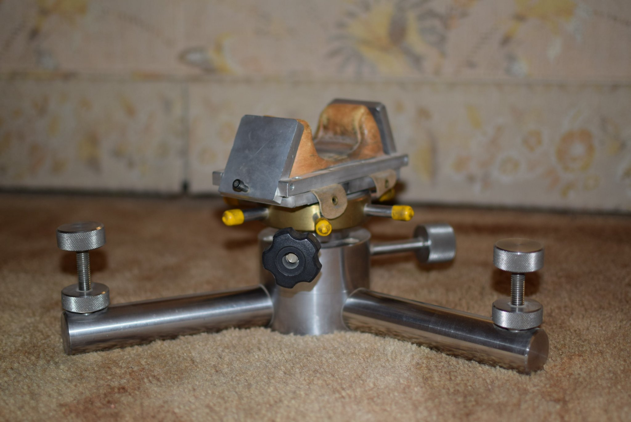

The rests alone are quite expensive. Most guns weight between 60 and 80 pounds, but guns up to 200 pounds have been tried. However, the recoil characteristics of the very heavy 160 to 200 pound rifles (according to the author of this article) don’t recoil smoothly and throw shots out of the group. Anyway, we think, PRS is expensive. I suspect this can top er.
1000 yard Bench Rest Guns.
I shoot the same BR Varmint Silhouette matches that Gunner 75 mentioned. He was generous enough to supply one of his prototype heavy BR stocks to me for the BAT 3L rifle I built in 6 Dasher for these matches, and I took it to the same body shop for Ford electric red paint. That's a Sightron SIII 8-32x56 scope on the BAT. I went with a Bartlein hvy Palma bbl with 1-7.8tw & a Vais brake, but after shooting with that brake under a covered firing line for a couple of years, I parted the threads for the Vais off and cut 5/8-24 threads for a TBAC CB mount, and then sent my old 30BA can back to TBAC for the Ultra re-core program. Unless you've shot a rifle with a radial brake like the Vais & then switched to what's essentially an Ultra 9, you can't appreciate how much more pleasant it is with the can! I only used my old 2nd-hand Sinclair front rest for the photo - built myself a heavier home-made stainless rest as the 1st project after I'd bought my vertical mill. It's all surplus SS from the Yard in Wichita, which IIRC, cost me about $45. If you ordered in enough 303 SS to build one like it today from one of the online outfits that sell small orders of metals, it'd cost about $600. Nowhere near as nice or useful as a SEB or other joystick front rests available today, but it's still a neat old traditional front rest, and I get by with it. I used it in the only formal 1000yd BR match I've ever shot, out at CRC near Byers, Co. back in 2007, and shot the small group of the day in the light rifle division during the State Championships that year with another Dasher, which was just a 30" med Palma Dasher bbl on my Nesika Palma rifle - with no ejector, I was really hustling to get five shots off in the same condition...good reason to use an action with a drop port or at least an ejector so you save a lot of time if you're group shooting.

If a single shot will do then look no further than this guy.
But for 1500Y I'd go for 300WSM.
Both of these cartridges represent two of the most balanced long range cartridges around and have the records to prove it. Also get good barrel life.
You want high precision and a low ES combo.
Reactions: zorro13
