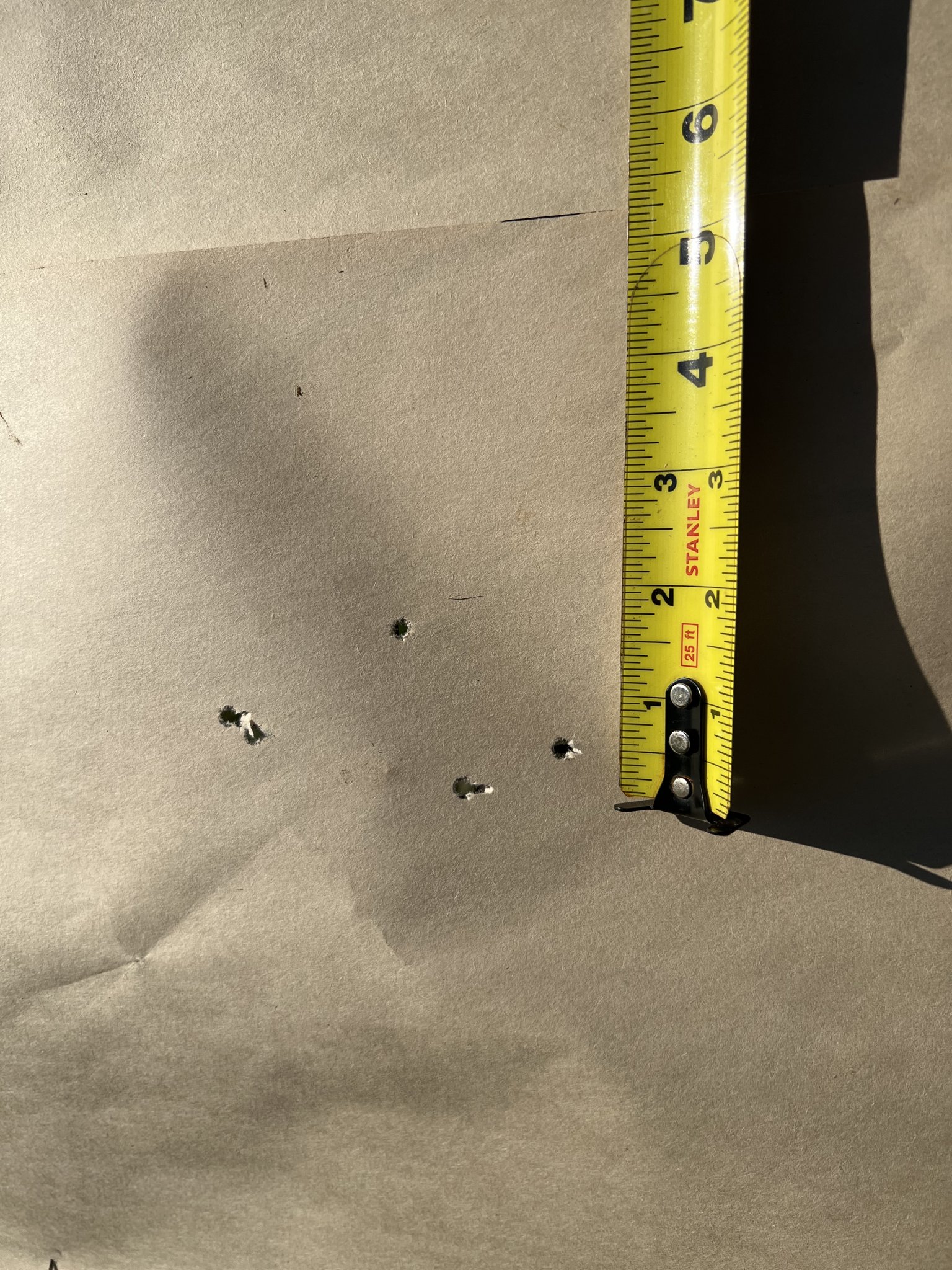

    I was prepared to get some data today on my #1 squirrel rifle. Planned this last night. Check zero and 200 yard drop to prepare to build a 25 yard increment reticule for the 6X Unertl.
    It was warmer than I liked and the wind came up early. 70 deg and 2:00 wind 4-7 mph.
    50 yard zero was confirmed prone with sling. It was as usual, perfect. By that I mean I shot at a .22 bullet hole three times and it looked only very slightly larger through the scope. All good.
    Moved to 200 yards. Checked range with laser from both ends. I did not touch scope. Prone with sling. Used a very tall target and measured drop with tape measure. (What did you expect from a guy that shoots a 75 year old rig?) This was data to build reticle.
    Photos will show that the 200 yard group had less than 2” vertical. Wind almost doubled the horizontal.

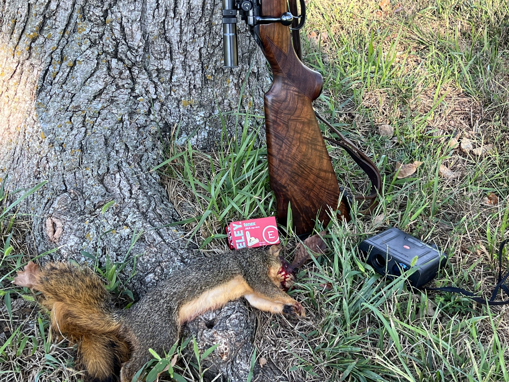

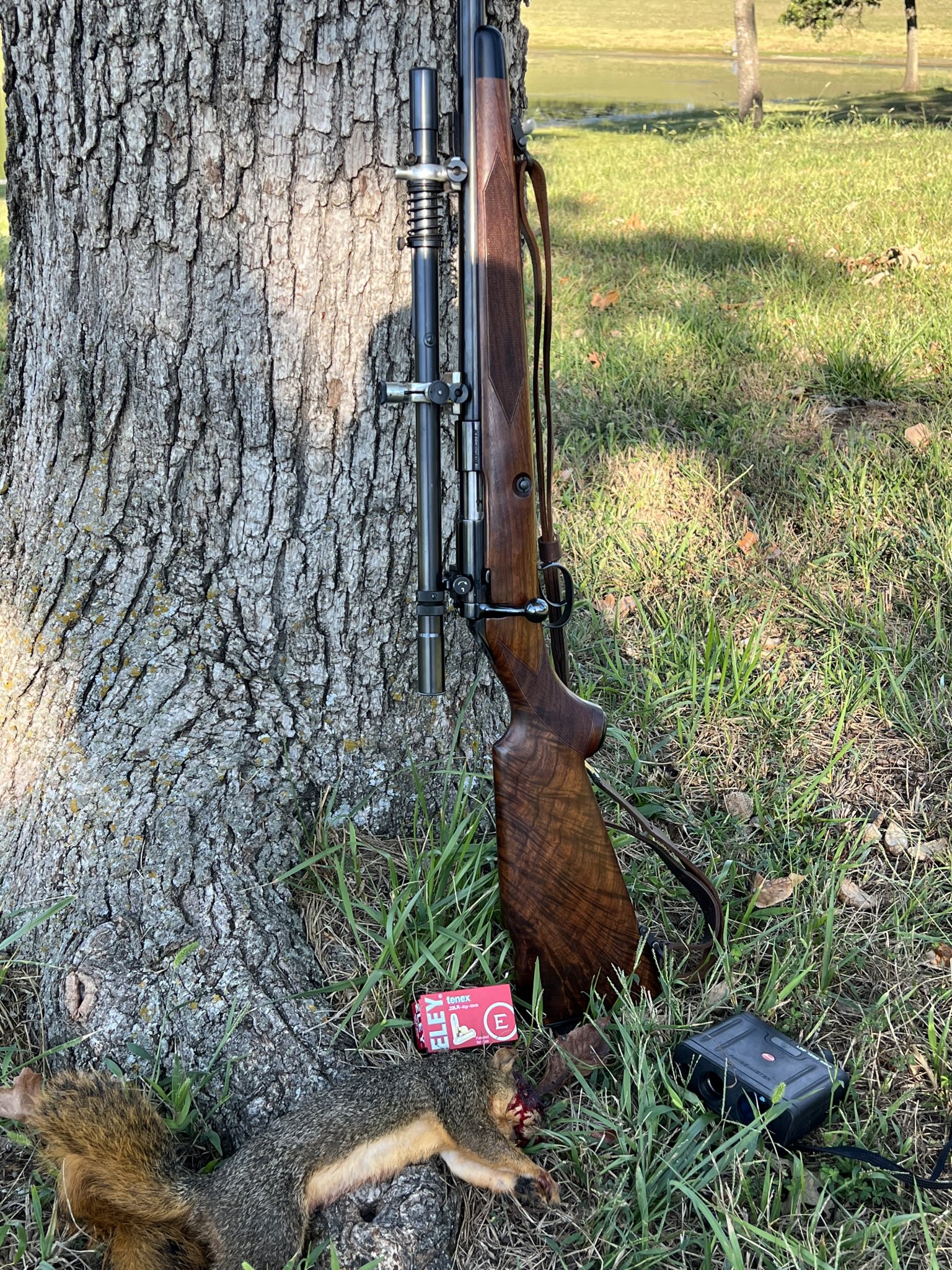

    Once done I noticed a squirrel barking at the sound of the shots. I lasered it at 138 yards.
    Dialed my 140 yard data and held bottom of jaw. Still prone and in sling.allowed what looked like 1.5” for wind. Result below. I was a little lucky on my wind hold. Not lucky that I killed the squirrel but that I hit the eye. The more I shoot the luckier I get. 57 years of shooting squirrels with a .22 has taught me a few things.
    Get good rifle and ammo.
    Gather good data.
    Trust your data and set up.
    Don’t be afraid to turn one loose when it looks right.
    Pessimistic thoughts ruin shots.
    I might get a tattoo that says that 😂
    Rifles that don’t shoot great groups don’t do this.
    Rifles that don’t hit what you aim at don’t do this.
    Ammo is a very selected lot of Eley Tenex EPS I was fortunate enough to secure.

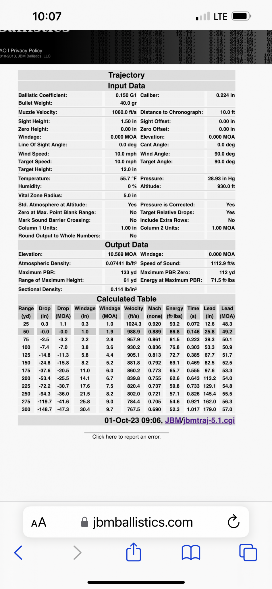

    Posting up this data Eley Tenex. EPS.
    This lot has unusually low ES and holds great vertical at range.
    Data was verified over a two year period.
    Cross posted in the Trajectory thread.
