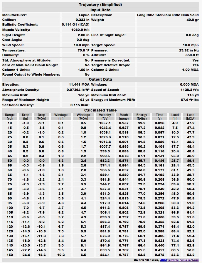

Both the ballistic calculators I tried show a hold-under some distance past 25 (with 25yd zero)...unless I shrink the scope height all the way to 1".
As Trigger mentioned, finding the apex distance, and making that the zero, is the only way (I can see) to prevent having a hold-under somewhere. This should benefit the shooter regardless of match distances. The only reason I can see to zero at some distance other than the apex, would be in an effort to extend your 'point blank range', where small misses are ok in the name of speed. (hunting) https://www.americanhunter.org/articles/2017/7/17/learn-your-maximum-point-blank-range/

With a 50yd zero the bullet apex is actually NOT 50yds but around 35yds (dependent on sight over bore height). JBM does have Eley, RWS, and Lapua/SK/Wolf projectile data:
