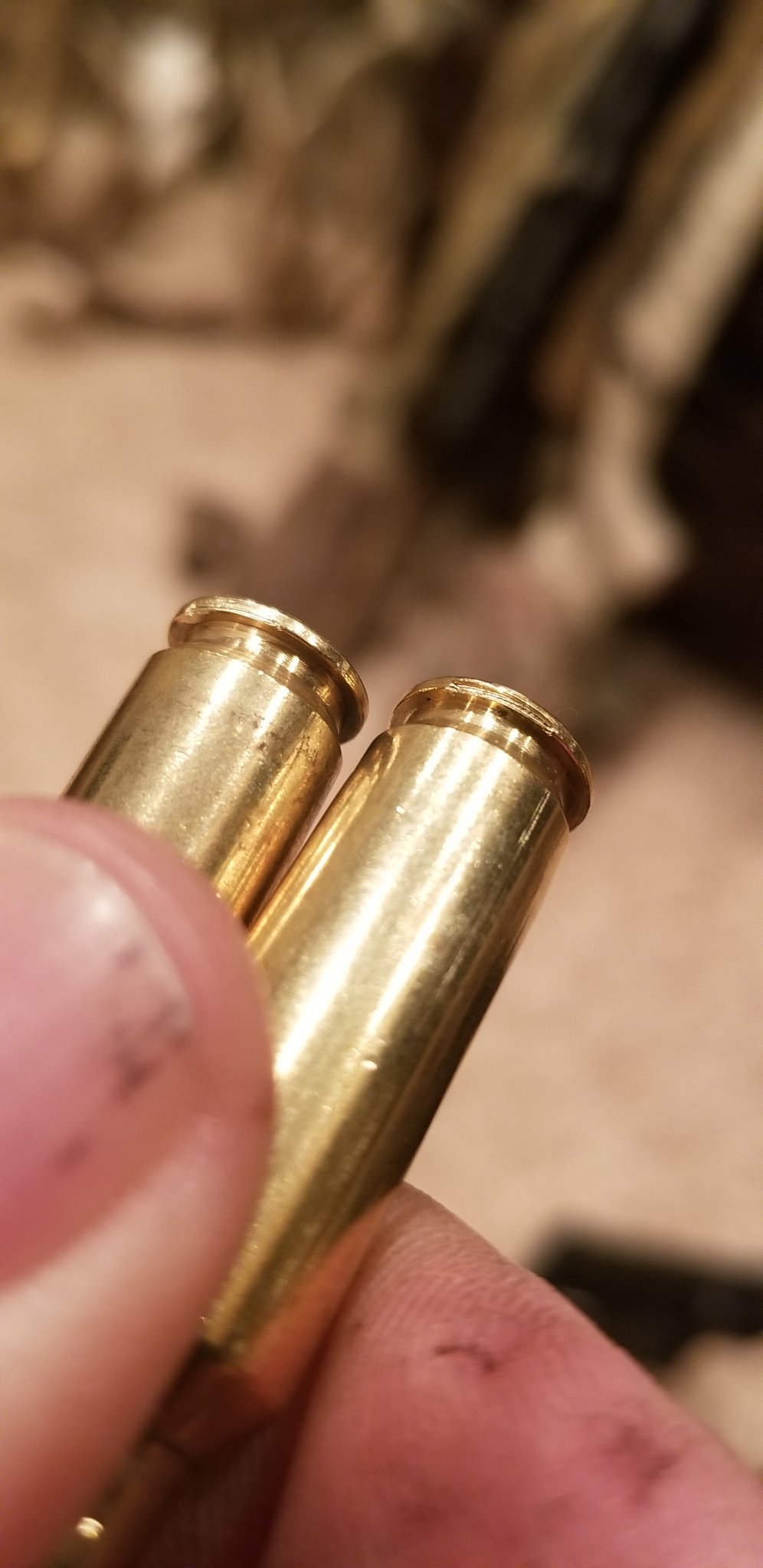

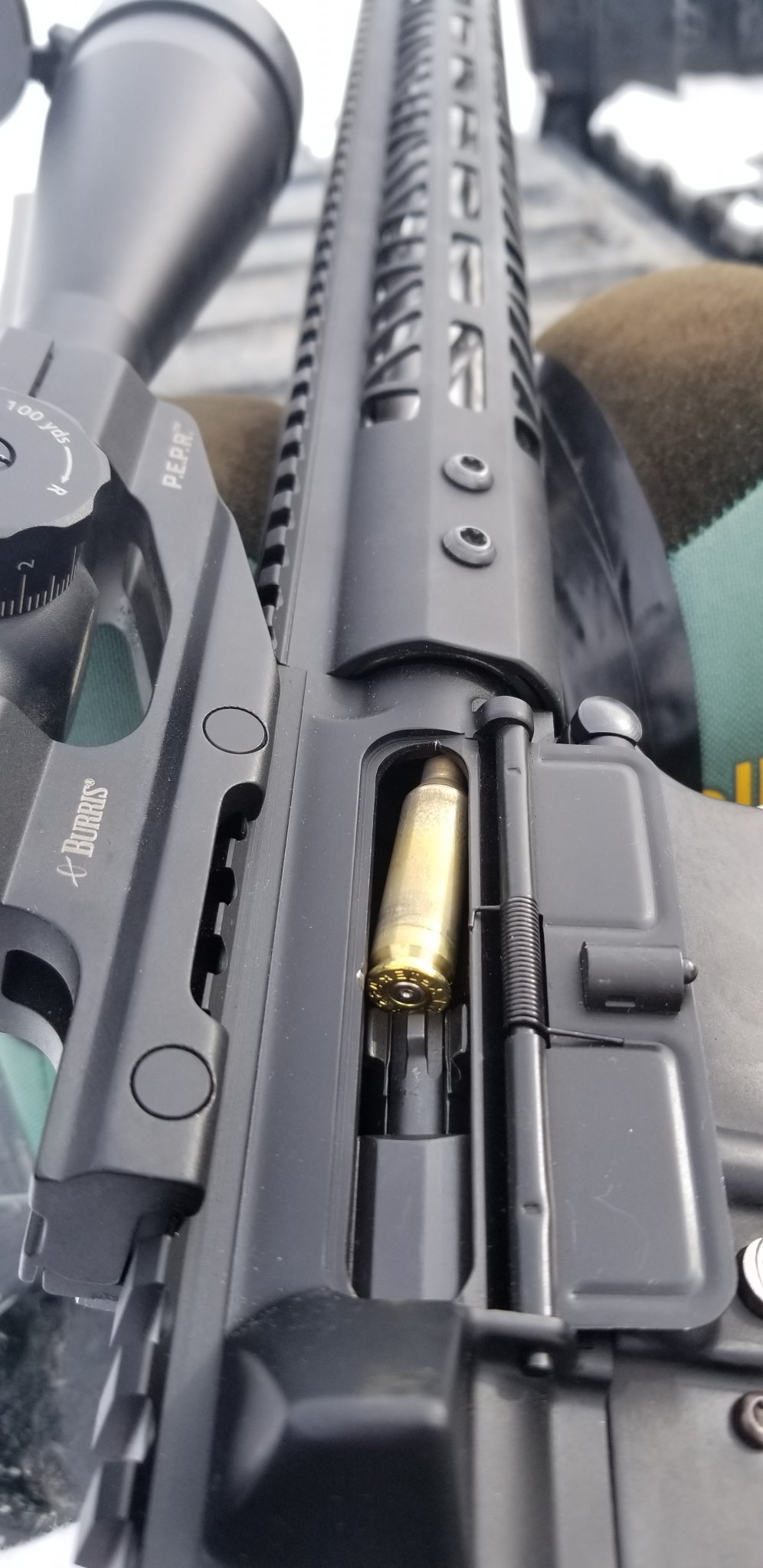

Ok, so I'm fairly new to the whole gas gun thing and not very good at trouble shooting. I'm having fte probably 1 in 10 rounds which is unacceptable to me. they always look the same and there is a mark on the outer rim of the case? Is it a buffer problem? Unlocking too early or is the extractor the issue? Any insight would be great so I know where to start. Maybe it's just the cheap shit I have??

Is that a 224 Valkyrie? Looks like your extractor is grabbing the edge of the rim instead of snapping over the rim. Need to check your ejector and make sure its seating flush with bolt face and no protruding causing the bolt to not be able to snap fully over the rim.
Also check and see if you have an O-Ring under your extractor, wrapped around extractor spring, referred to as a donut. I would disassemble that bolt and check everything and clean everything really good.
Also... any further info on the rifle, any details at all and ammo specs? Headspaced? Anything that may help us help you. Maybe someone has same rifle/components, or has experienced this before with said parts?

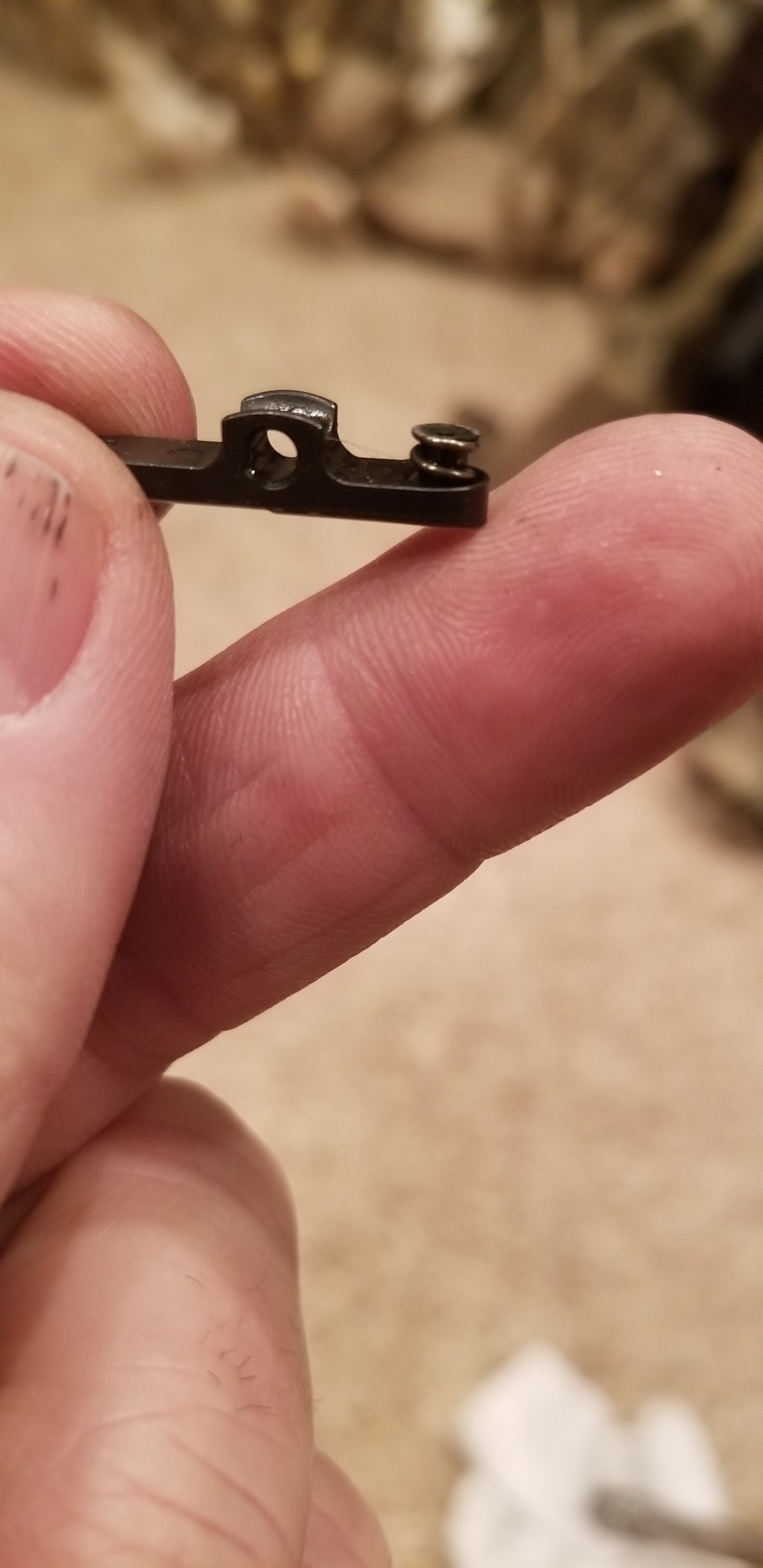

No name, thanks. Ya it's a valkyrie. I only noticed the marks since I started shooting starline brass. ( looking closer there are marks on the federal brass I shot too just more pronounced on the starline.)Its had the fte problem from the get go though. And I dont like it messing up my brass. Accuracy with it kinda surprised me for a cheaper upper. Started out shooting 85 grain rdf's (first pic). Then heard people having issues with them thought maybe that's where my very consistant flyer was coming from? So switched to 80 grain elds and just starting to work with them. It's a bearcreek arsenal. Looking at the extractor comparing it to another bolt I have it doesn't clip as deep around the rim as the other bolt. And is quite a bit looser (i can pretty easily move it with my finger) and no "dougnut" on the spring. As far as headspacing what would that manifest itself as?

I found the test fired brass they sent with the upper and upon closer inspection there are the same marks on them. Sooo? Extractor issue?
tough to diag without being there. But my $0.02 is 3 possibilities. Ejector, it is in the bolt opposite the extractor. Use a little punch, hell tooth pick might work and push it in towards bolt face and make sure it doesn't bottom out before being flush or slightly below bolt face. If it will not go flush or lower then it could stop the bolt and hence the extractor from going over the rim.
Could be an extractor issue.
upper could be under gassed or right on the knife edge (which would still be under gassed). I have seen an AR that was just slightly under gassed that the brass instead of getting flung out of the ejection port would just barely have enough oomph to get the brass to dribble out the port, once in awhile it would not have enough ooomph and the empty brass would just bounce around in the upper. When this happened the bolt didn't have enough rear travel to pick up the next round and would close on the "ejected" brass like in your 1st post 2nd picture.

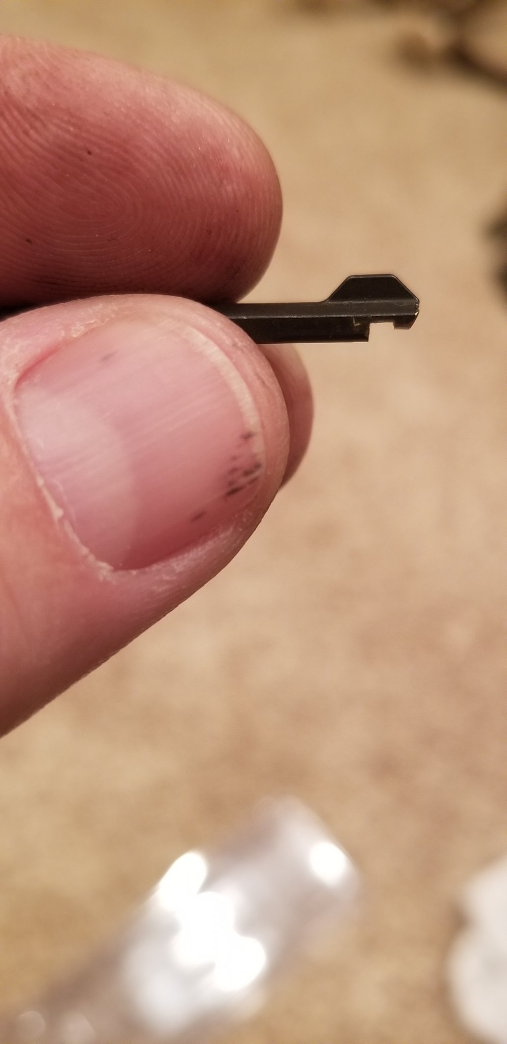

Check the extractor "claw" outside edges... like these in the photo from the internet...
The pointier ones ( less rounded off ) have caused issued for various folks...
