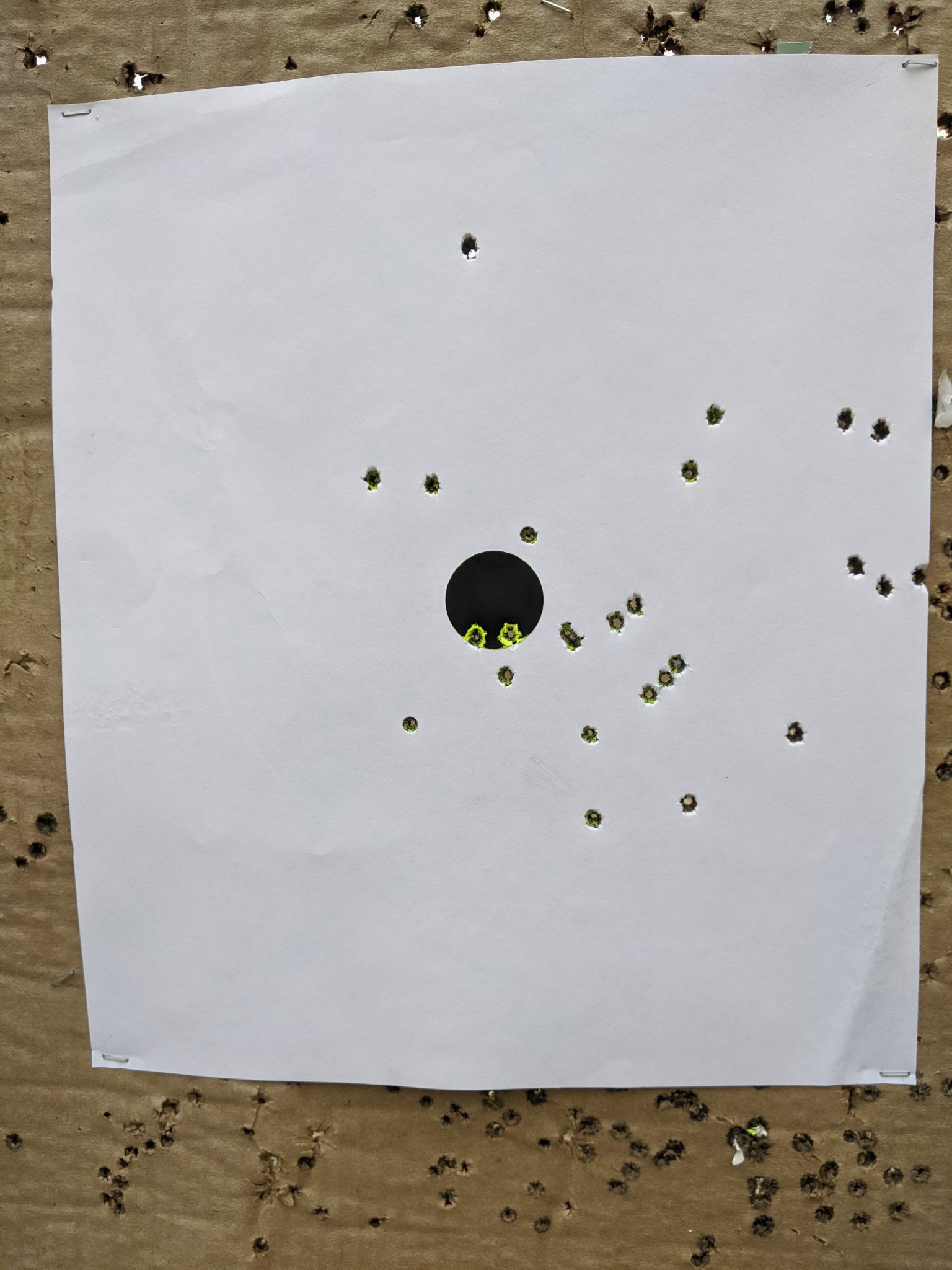

So my buddy just put together a bear creek AR-15 put a Vortex 3-9x40 on it and took it to the range..... This thing was all over the place . Checked the scope mounts,,, Both were tight , nothing loosened up , but the bullet strikes were all over the paper... @ 100, and @50 yds. I'd take 1 or 2 shots and they'd be respectable , the the following shots would be so far off it was crazy . I'm no Chris Kyle but I can dam sure hold a cross hair on a target @ 100 YDS.lol WHY are these impacts all over the place? Anyone???? scope is Brand new to
You'll have to help us help you... Define "all over the place" and "respectable".
Shooting off a rest or offhand?
What kind of ammo?
Did he assemble the upper?
Which Vortex scope?
What kind of scope mount?
Etc... Be specific.

Nothing was loose, was a vortex crossfire 2 3-9x40 reloaded ammo ( which shot perfectly fine in MY Rifle out to 200 yds. Walmart rings, mounted low.

Shooting from rest
Reloaded ammo
Upper came assembled
3-9power
Standard rings. Lol what else you want?

All over the place ( see photo)

Look, it ain't my gun. Lol , it's my buddy's, but even still. The scope isn't loose, it doesn't move it's mounted solid. No way cheap rings are going to do this, unless they're flopping all over the place.

Who is the manufacturer of the lower and upper? Take his scope and rings off. Put your optic on his rifle. See if it improves. Still too many unknown variables that need narrowed down. That is horrific grouping though

Patterns like that might indicate something is not assembled correctly.
Do not shoot until you completely go through this rifle.
Even a smooth bore cheapest barrel in the country should shoot just a little better than this.
Unless it's a short pistol barrel.

Bear creek sucks, but that thing is grouping worse than a 12 gauge. I’m thinking something’s wrong with the gun (prob the barrel). If a typical AR15 barrel doesn’t like a particular load (factory or hand rolled), 3-5 MOA is normal at 100; If it likes it, 1 MOA or better is observed.

Yeah I know. Lol and I did, I switched optics, mine was off by a county mile when placed on his rifle, but it was CONSISTENT, I kept hitting in the same spot even though it was way high. I didn't not however put his on my rifle. That target was at 50yds to. That's HORRIBLE. It did that with both my reloaded 55 gn. And factory 55 gn ammo. Is it possible that his bear Creek upper is just THAT shitty?
[/QUOTE]
Am I reading this right? You put your optic on his rifle and shots were grouping just high? The spraying went away with the optic swap?

I think the scope swap was the answer.
If not, it's time for the armorer's wrench.

Inexpensive rifles CAN shoot. The problem is when they DONT shoot, it's hard to narrow down which inexpensive part of it is causing the issue. Just dont expect 1" groups from $500 AR.
@MAGA4LIFE You need to try and eliminate possibilities one at a time.
Try another scope & ring combo.
Try another lower.
Try another BCG.
Try removing and re-installing the barrel.
If nothing changes I would suspect the barrel.
Try a different barrel. For $100-$200 you can have a match grade barrel.
Reactions: bfoosh006
Full stop. I'd still go through the rifle though...
